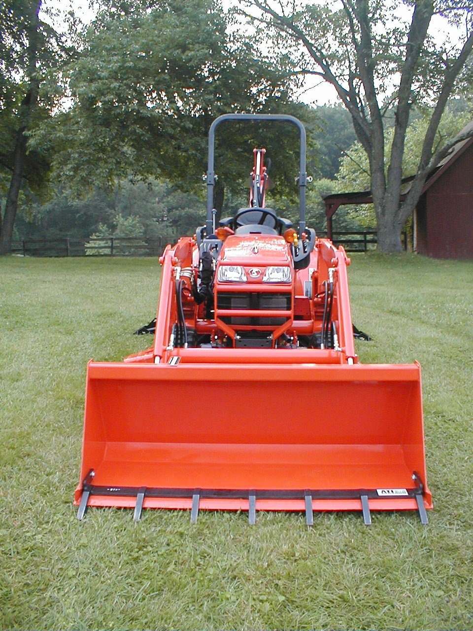

Virtually all toothbars these days are bolt-on. The teeth slip over the cutting edge, and ears at each end bolt thru the sides of the bucket - 2 bolts. < 5 minutes on or off including finding the wrenches. I take mine off for scooping.
Pic of mine when brand new (wow, the whole bucket really was orange once upon a time :laughing:)

Where did you get your toothbar? Do you ever wish it wasn't on (get in the way)?
I have a b3200 and was really surprised at how well I was able to scoop up top soil but I would guess a toothbar would make a big difference.
Thanks.
I think mine is a W.R. Long, cost about $350. I got it at one of the kubota dealerships that keeps tooth bars in stock for these size tractors. I like that it has teeth that are a little bigger than some other brands, but not so big that they look out of place on a small tractor. The slightly larger teeth seem to work great for 'raking' through the soil to get out brush and small roots. It goes on with just two bolts, so it is easy to take on and off, but I like it so much I haven't taken it off since I got it in May. This winter I will probably take it off for snow removal and cleaning the livestock pens however.
