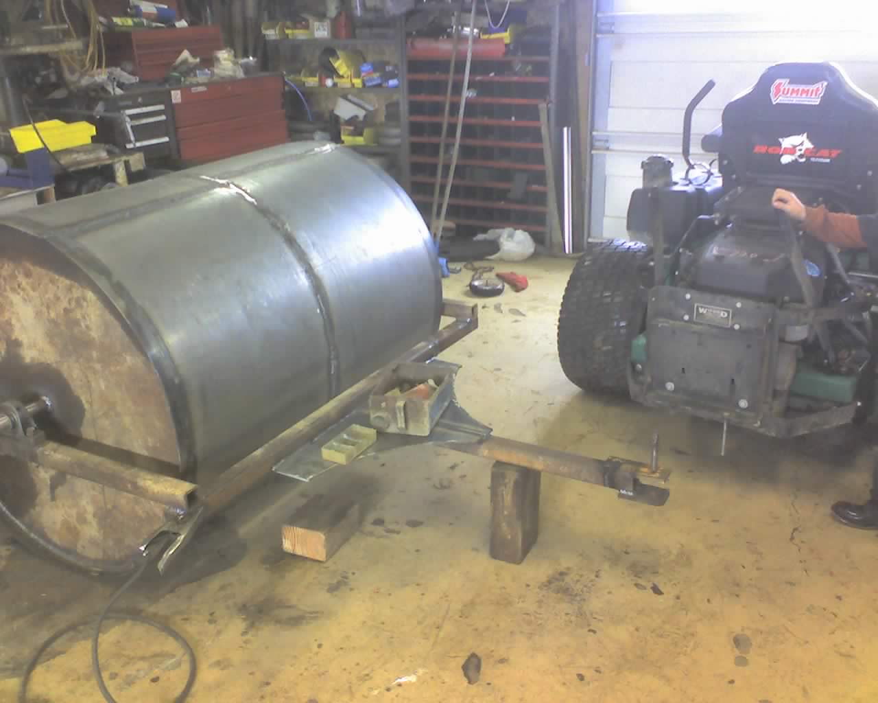

If it is bad enough that you are considering tilling/blading, I woundn't waste money on a lawn roller. They don't do much more than flatten out the mole hills. The biggest rollers that you can buy at tsc or wherever are 24" by 4 foot and just don't weigh enough. Only like 600lbs with water, which may sound like a lot but you are distributing that weight over a large area and don't get much compaction.
This is why we opted to build our own roller. 38" diameter and 4 foot long. Weighs 600lbs dry and can hold another ~1900lbs of water. It really does a good job.
