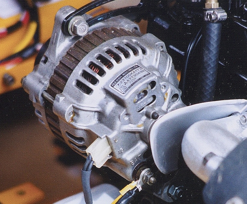

Is there a good online resource and a good brand name to look for? This is a 1986 model 1210 NH. Thank you for any advice…price was crazy I thought at Napa.

If you have any skills buy a one wire delco and make brackets

You need to look at the backside of the current alternator to see if it's a one wire or multiple wires. A one wire alternator has the voltage regulation built into it, whereas a multiple one uses an external voltage regulator. Far as buying from NAPA, you'll do much better at a discount auto parts store and buy a rebuilt one not a new one. Nothing really to go bad inside one except the slip ring brushes which last a very long time and the diode bridge which also lasts a long time.
I would consult your owners manual to ascertain the output of your present one and then buy a comparable one with the correct drive pulley and if necessary fab the brackets to fit.
Just did that with my 02 Kubota M9 open station. Had a 60 amp one wire on it and the front bearing got noisy so I replaced it with a 100 amp unit with again, internal regulation and I paid less than 65 bucks for it from my buddy who owns a rebuilding business. I wanted the additional amperage because I added some night time illumination to it. They will want your old one in exchange however so expect to pay a refundable core charge which you get back when you turn in the old one. In my case, no core charge because it's a friend of mine but he will get my old shot one anyway at some point.

The 1210 alternator is externally regulated. Do yourself a favor, do a little trouble shooting. It could be the regulator as well as anything. If it does turn out to need an alternator, don't start looking for a way to mount a one wire. There are plenty of replacements available in the $100 range.

My Kenbota had a Dynamo with a regulator. I canned all that and went with a 1986 Subaru alternator. It's not much bigger than the dynamo but has about 4-times the output. Just what I needed to run my extra lights.
