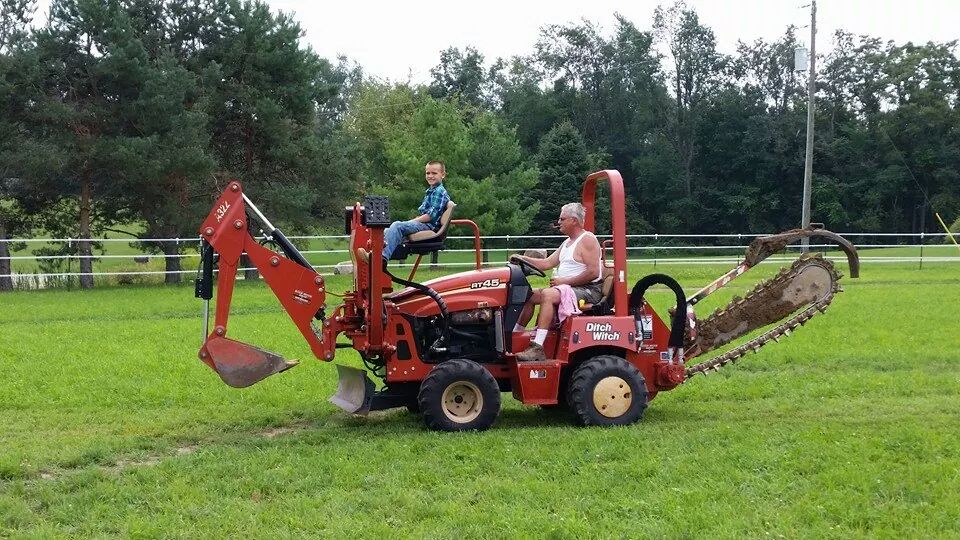

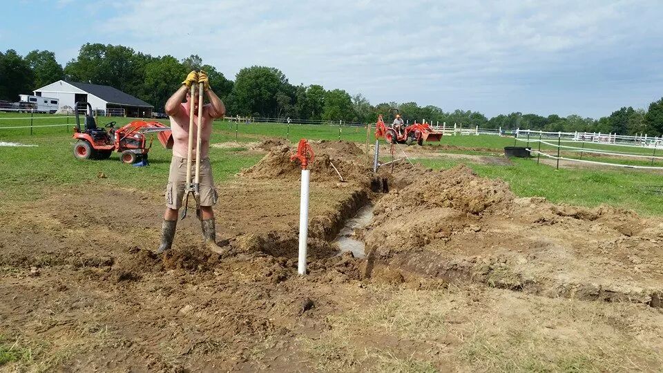

Got it done, well almost done. Everything is backfilled, water is running but electric is not hooked up to any panel.
We ended up renting a RT 40 Ditch witch to open up 48" trenches, about 2000 feet.

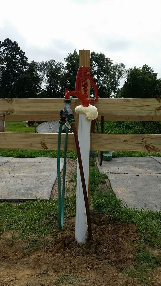

Put down 200 lb rated 1.5" HDPE with huge brass fittings, seven Woods hydrants. We buried conduit and pulled #6 awg wire. I put in one 8 x 8 x 6 PVC box to splice wires and one 6 x 6 x 6 box and several 4 X 4 X 4 boxes. Then transition to #12 wire and regular duplex boxes for gfci outlets.
The wires are brought from the existing barn but not terminated yet. We have talked to local power Co to either bring in another service drop or change the service to 400 amp and split it into two 200 amp distribution panels.

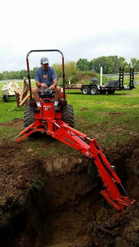

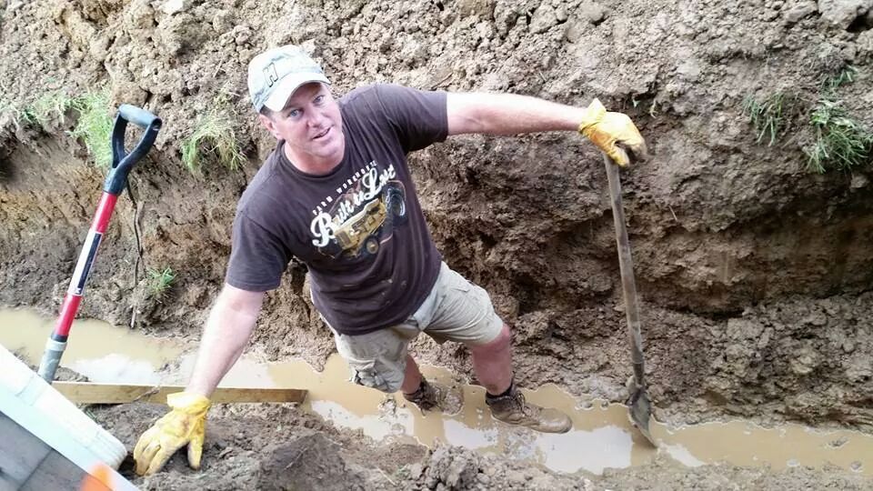

This was a huge project. We had a hard rain after trenching and 2 trenches caved partially before we could get the pipe down. Cleaned the cave ins out with my Kubota B2620 with BH65 backhoe along with some manual post hole digger.

I see everyone got good and muddy. :laughing: Sorry the rain came at the wrong time, it has a habit of doing that.

sounds like you had it pretty easy! *chuckles* *been that done that*
take sanding paper to the pvc pipe you have around the hydrants, and rough it up a little bit (put little scratches in the pipe) and, then give a few shots of spray paint. it going to look a little ugly maybe a few runs of paint here or there. but it should help keep the pvc pipe from breaking / cracking down the line. granted it is only there i am assuming as a barrier from weather and possibly live stock hitting it. but cheap easy insurance that might get you a few more years out of the pvc pipe.
remember they are only frost free hydrants, when they are in the off position. *ughs* it wasn't me i swear, i just remember, learning from another person...

Thanks. Ryan, I'll recommend the paint job to my sil. The PVC around the hydrant was to contain great stuff insulation for some additional margin in cold weather but it does offer some physical protection.
Understood about not leaving the hydrants on.

Be sure those hydrants are actually off too. That big long rod operating a seal 5' away has to be just right or the thing will leak and if it leaks it will freeze. The one I got from Tractor Supply, no doubt China's finest does that and I have to shut it off for the winter.
