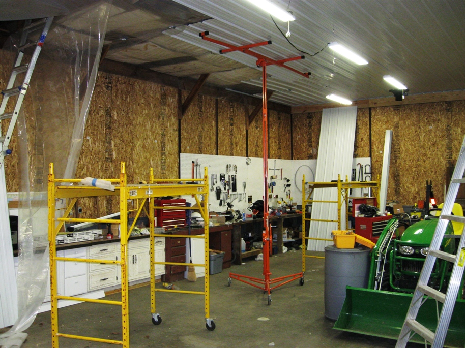

I also put up metal with a drywall lift. My building is 48 feet long and I ordered the metal 12 ft 4 inches long which gave me plenty of overlap (trusses on 4 foot centers). I went with about 12 feet because I was working alone and have a 12 foot ceiling. Anything longer would have been difficult to handle. I couldn't find a high lift to borrow (a standard lift will not go up to 12 feet) so I bought a new one on Ebay for less than $200. I'm going to sell it one of these days when I get around to it. (Renting would have quickly cost more than buying because I'm slow.) I also have two sets of used bakers scaffold. These are almost essential because you don't want to have to work off ladders all the time. You may be able to see in the picture that I added a vapor barrier and then I blew in cellulose insulation. The area above the ceiling is well vented with a continuous ridge vent and a couple of wall vents in the end walls above the ceiling. I put in the wiring above the ceiling and cut electrical boxes into the ceiling metal. That was a mistake. As M E Cook said, putting the boxes on the surface (and running surface mount conduit) would have been a better idea.

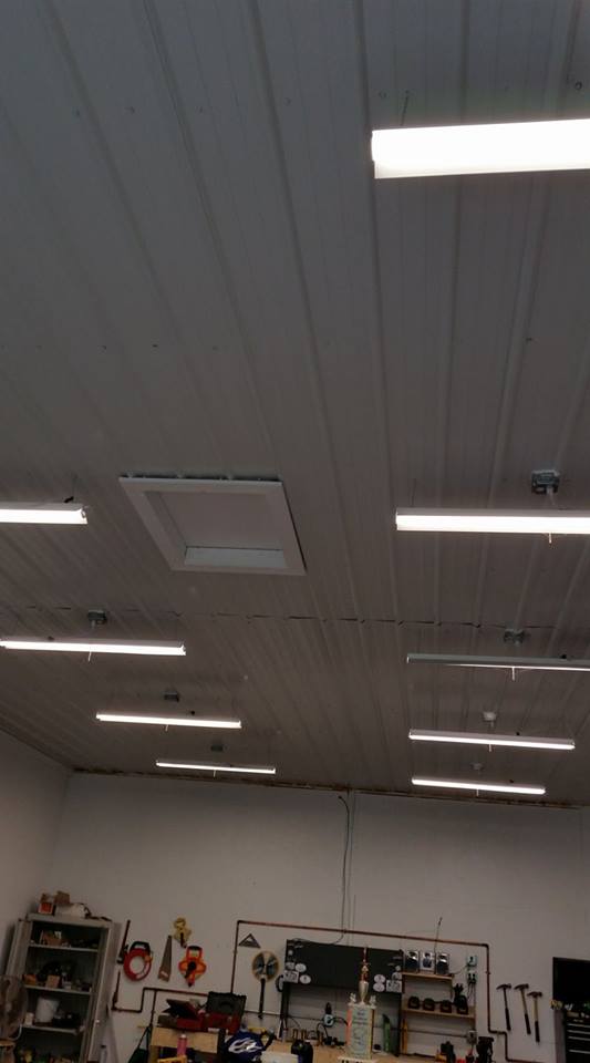

yea the lift was not tall enough my shop is 36' long I bought 19' panels trusses on 3' centers and made a frame out of lumber to sit oh lift . I had to use a ladder I was by myself to made it slower but well worth the effort did the ceiling in about 10 hours20881837_270158010168090_4449225099812454887_n.jpg

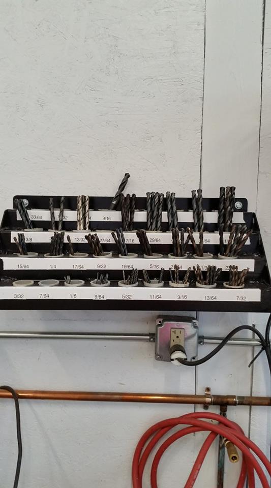

20800058_270157813501443_8027228425336698255_n.jpgnot very good pic of ceiling but the drill bit holder I built out of 2" sq tubing holds 36 different sizes keeps them right next to drill press
