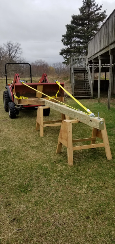

So I am building a deer blind that will be sitting on 12' posts. I am building the blind at the house and will carry into the back property, attach the posts and stand it up using my L2502. Looking for suggestions on the safest way of doing this. Can't get a truck in the area, only my tractor and ATV. I think the max lift height on my loader is 8' to the pins so with the forks tilted up, I should be able to reach 12' to push it up. I was thinking of tying a rope to it so that as it's pushed up, it can't fall backwards from the momentum. Any thoughts?

Could you rig something like this for your FEL bucket?
You could also clamp a 4X4 to your fork tines to get some added height.

With a couple of snatch blocks, you could use the tractor for pulling it up and control at the same time. It just requires some longer rope. You would pull through the rear block while the front rope goes through other block for control.

If you have the legs properly braced, then get it off the trailer, laying flat, it should be able to be pulled upright with a rope/strap without issue. Just kinda block the bottom of the "lower" legs and pull it into standing position. If that's a bit unlevel/plumb, you can always lift by wrapping a rope/strap on the legs once standing and lift one side, shovel to level, and lower until happy. If it's not stable enough to stand from laying to standing, and X bracers from about 18" up to the top, using 2x4x14 PT (or 2x4x16)
