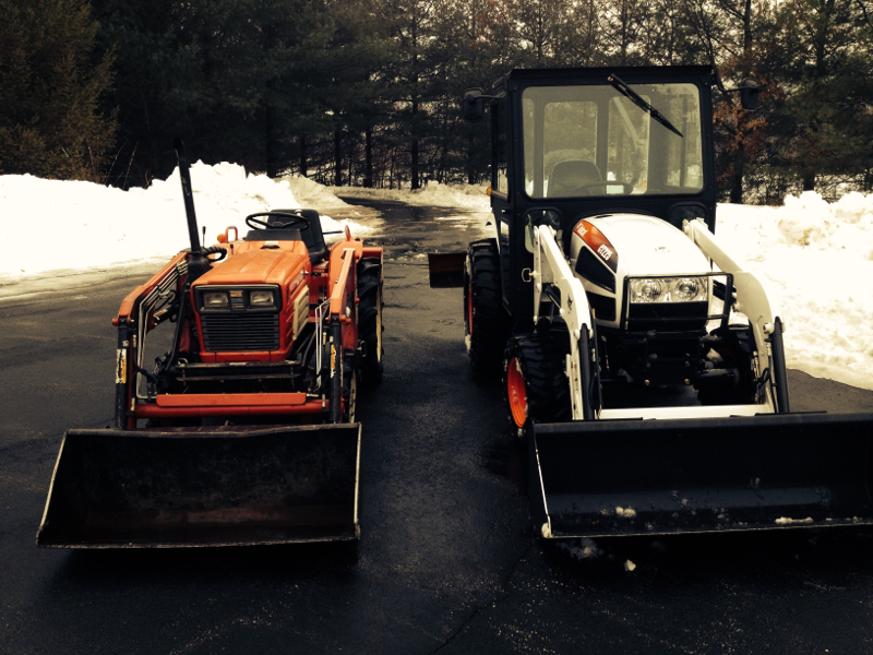

Here is a picture of the 1702 next to the CT 225. The people that mentioned the cab are spot on. I had never used a cab beforeand did not realize how useful they can be. Not sure what climate you have but you can get cabs with heat and AC plus they offer bug protection. My property is a little smaller than yours so this tractor fits me perfect and would probably get you by if it's all your budget will allow. But for the size of acreage you're mentioning I think you're on the right track for the 45 to 55 hp range. But do yourself a favor get the factory cab with the heat and AC right off the bat.
The ct225/ck27 is a nice tractor. But, no offense, it is much too small to do the work he is talking about in this thread. For safety reasons alone, that tractor should not be moving 1000 pound bales. And forget about wet or larger bales.
I didn't think there would need to be clarification on this, but when I mentioned quick detach loader, I was speaking about the entire loader assembly being easy and quick to detach and reattach to the tractor. Skid steer quick attach plates are, in my opinion, necessities and a given these days. I can't imagine having a tractor without a skid steer quick attach mounting plate.
