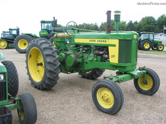

If older is in the running then perhaps one like this could be considered.:D
   / Need tractor for vegetable farm #36
Too wide....They will only "narrow down" to 60-something inches track width. Otherwise, their slow speed ability takes a back seat to nothing else.
And they'll probably outlast anything from the modern era............
   / Need tractor for vegetable farm #37
spendy though.. 720's and 730's around here are one of the more/most expensive usable antiques..err.. classic tractors.. almost cheaper to buy a new base model SCUT ;) they must grind up money to get the pigment for the green paint!
