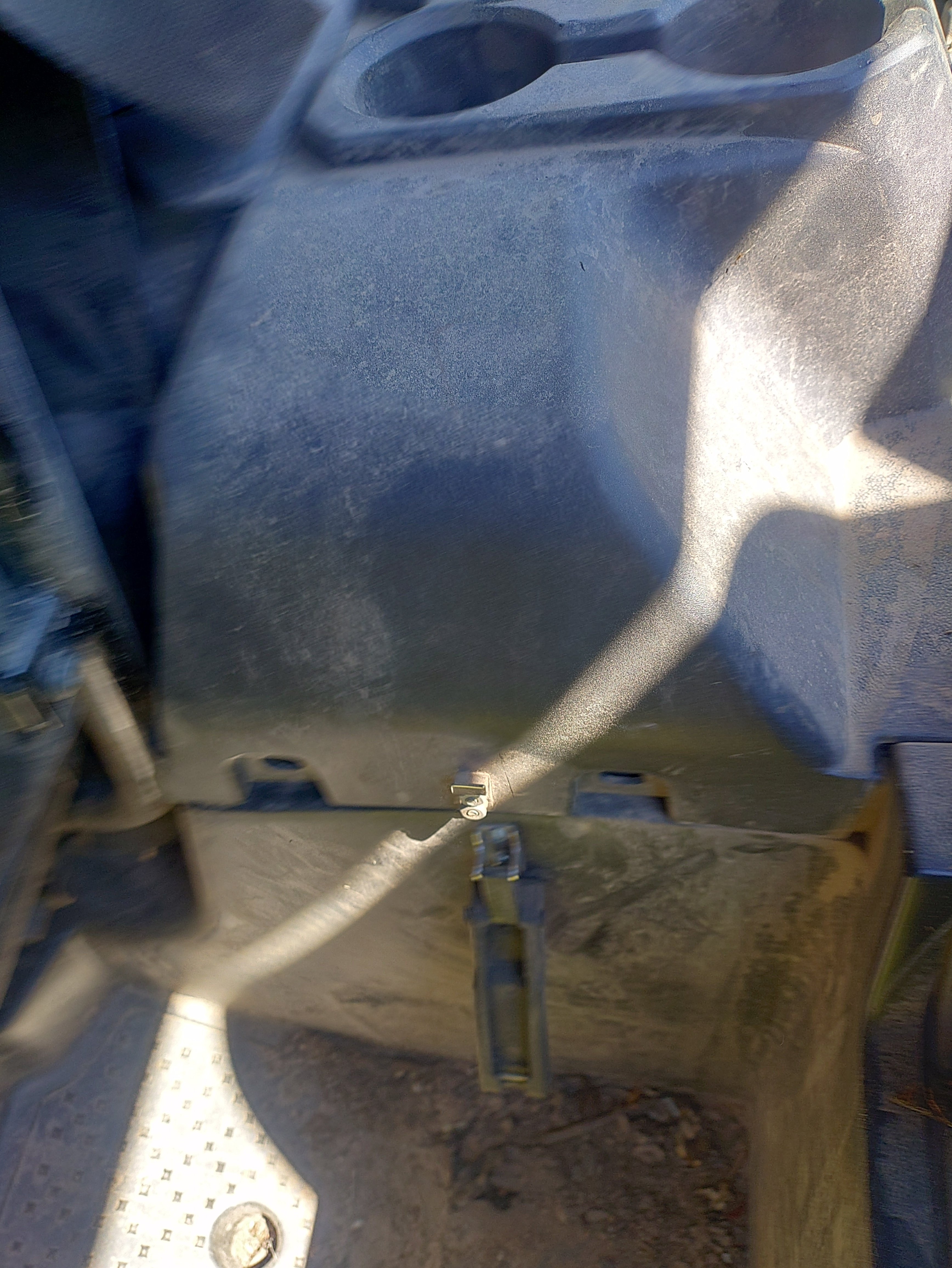

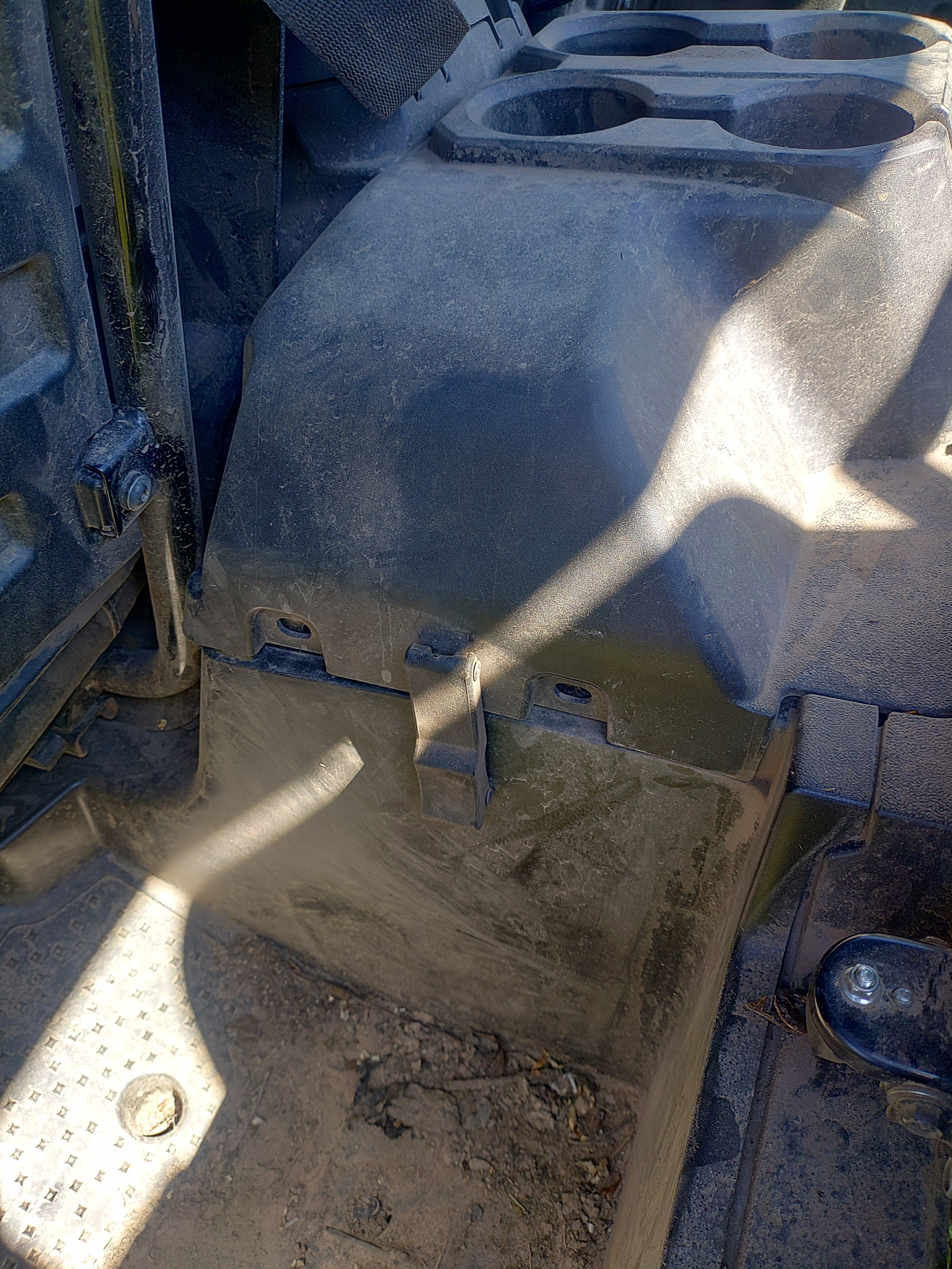

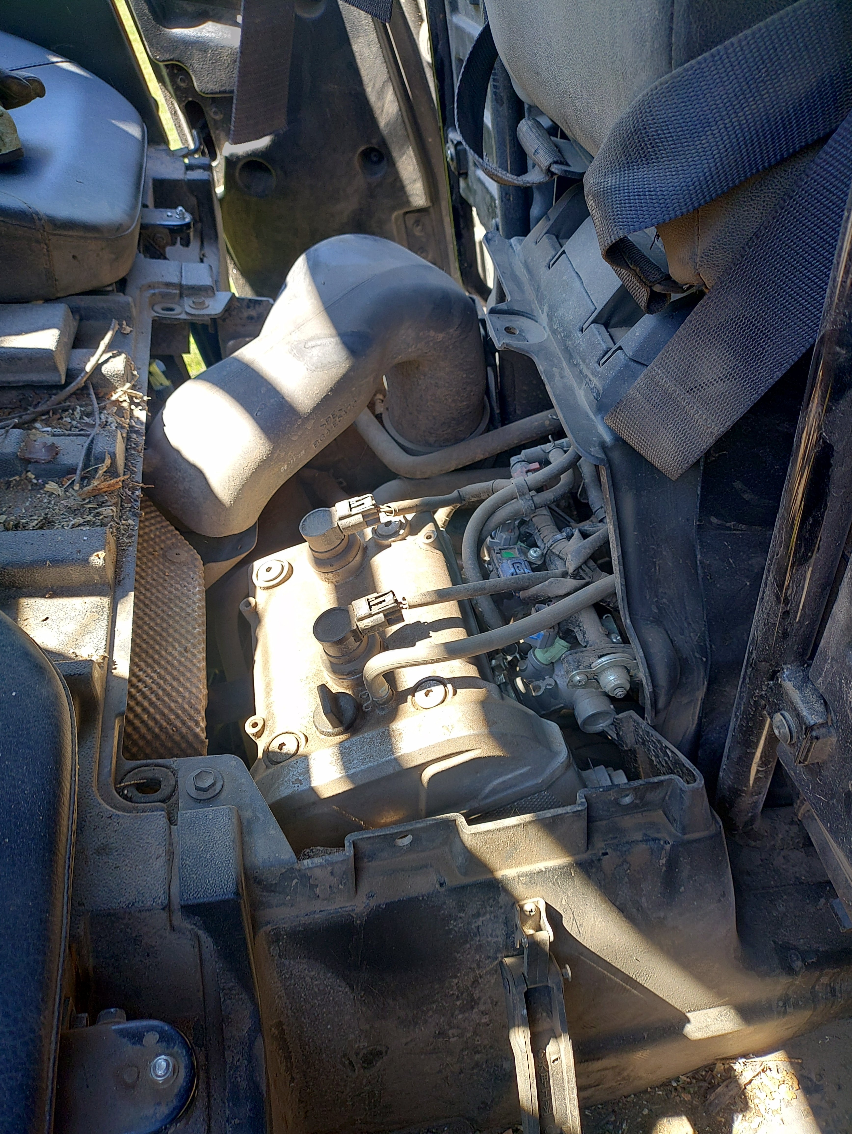

Unsure of Yamaha vikings over use of plastic fasteners. But some of my for only complaints of Yamaha Motorsports for me anyway the darn plastic push rivets were quickly disposed of after the realization I had to try and pop 4-8 without over damaging them or the plastic covers they were fastening especially in sub zero temps or dirt and mud, previously had to attempt this feat with usually four letter word outcomes every time I needed or wanted to check the oil on my wolverine...so I use rubber strap type fasteners bought a bunch on scamazon fairly inexpensive compared to other sxs accessories I've indulged in, it works great for me anyway. I also use them on other things, cuz I'm anti plastic fasteners. Congrats on the Viking btw. My Yamahas have never mechanically let me down or stranded. Besides there plastic fasteners lol.

Everyone should have a bottle of them which costs very little. I drop them and can't find them again!

Or use alternative methods to fasten plastic. Anyways if I used my sxs in a perfect world replacing those plastic fasteners and having spares everywhere would be my first choice, until I did away with them completely which actually works way better than the manufacturer, who was problaby influenced by penny pinching bean counters.

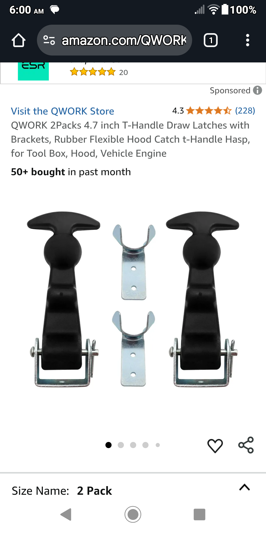

Any chance you can provide a link to what you are talking about?

Will a screenshot work? I use similar to these on a few things I own instead of plastic fasteners. Higher vibration areas use smaller machine bolts with slightly oversized washers and nyloc nuts to fasten latches and hasps.

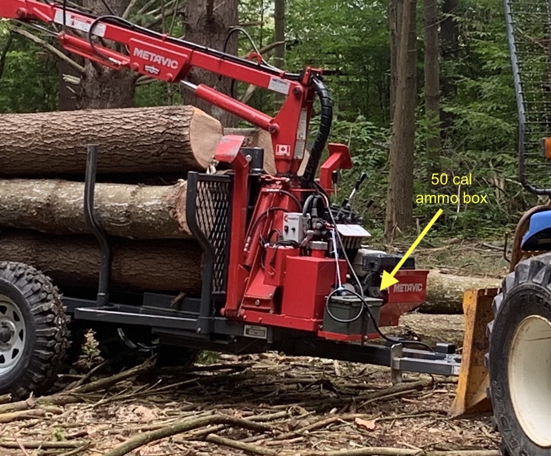

That helped. Searching Amazon for "t handle rubber hood catch" turned up a number of hits.
It turns out I already have a couple of them in use: When I had my log forwarding trailer in to the local welder for some repairs, I asked him for ideas to add a small tool box. I had a 50 cal ammo can for the box. He added a tray to hold it with two of those rubber T-handle straps hold the ammo can to the tray. I could have just bolted it down, but his idea made it easily removable. It's hard to see in the picture, which was taken a while ago just to show someone with a similar trailer where I mounted it, but you can see the black strap running down the side of the box. It's been on their for 4 years, stored outside. The ammo can is little worse for the wear, but the straps are still holing up well.

Probably borrow your idea for easily to remove tool boxes, great idea. Those rubber latches are handy and my go to when I need a cover to come off easily, now Mounting tool boxes on certain things. 👍
