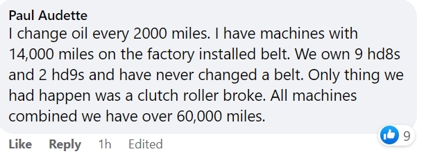

I worry about the CVT belts on these units. I work for a big farmer in my area, and I am always changing CVT belts. Maybe because the guys are driving at low speeds in high range? But then I see users here that have excellent belt life. And the other thing about CVT belts is their jerky nature when you first start to move. Are the new units much better about this?

I'm curious what brand you see eating belts. I've seen more than a few Polaris belts being changed on trails but the other manufacturers seem to have it figured out. Yamaha has a 10 year belt warranty and I don't recall seeing anyone having a belt failure on the forums I've followed in the past.

I bought my first ranger in 2007 and had a second one in 2016, and have yet to put a belt on either of them.
I may not beat them up as badly as other people, but I travel trails through my woods and street travel commonly, and never had a single issue with either of them, the only reason I got the new one was to get power steering because manual steering sucks on the trails

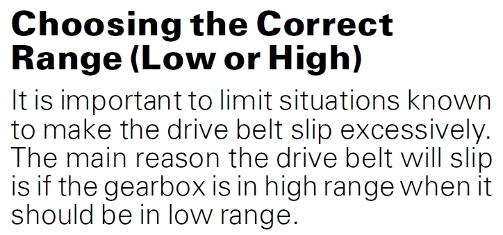

That's exactly why you are changing belts! Driving at low speeds in high range. The owner's manual for my Can-am Defender very specifically states that if the machine is driven below 15 mph then low range is to be used, else the belt will be destroying itself.
I have 5000 miles on my Can-am and the original belt but then I make sure I'm in low range when just putting around the place - especially if pulling a trailer. Other people on the Can-am forums report getting much higher mileage out of their drive belts.
But people dislike hearing the engine running at higher rpms in low range so they just leave it in high. Then someone gets to change out the belt!
