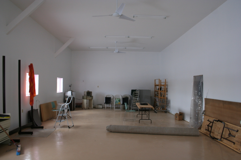

Here are a few pictures taken back in January 2004 when I was insulating my shop. In order to pass inspection the 6mil vapour barrier had to be sealed around all windows, electrical outlets, floor and on all seams. The inspector insisted on a well sealed barrier. I drywalled right over the vapour barrier. I usually heat my shop 5 days per week. Moisture has never been a problem with 3 or four of us working for 8 to 10 hours per day 5 days per week.
For the past few winters I used a pair of 4800 watt electric shop heaters and a little solar to bring the shop up to a comfy 68-70 degrees then ran a single heater as required. This year I installed a corn/pellet stove and have used an average 20 bushels per month to heat my shop. My shop is 40 x 60 x 14 and divided in two. The side I work in is approx 1600 sq ft, heated to around 70 and the other 800 sq ft stays between 58 and 62 degrees.

Luremaker--That is a fine looking shop and the photos very helpful. Thank you.
