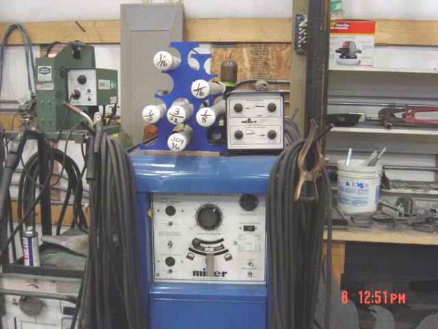

Can't say I've ever used one, seen lots of them tho. I have a 1980s Miller Gold Star, I think pretty much on the same lines as your new machine. It is surprising how well it runs 7018. I had some work done to it about 10 years ago, tech at the repair center suggested I get rid of it, said they weren't worth anything as a Tig welder, or stick welder. I told him when he got a chance to run some 7018 and tell me what he thought. He too was impressed!:laughing:
Did you get a torch, and foot pedal with it?

Good as it gets for Transformer Stick. Does 3/8" Aluminum on Tig. It still uses the old technology Pure Tungsten with a ball on the end but hey, Thats how they did it for ever until a few years ago. Enjoy.
