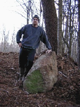

>> How big are your rocks on average? Check out the picture of me and a rock that I moved with my 7610 - it's @ twice as wide - you're looking at it *end on* (Probably measures 4' x 2.5' x 2' - weighs @ 1000#??). I don't know if I can lift it (don't have enough rear ballast for sure) - but I was able to push it around without too much diffficulty. Any bigger - and you need larger equipment...

That's a big rock, Dan!
