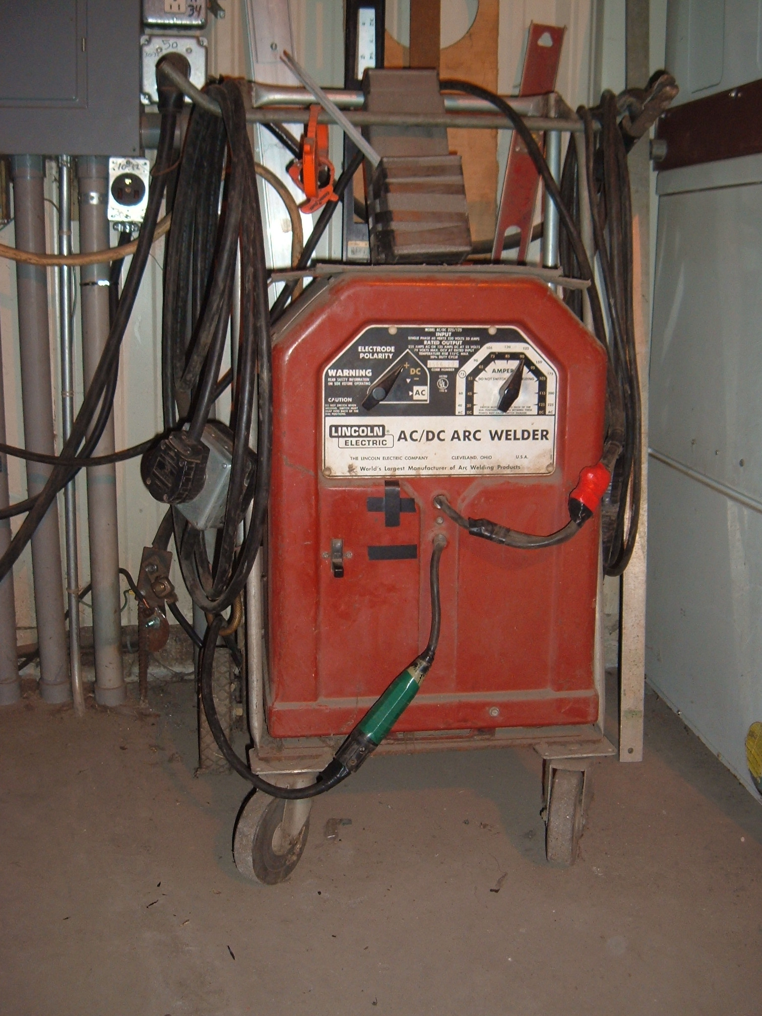

Its almost hard to hear myself say been at it 40+ years, had this DC north of 35 years which replaced a 180AC which worked well as it was but have bought a few new machines since and really back where I started using it and a small feeder I had since 92 for 98% of the work. These are really so good they are the go too if I have a choice.
The trade I might make with this is a Stickmate with infinate for smaller sticks and light material where a coup[le A means a lot or really in todays world would be a dvi inverter, a little one will do what this will,,, but sure how well it would tolerate a welders handful of 1/8 in a pull welding out a truck bed but the lunchbox will run them
