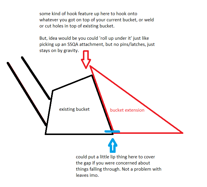

I guess I wish I had an enormous bucket for light loads, and someplace to store it,
Well, something you might consider would be a 'hang-on' bucket extension, since it wouldn't be as big as a whole bucket and you wouldn't necessarily need to use any hand strength to attach it.
Course, with the 10lb limit you'd still have to borrow some help to fabricate it. But it's basically 3 sheets of metal and some doodads and a piece of bar/pipe at the top for the hook feature you have to invent. :)
It would support leaves even with a very thin floor, and since you never push it into anything it doesn't need a cutting edge or particularly smooth bottom, so you could reinforce the bottom with anything.. a piece of pipe, angle iron, T-post.. whatever. It would still hold up hundreds and hundreds of lbs.
