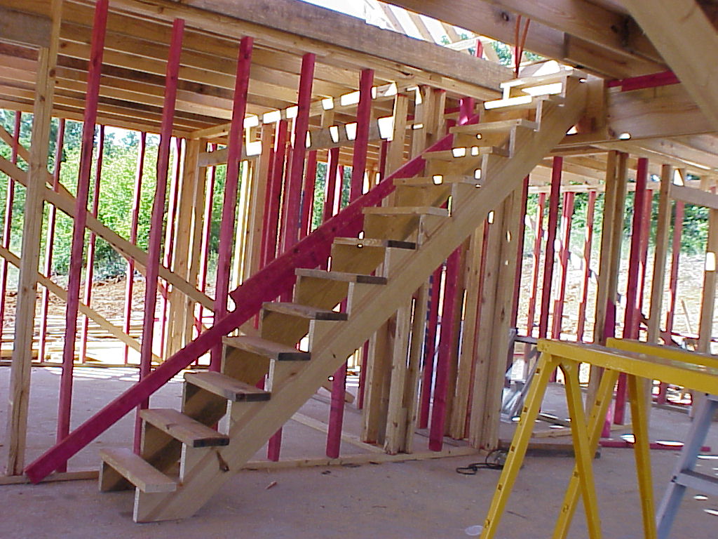

I'm reading this - and is the sugggestion here that 2 - 2x10's can carry a 14' span of roof?
What about snow?
The Texas Gulf coast doesn't get that much snow. :) In the weekend place I built I have 2x8's spanning 14 and 12 feet with a 2 story above, no bounce...they are on 16" centers. There is a little overlap in the center that may help some. They are also SYP which makes a big difference.
Rob

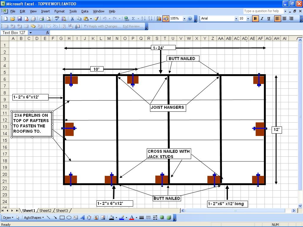

I apoligize for using wrong terms between joists, headers, trusses, girts, perlins, etc. I screw them up regularly :( The reason I thought a single 2x12 24 foot long would be adequate is the open span is only 14' and the weight the 14' span would be supporting is the rafters and the roofing material which is standard gauge metal sheeting used on metal shops.. I am not sure what gauge it is.
Eddie sorry for the confusion wished I could describe what I have in mind better. If I doubled the header and set the rafter on top I do not know how to cover this area. I am trying to secure the rafters with joist hangers inside the frame work instead of on top... clear as mud? :)
I really appreciate you guys having patience with me.. My carpentry skills are second only to my brain surgery skills :D
If you understand what I am proposing and still think its a poor idea, I will double the 14' span of the "header" and place the "rafters" on top..
Here is a crude drawing of the overhead veiw of the framing of the roof.. Click on the "X" on the lower R/H corner to enlarge picture..

No need to apologize! I am not an experienced builder myself and I can imagine that pros like Eddie have "fun" reading my long-winded posts that contain inaccurate terms. :D I believe that Eddie's attention to details such as terminology is due to his wanting to give the best advise/suggestions possible and he can do that a lot better if he is clear on which portion of the build that you are discussing. Heck, as far as that goes, I should be apologizing for my looong post that I put up last night! :D
Eddie is certainly the one that I'd listen to over my suggestions, but I still think that putting the rafters on top of the header is the best way to go. I would also consider using 2' centers for your rafters as opposed to the 6' centers that your drawing shows.
I am not sure what you mean when you say that "If I doubled the header and set the rafter on top I do not know how to cover this area."
If by "cover" you mean you are not sure how to put it together (construct it), then my response would be that it would be even easier if you did it this way. Use at least 14' rafters and you will have a 1' overhang on each side of your 12' lean-to (I would use 16' rafters and give myself a 2' overhang on each side). This would give your implements more protection from the elements as rain would be less likely to get at them. It would also make it easier to construct as your rafters would rest on top of the header and you wouldn't have to worry about holding them up while you were toe-nailing them into the header - they would simply rest on top of the header.
If "cover" means leaving less holes for the rain to get into, then the only extra thing that you would have to do is cut some short pieces of 2x6 (assuming 2x6 rafters) and put them in between the rafters to cover the gap in between them.
