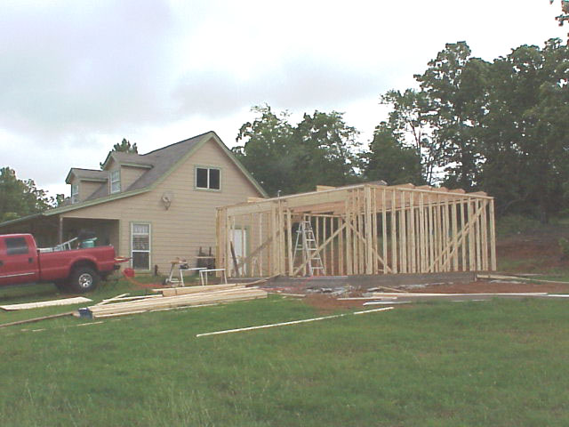

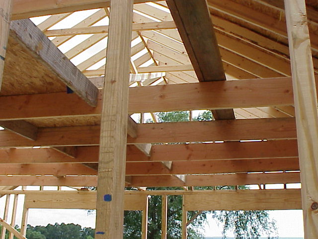

I used 24' 2x8's in my garage. Only 6 across the 20' depth as they are there only to hold the walls from going in or out. I don't have much stuff in the attic either.
I recall them still being priced pretty much by the BF. But you won't usually find them in the box store. All of the lumber I used for the house and garage was bought through and delivered by a lumber yard. The only way to go!!
