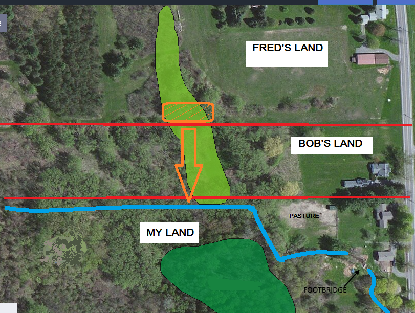

I caught Bob yesterday as he was raking leaves and asked him if Fred ever spoke to him about a plan to drain standing water from his (Fred's) land across Bob's land and into the creek that traverses my property. Bob said Fred approached him months ago and ran the idea by him. At that time Bob never committed either way to allowing excavation on his property. In a nutshell, I told Bob that the heavy equipment operator may someday ask for permission to work on his land and that I wouldn't be happy about any plan to divert water into a creek that already overflows its banks (onto my primary horse pasture and 50 feet from my septic drain field) during heavy rainfall. I also alerted Bob to the fact that the area in question, both his property and Fred's, is deemed wetland by US Fish & Wildlife and can be readily identified on the Wetlands Inventory map. Bob was surprised to learn of the wetland designation. He got the message. I will also talk to Fred when I see him.
The attached map is taken directly from US Fish & Wildlife Wetland Inventory. The wetland areas are shaded green. The creek, which I drew, is blue and the area that Fred hopes to drain is encircled in orange (stripes).
Bob's wife had the best solution. She said Fred needs a pair of taller rain boots.
Bob's wife had the best solution. She said Fred needs a pair taller rain boots.

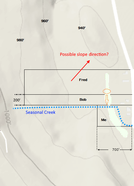

Do you have a topographical map of the area? That would be interesting to see.

Earlier I indicated that 400' separate these two points and that "Fred's land is *certainly* upland from mine, the elevation difference is just a few feet"
Attached is a topo map, edited to show pertinent landmarks. Both Fred's "wet spot" (see small red circle on map) and the point where the creek comes closest to the wet spot fall within the same 2 contour lines (940' - 960'). BTW, these point are just over 200' apart, not 400'. Also, I am not certain that Fred's wetland is upland from mine. The wet area could easily be on same plane if not slightly lower than the creek.
