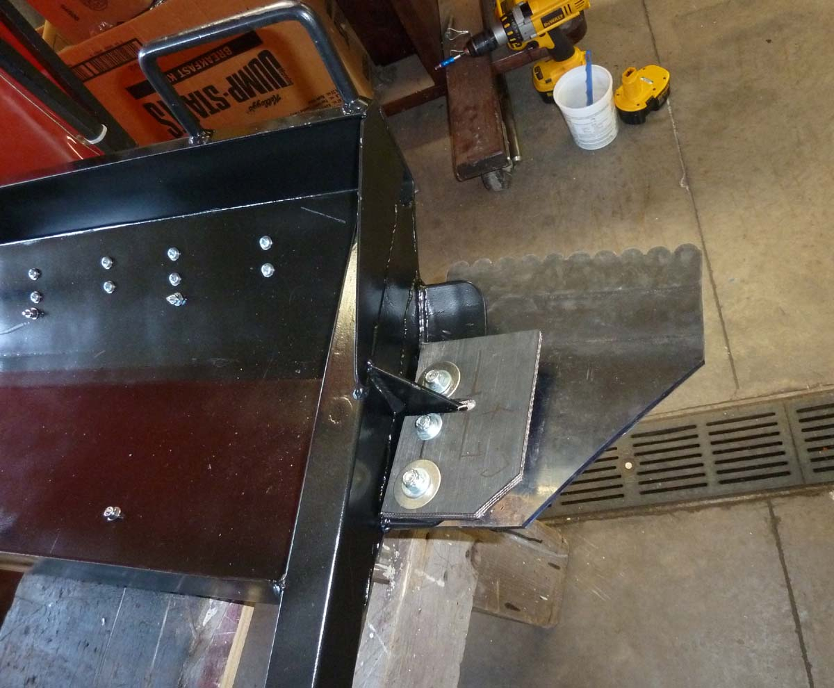

Guys, I'm home working on these neoprene wings and here is some pics. I tired some .250 material and it started to tear asap so I'm doubling it up and hoped to glue the top and bottom layers together. This photo is not actually the the wings I'm working on but 70% the same. Good news is tried to again tear the silicon adhesive test strips apart and couldn't. Maybe it is good enough? I will later add better pics.

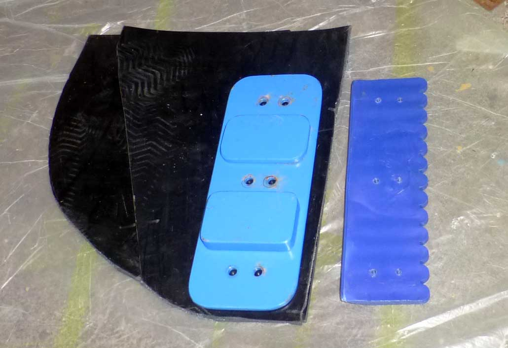

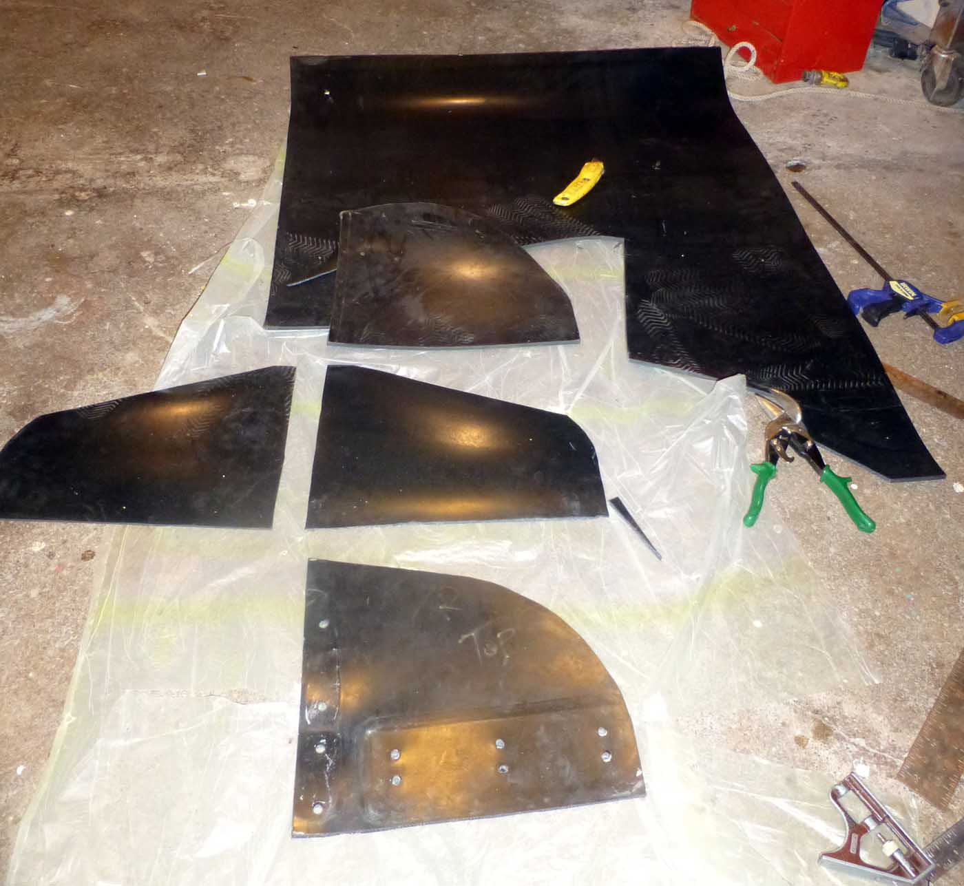

More pics. In the below one, the old version is at bottom, then 2 just cut new ones to replace it.
Here is what it will look like. Who stood on it!!! The weight is seen just where it goes and it will be screwed into the blue plastic at its right.

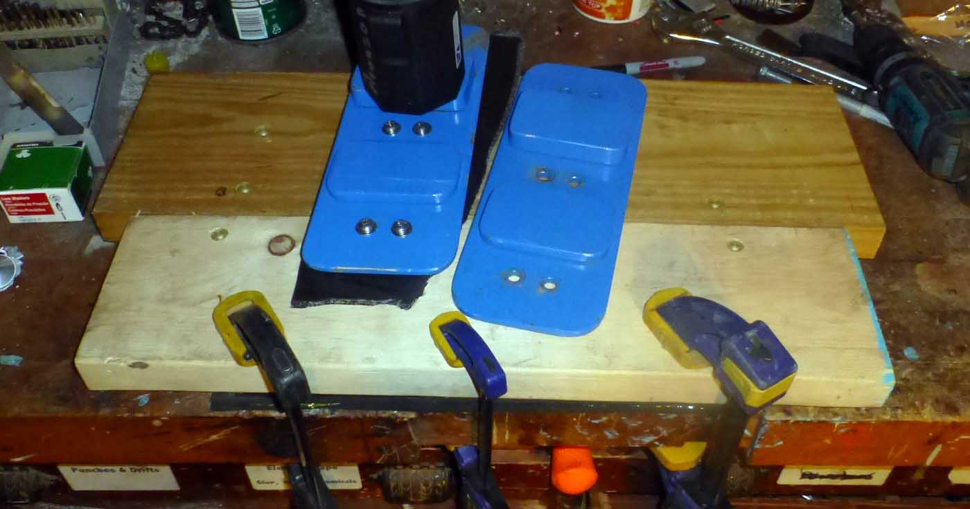

The glue used. Took a whole tube.
Clamp setup.
