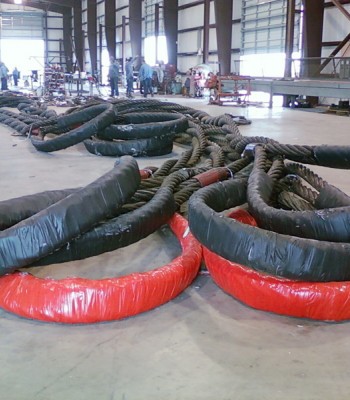

I'd like to meet the guys who spliced this eye! I sure wouldn't make them mad! :laughing:

No doubt! The biggest cable we splice and press is 3-1/2", usually atleast 4 guys on an eye to splice it.. Check these braids out, 2" wire rope, braided

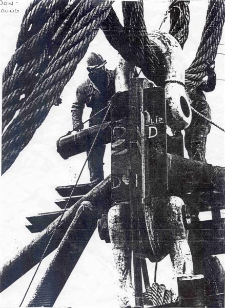

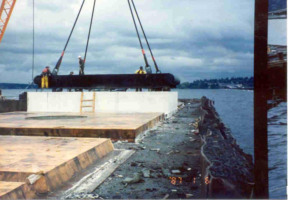

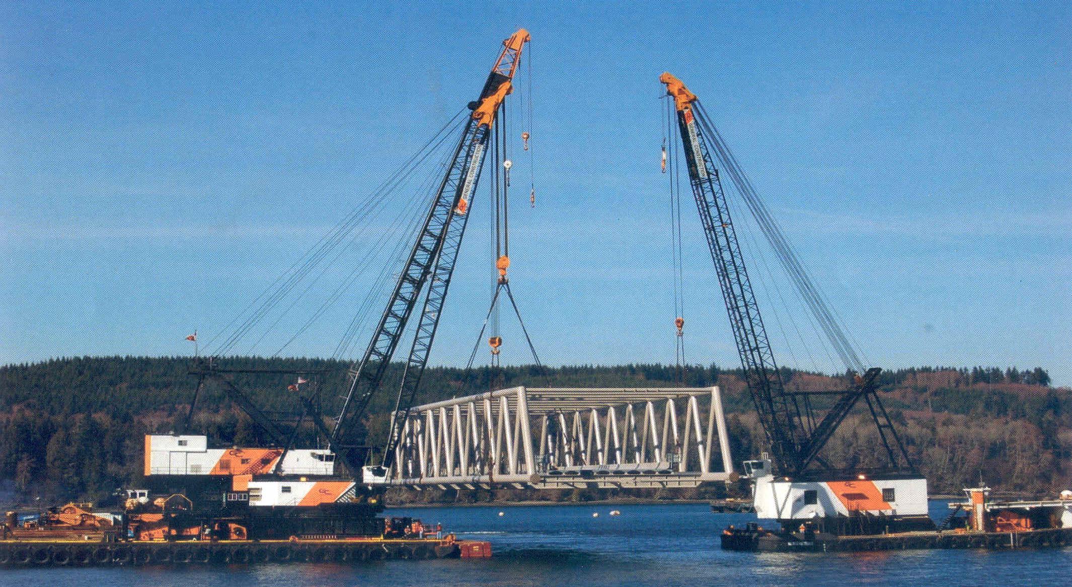

Here is some 4-inch, we used for 300-ton picks.
   / Never saddle a dead horse #20
Now those are shackles.Nice to see a big pick rigged. What were they lifting? As Paul said,'the rest of the story".
