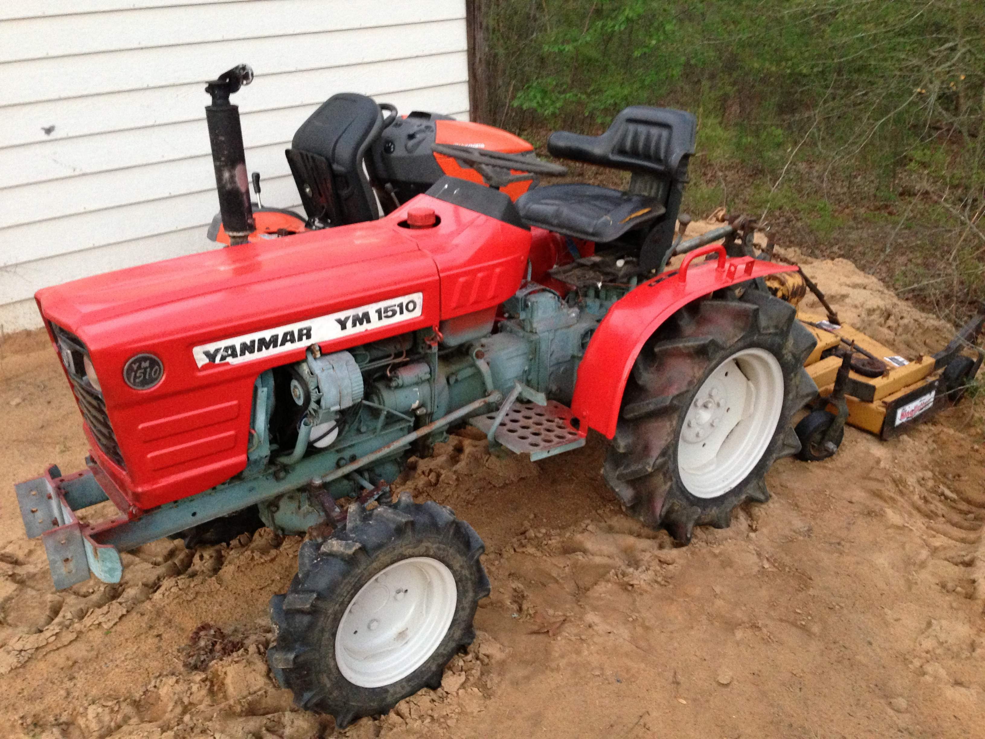

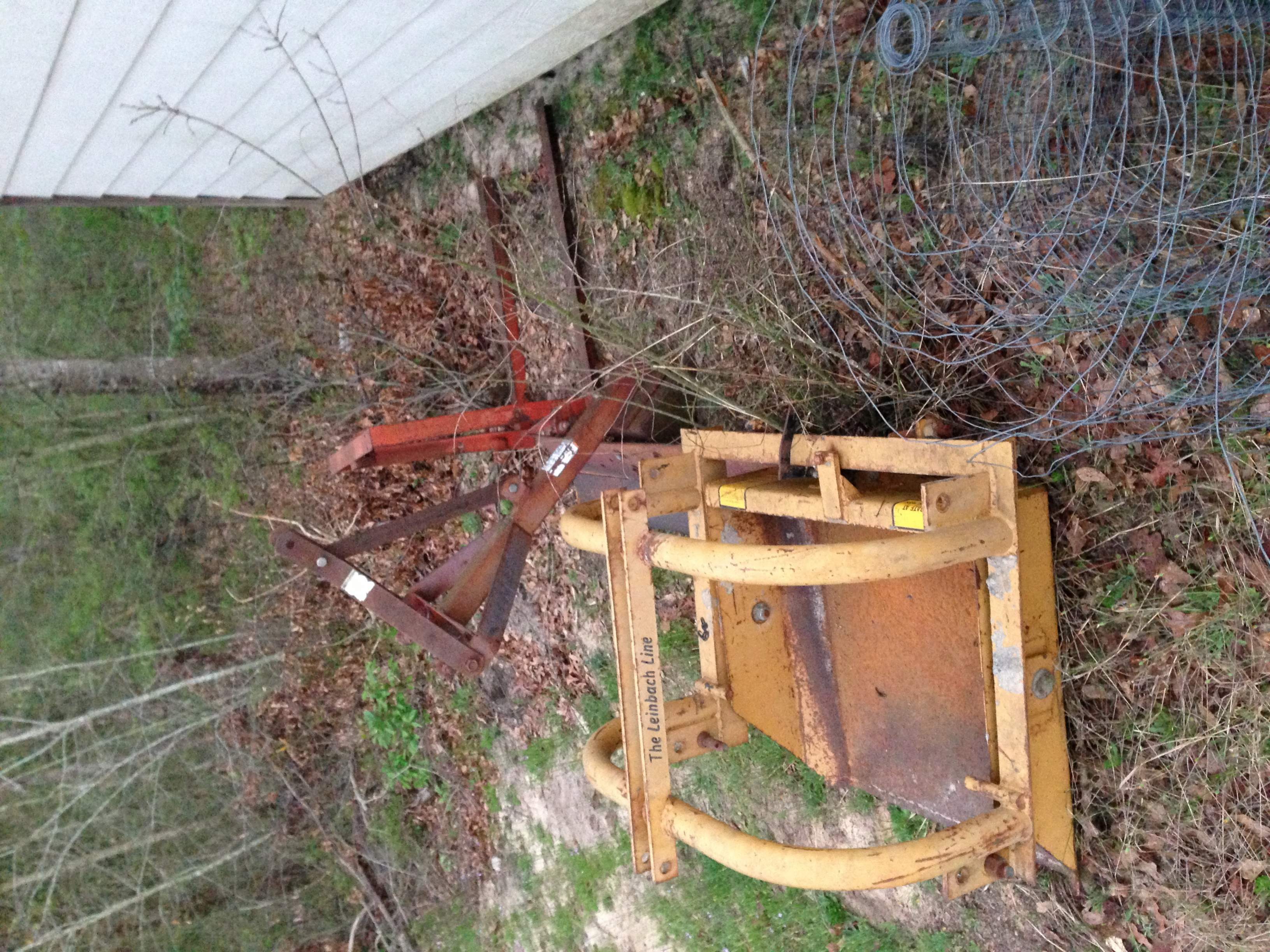

Hi everyone. I just bought a 1510D the other day. I think I got a pretty good deal I got the tractor 4' king kutter finish mower, scrape blade, forks, and a scoop for $1800. It runs pretty good. I'm gonna change the fluids this weekend. I will need to get manuals before long but not right now. If anyone has any tips or anything that will help me feel free to let me know. I am also wanting to get rid of the finish mower and get a bush hog.

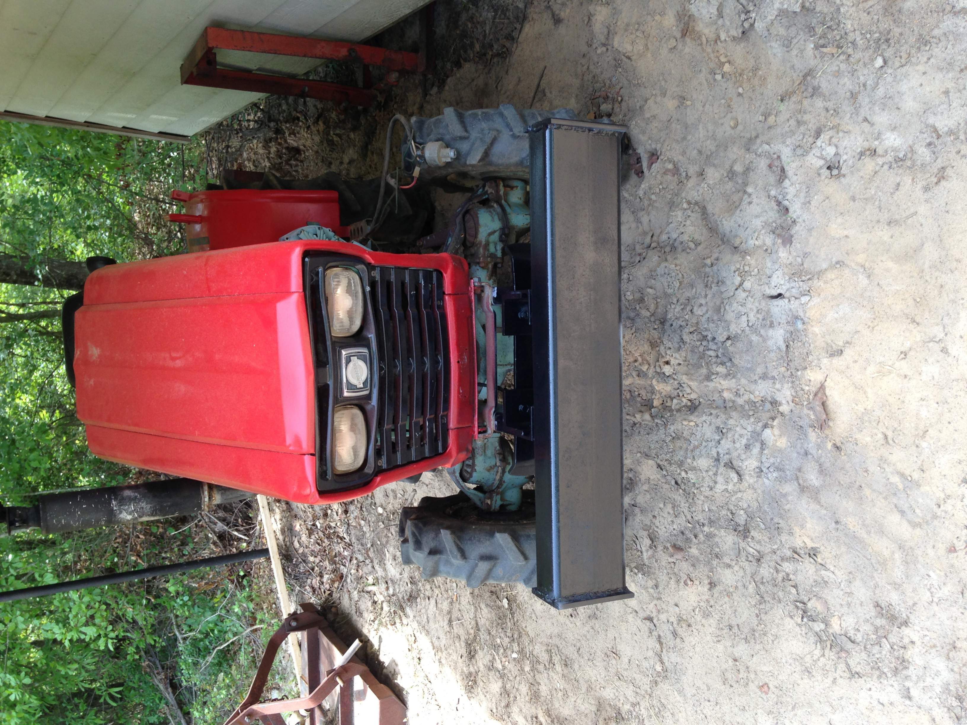

Here is one of my bumper I made the other day. The hood looks funny because it's up sitting on the dash that has been removed to get the steering box out. image.jpg
