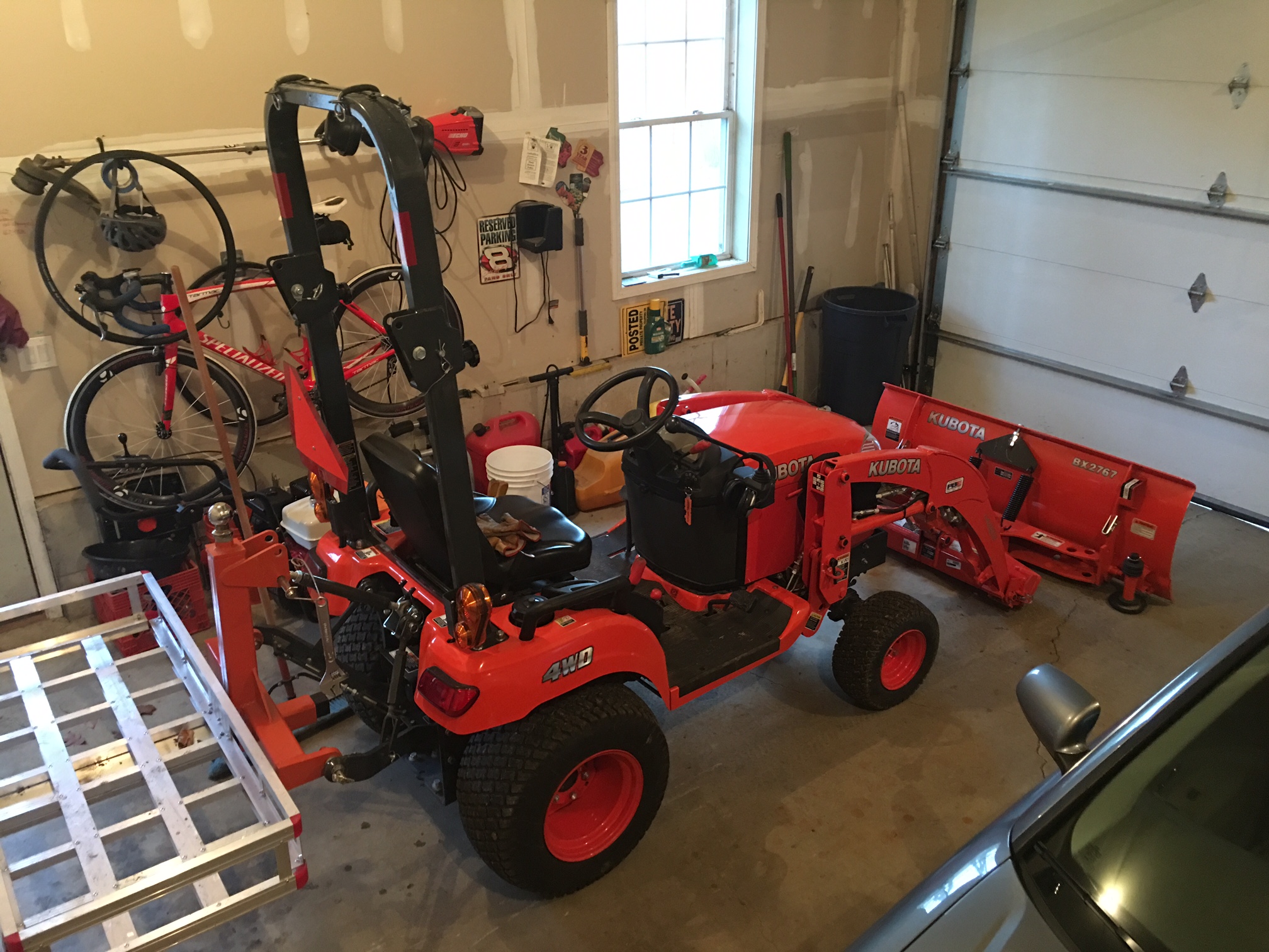

I have an BX1870 with 80 hours on it since April. Love it! Gearing up for snowplowing. I got a hitch cargo carrier and I was thinking of adding driveway salt & sand for weight. I have a inclined driveway so I probably need chains. Any suggestions on View attachment 490614where I should get tire chains?
How do you like that plow? I'm considering it. Is the blade angle hydraulic, if so how do you change the angle?
