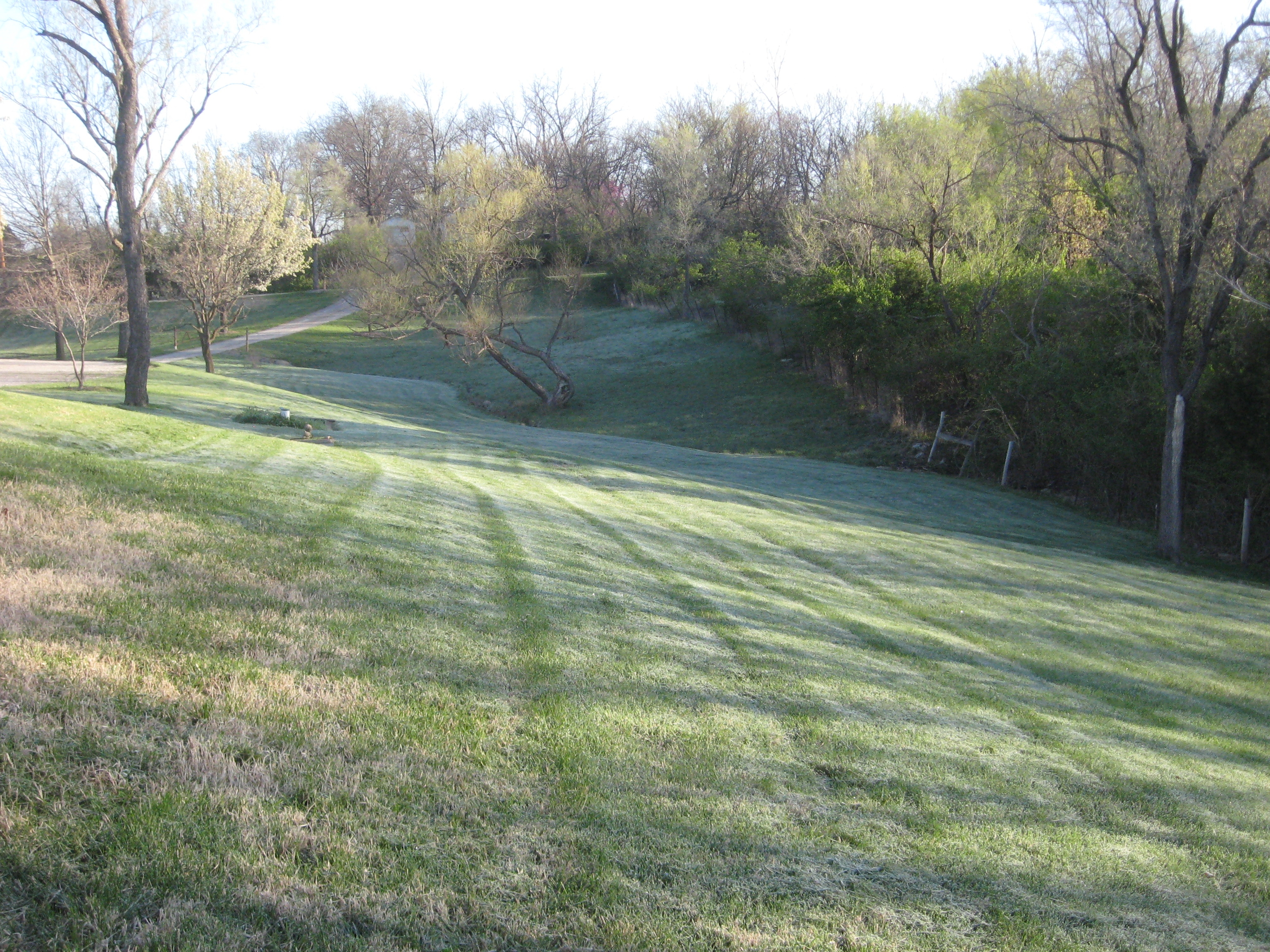

Spring 2025 update: Mowed for the first time this year yesterday with the reduced tire pressures with interesting results. As a recap, the sidewall tire pressures are listed as 28 front and 20 rear. The ride at these pressures was punishing. I changed them to 10 and 15, respectively to try and improve the ride. After playing with it a little, I decided 10 on the front was too low because it made the steering heavy.
So for yesterday, I set the tires at 15 for both front and rear. The result was that the ride was indeed smoother, i.e., it went from a sharp jounce to floaty bounces. However, the bounces amplified the tendency for me to bounce off the seat, resulting in at least 5 instances of having to reset the PTO due to auto shut-off. This is pushing me towards disabling the seat switch system entirely. Don't want to do it because I think it is a good safety feature, but it is just too sensitive....

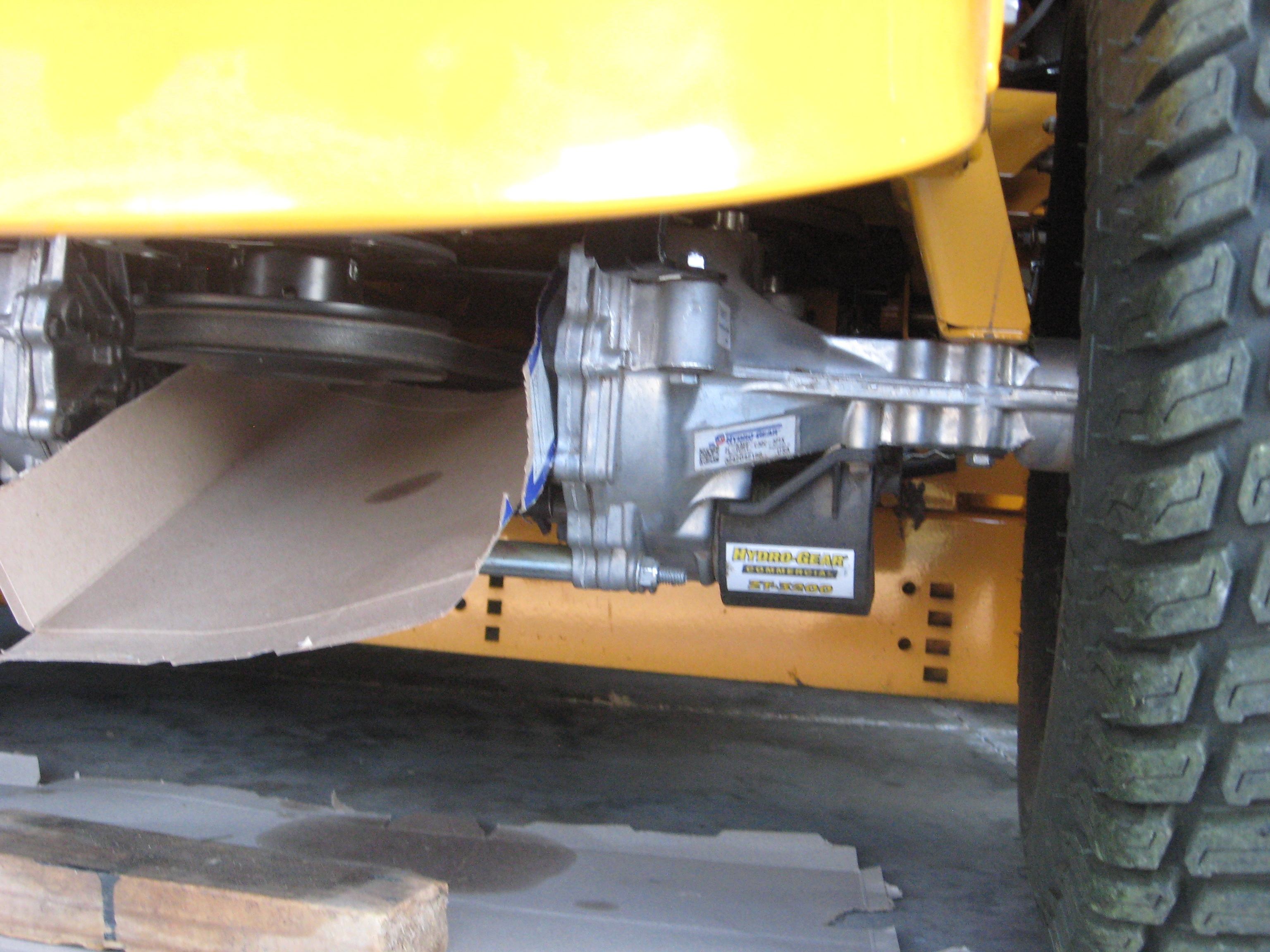

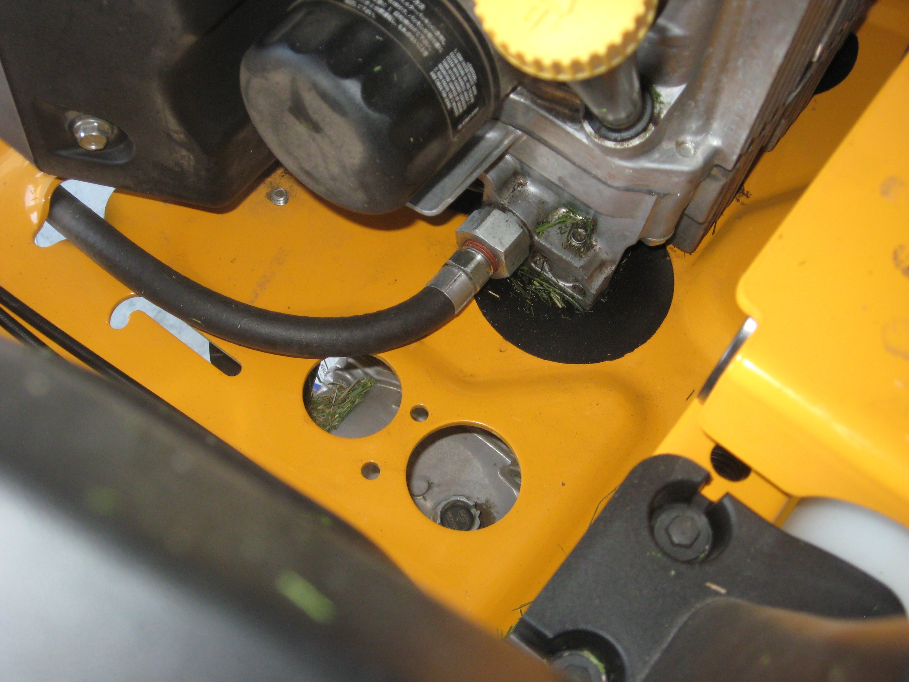

The unit is still dripping oil. I put cardboard under it to keep the floor clean and another layer of cardboard above the level of the drives, but below the pulleys, just to make sure the oil is coming from the engine (which it is).
I have pretty much isolated the source of the leak to the adapter fitting between the oil drain hose and the sump. The hose fitting has some type of thread sealer on it, but the adapter fitting does not. As mentioned previously, I can't get a wrench on the adapter fitting, so my plan is to wait until I change oil in June. At that time, while all the oil is out, I will remove the drain hose and the adapter fitting, then reinstall with some Permatex thread sealer. Wish me luck on that....

   / New 2024 Cub Cadet Ultima ZTXS5 54 #116
I did my first mow a couple of days ago - just a quick one while we had a break in the rain. Seat sensor didn't trigger once! :)

   / New 2024 Cub Cadet Ultima ZTXS5 54 #117
We are 3 weeks away from mowing season in NH. Looking at that drain hose that does not look like what they spec for the FS730V engine - I looked at several and they have an O-ring on the engine end and a thumbscrew with oring on the drain end. Here's a link to the hose on Amazon Amazon.com
The drain hose on my machine does match what is shown in the manual for the ZTXS5 54. You can't see it in the picture, but the drain end of the hose is just a square-headed pipe plug.
Your post brings up good point, i.e., that maybe there is an o-ring in the hole where the adapter fitting screws in, which would explain why there is no thread sealant showing. If so, could be that the o-ring was damaged during installation and the source of the leak. All will be revealed soon....

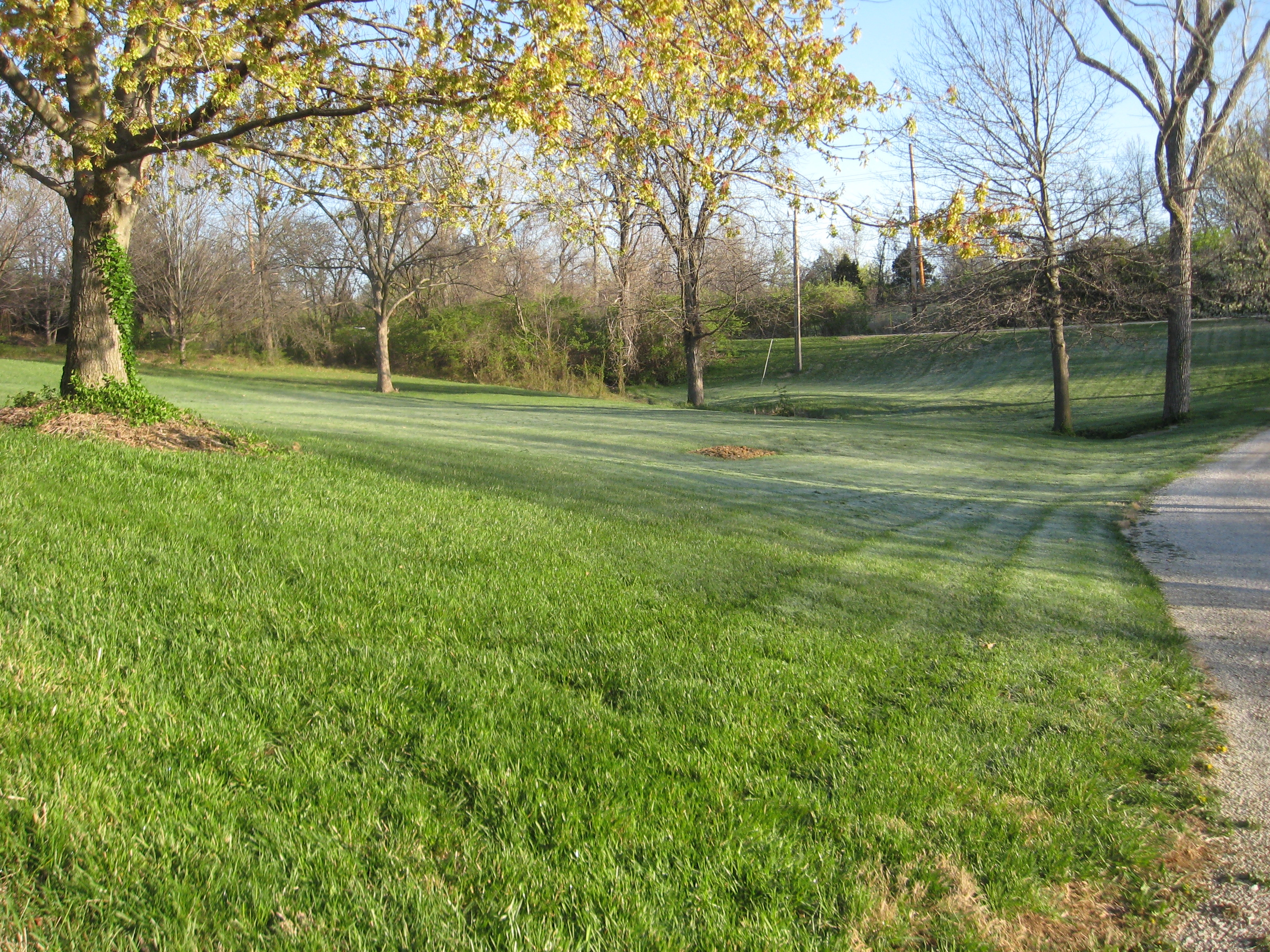

Second mowing of the season today. After getting bounced off the seat enough to activate the PTO cut-off three or four times, I'd had enough and did the plug mod to defeat the "feature".
For those unfamiliar, on MTD products there is a little "buss bar" inside the green plug where the wire attaches to the bottom of the seat. Just pull out the buss bar and reattach the plug to the seat and, presto, no more PTO cut-out.
Also removed the front-mounted counterweight because I think it is making the steering heavier and I won't be using the bagger for a while.
Other than those things, still running and cutting great...
Even the oil leak seems to have slowed down...hope that doesn't mean it's dry...:eek:
