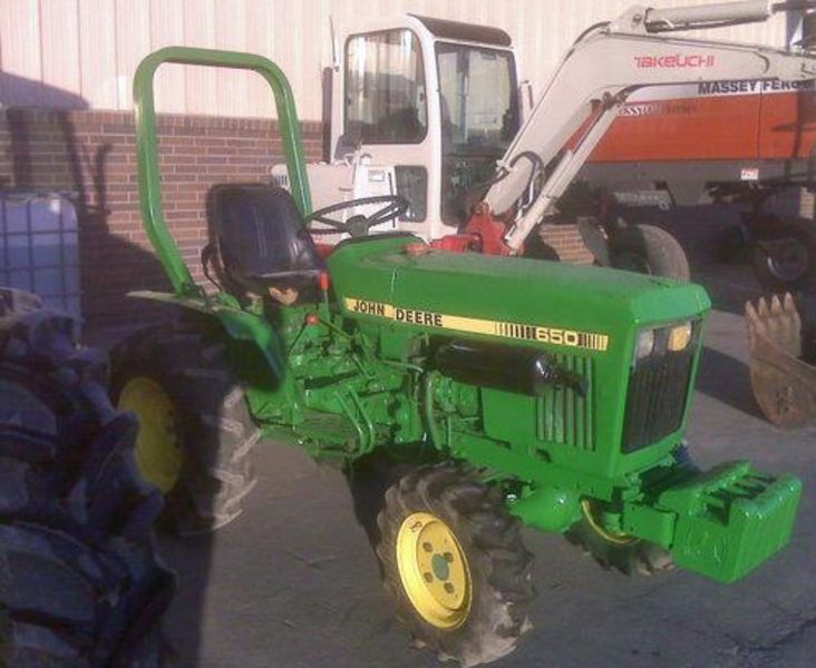

For the 4 speed Yanmar PTO speeds are as follows:
1=542
2=685
3=1005
4=1268rpm
These are at 2200 + engine rpm.
A JD 650 is a nice machine. My neighbor who helped my search for a tractor has one with a FEL. His looks really new since it's shed kept like the only below. These have a few tire sizes that work well. So, some will look lower or higher off the ground.
