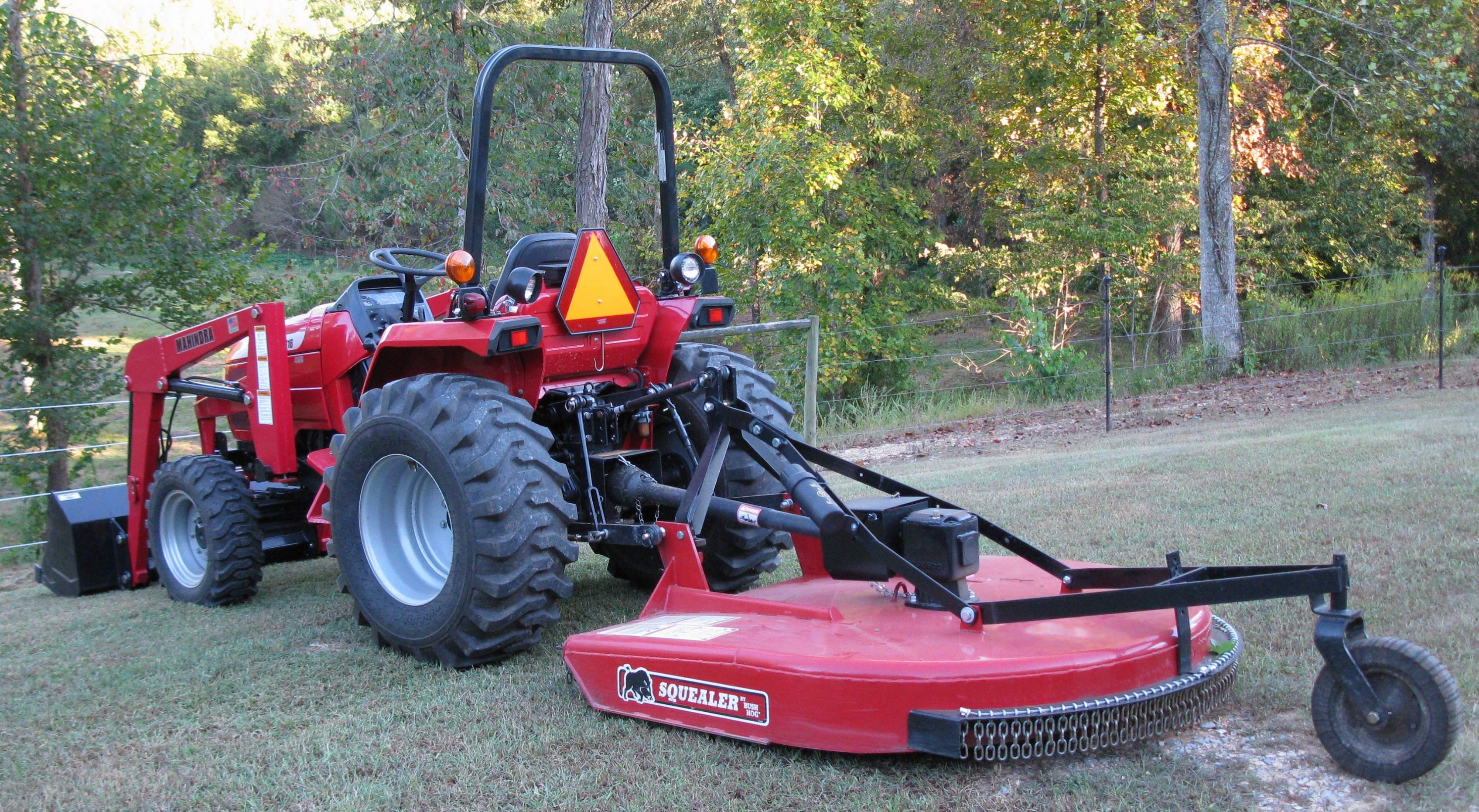

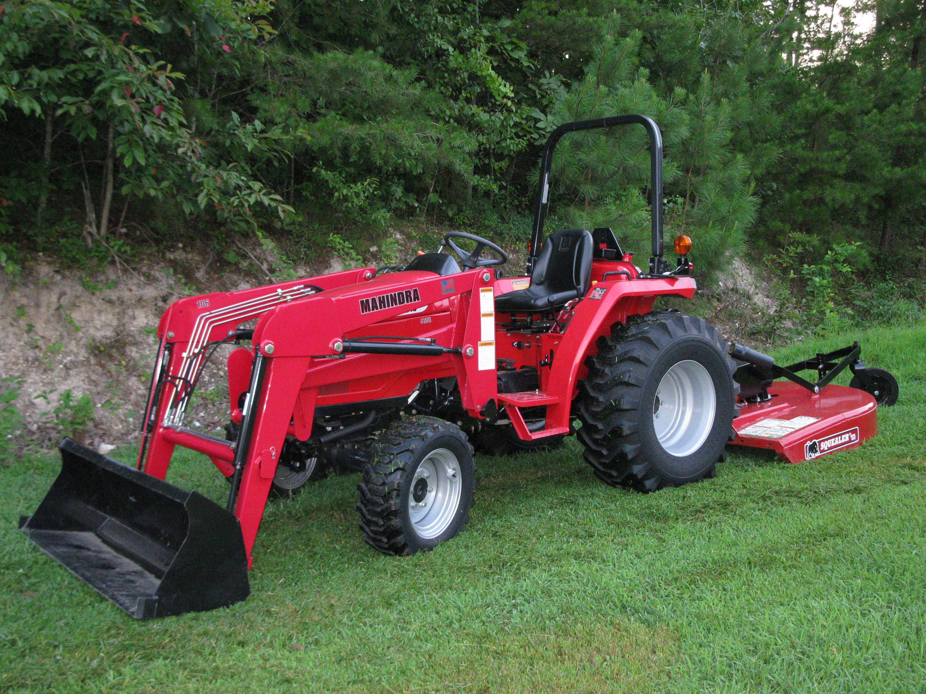

Okay. Just got this tractor a month ago. I new there would be a good sight with ideas to modify it. I WANT 1 or 2 rear lights, front brush gaurd with lights, and a top. I picked this tractor up as a repo with 15 hours. What would you guys say would be a fair price. The tractor was bucket and tractor only. I bought the bushhog here local

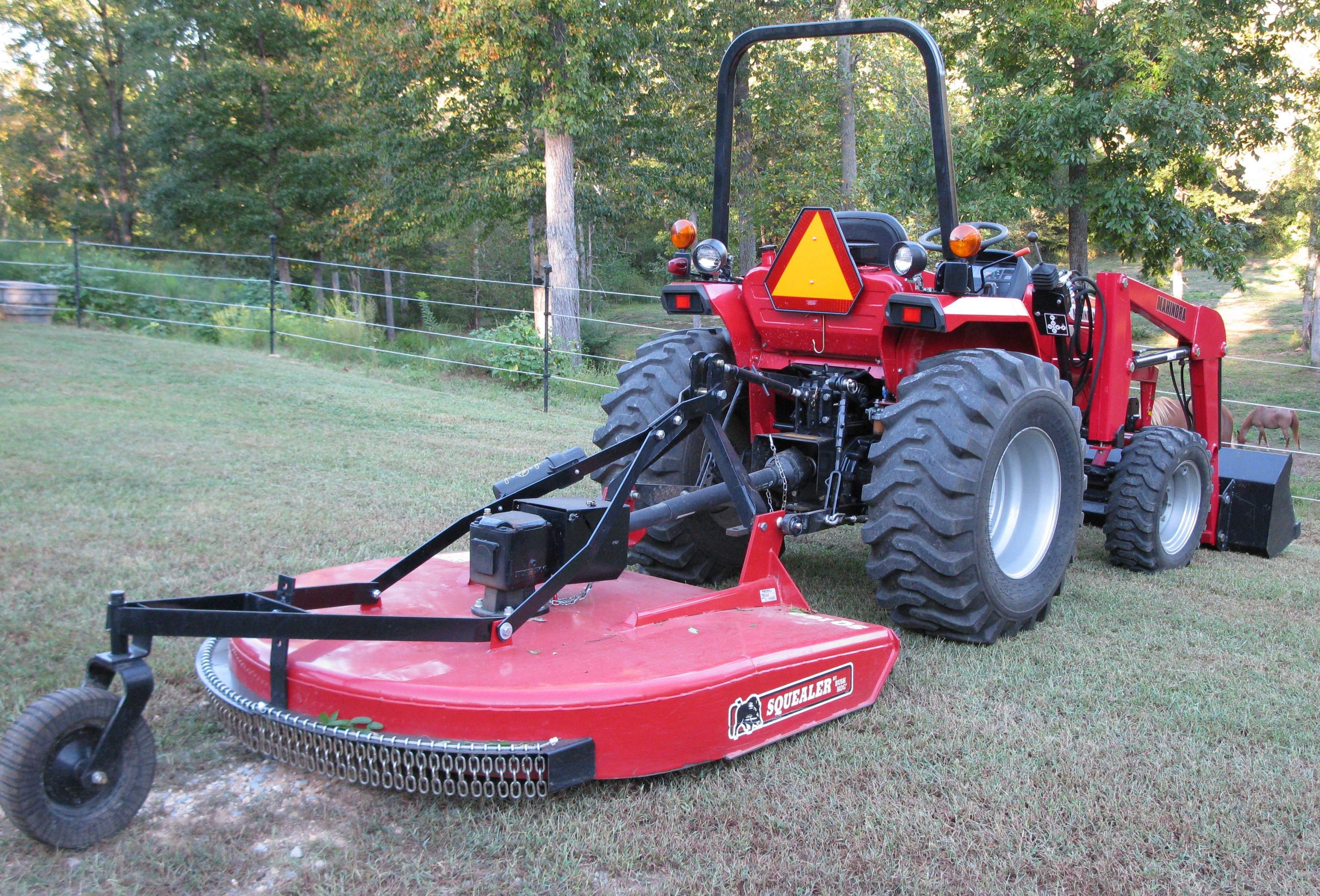

Been working on getting the pasure in shape. I was really grown up. The strip in the middle is a creek. I still have to work on that area.

I think a got a great deal on mine. $11,000 out the door. Had 15 hours on it. You see the picture. It was mint. It was a repo in Florida. I had to drive down and get it. Oh and lights should be on by the weekend:D

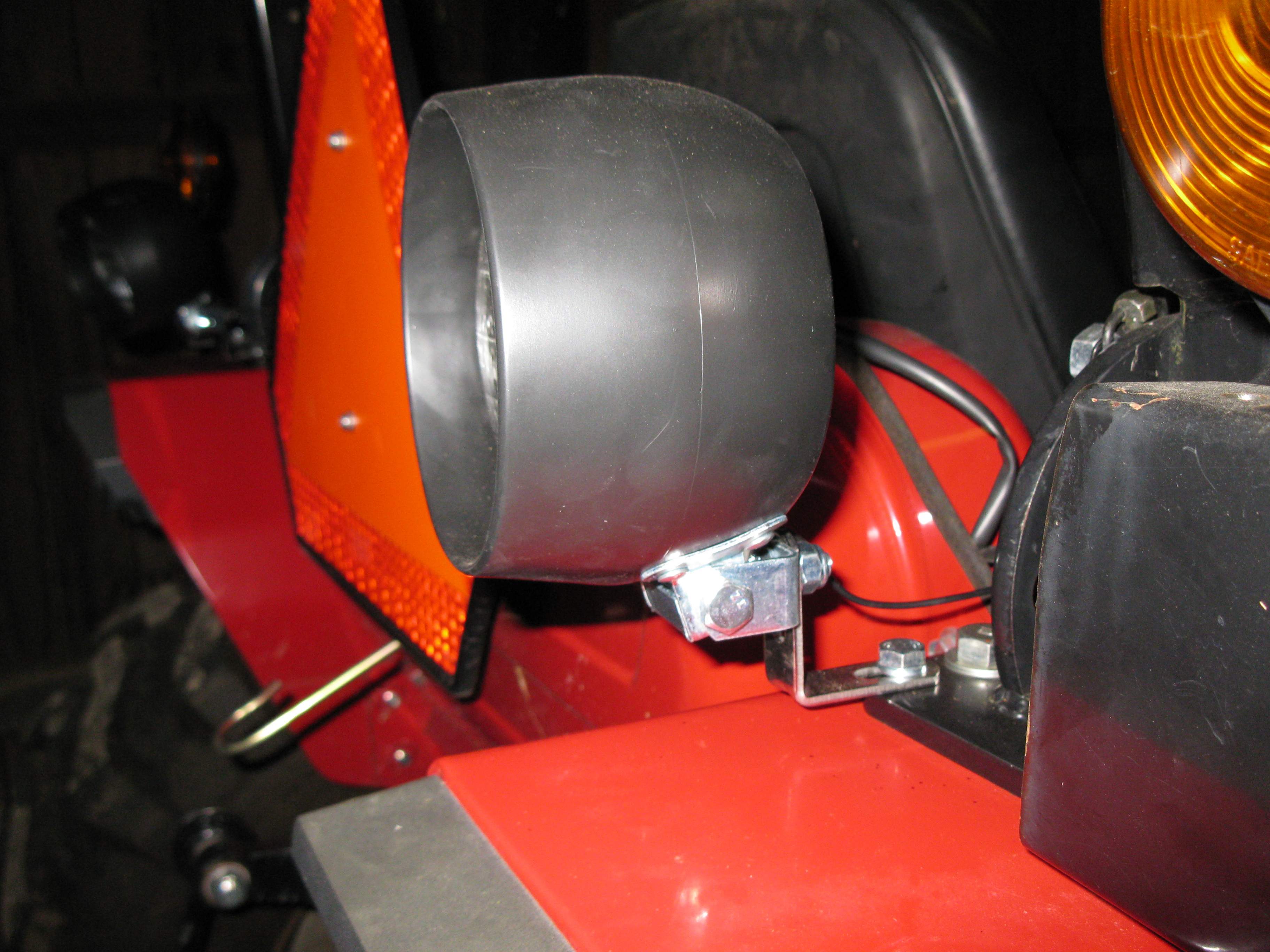

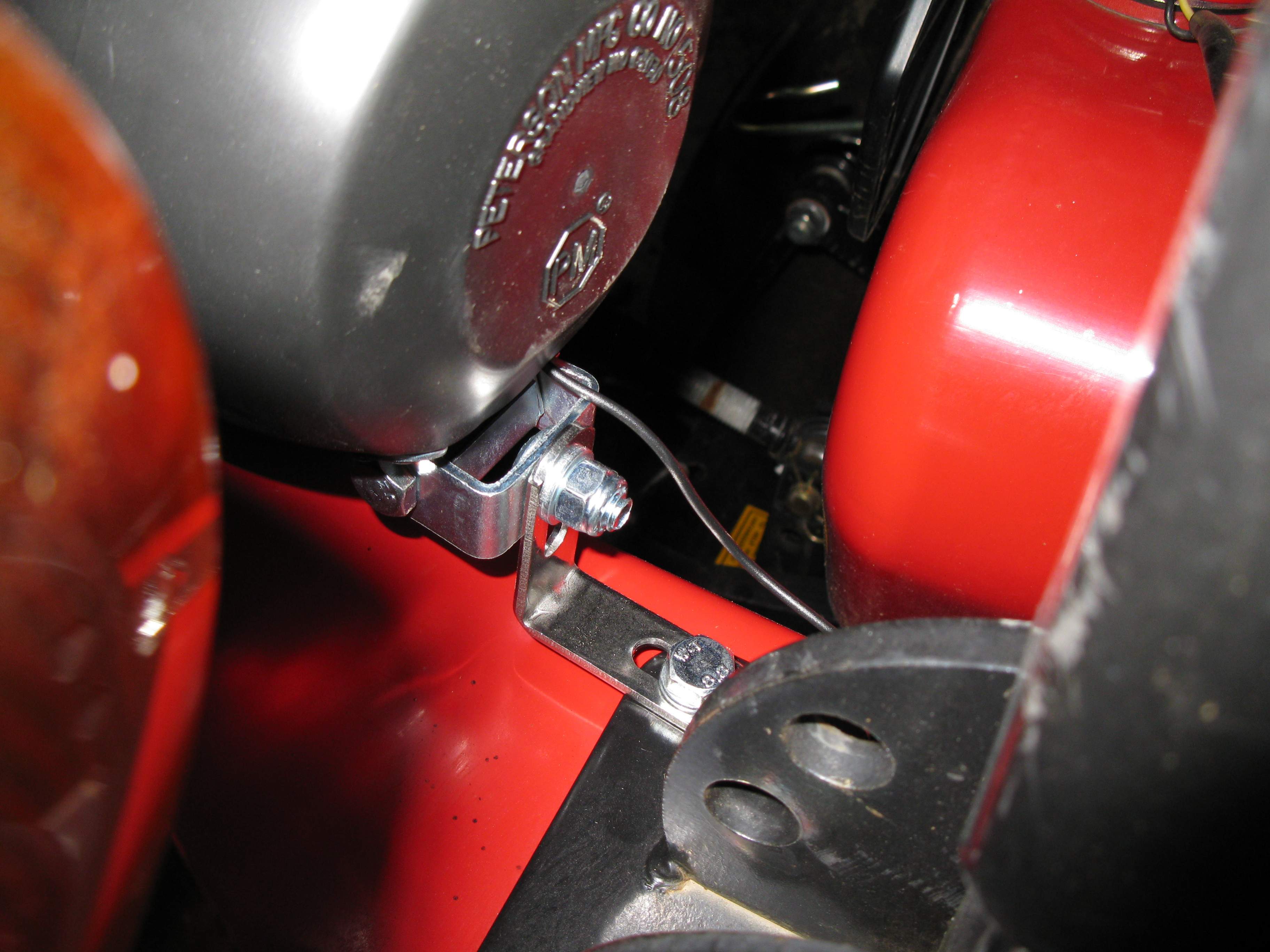

Okay added some lights. I have one faceing straight back and one sorta down towards the bushhog.

I used that hole that was already there. It is 8mm. I found a Grote (light Company) L bracket that worked perfect. The slot in the L bracket fits the carraige bolt sqaure perfect.

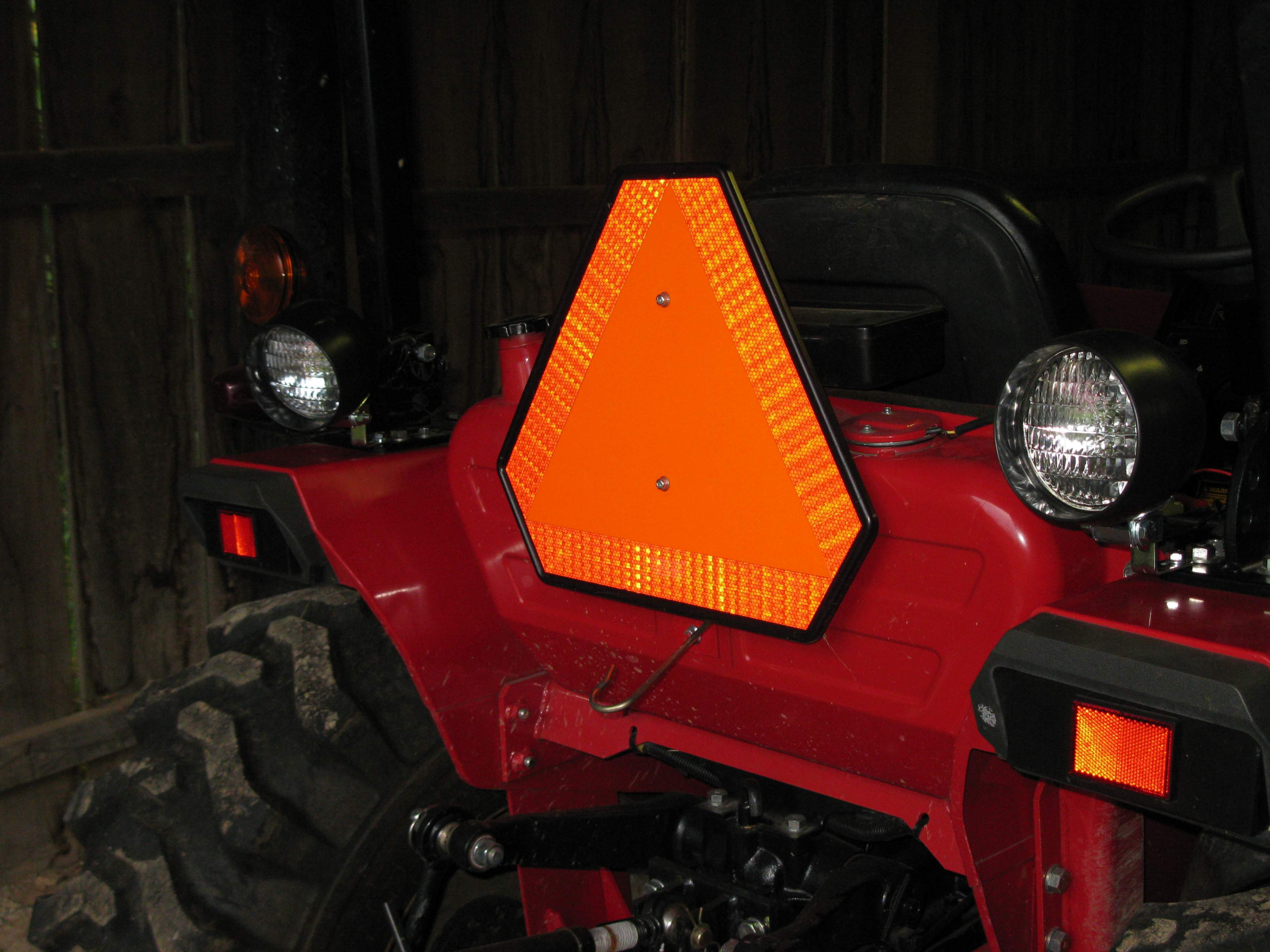

I few pictures with the lights

Where did you wire the lights for power. I've been wanting some light on my tractor but havent had time to tackle the project. Also, what about a switch?
/ New 2816
Folded down in the wires going to the flashers is two wires. (right side behind the seat) that is the hot and ground for the work light. Atleast on mine. I just grounded the black wire. And ran the red to a toggle switch and then two wires from the lights back to the switch. Very simple.

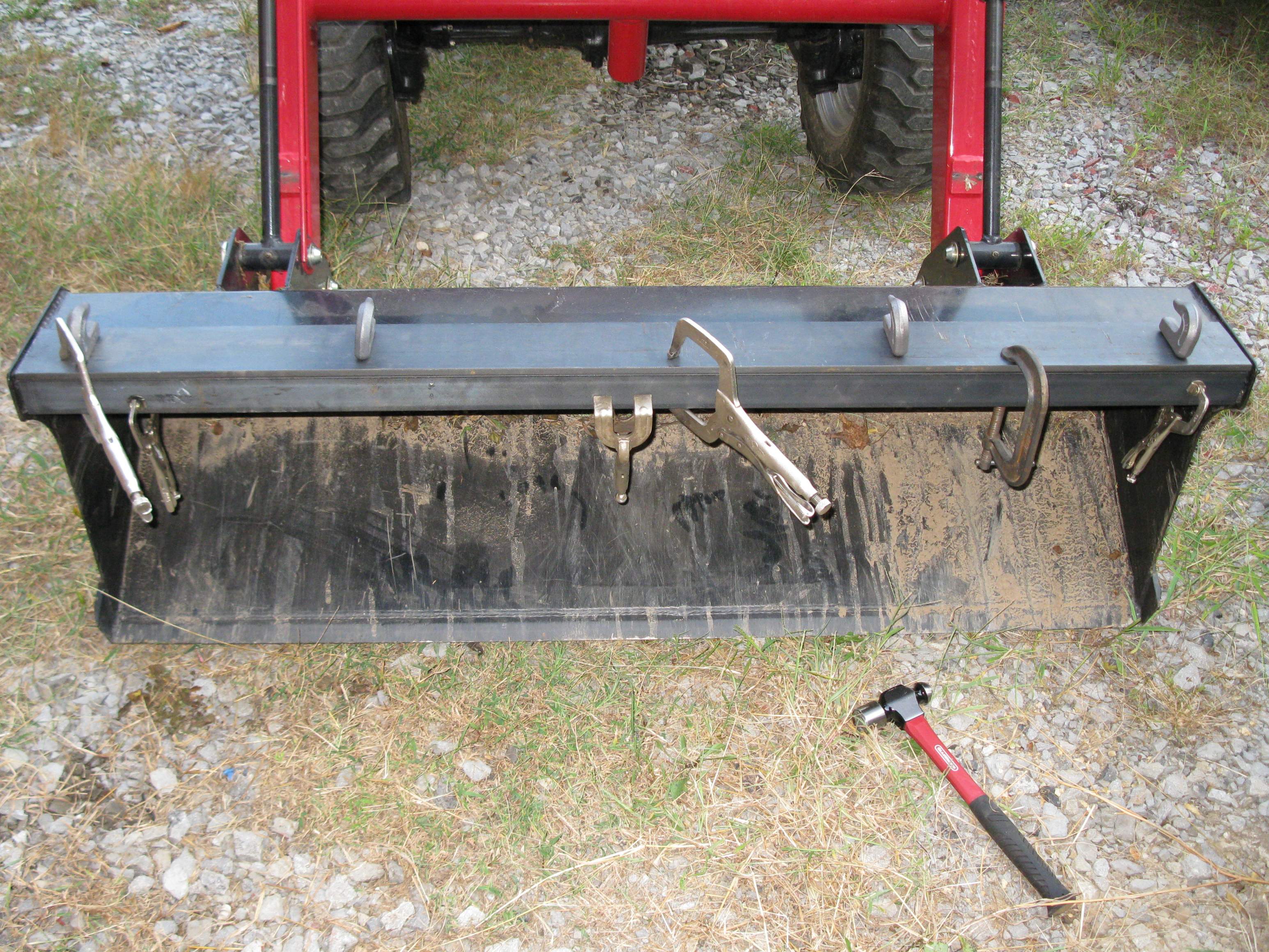

got some plate for the weld on chain hooks today. Not sure if I will start that this evening or not.

mock up.

/ New 2816 #13
I mounted three hooks on my 2615: center and one in line with each loader arm. I did not think it wise to go outside the loader arms due to safety concerns.
/ New 2816
#14
Well that was just a mock up. I still had to pull everything of to prep the area for welding. I also plan to drill some holes for some plug welds. I did move the hooks though. I still did the same configuration just closer to the arms. I put one on each side of the arms 4" out. I know the limitations of the tractor. I would rarely pull from just one side but what if it was something just 200 lbs that you could only use one hook. I think that would be fine. Honestly I don't have alot of stuff to pull. I saw this mod on here and just thought I would go ahead and have it if i need it.:D More pictures soon!
/ New 2816 #15

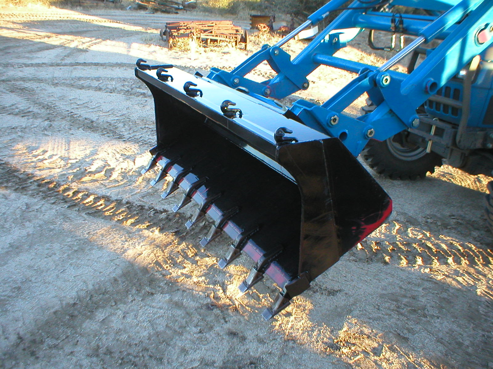

Most people use angle, but that plate looks like it will work out just fine. As far as having hooks out at the outside edges of the bucket, with :2cents: of common sense you will have no problems. Just another reason to have more than a couple of hooks on the bucket. I have 5 on the 7520 and 4 on the 3215, haven't twisted the loader frames or tipped the tractors over yet.

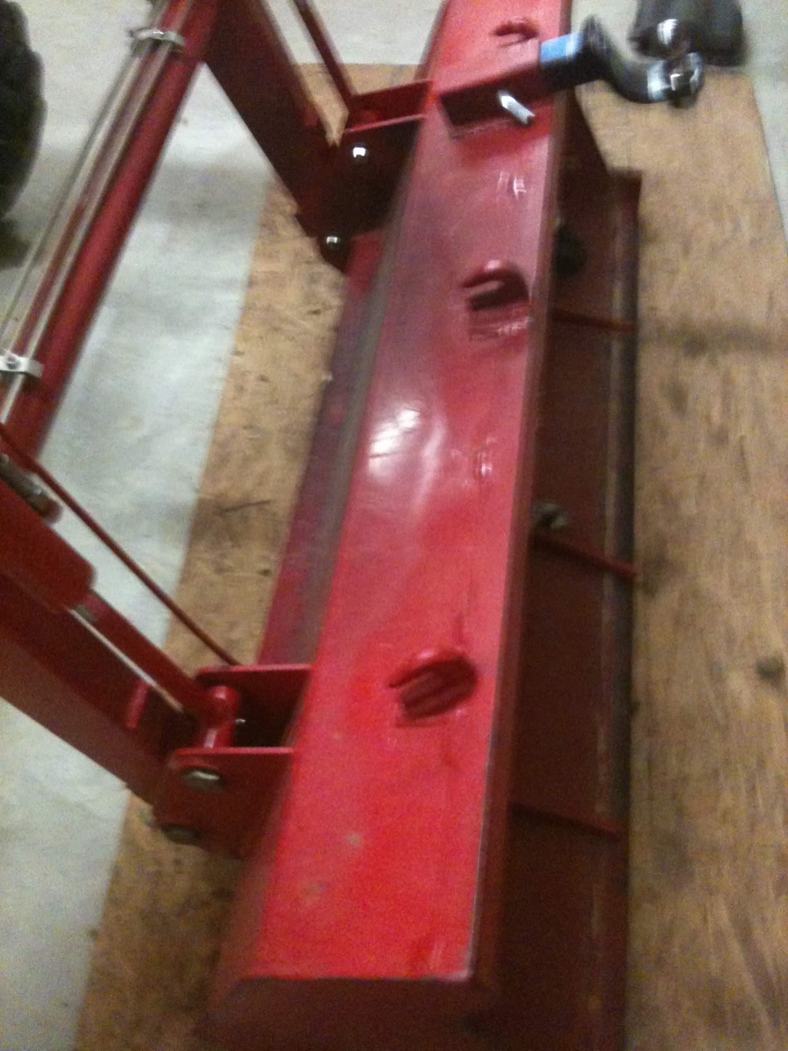

I have used my hooks far than I thought I would. I bought the tractor used. The top edge of the bucket was bent. When I had it straightned I added reinforcement and thought what the heck add three hooks. They are great to pull fence posts, small trees, load stuff on trailers, etc. I have since added a reciever hitch to the bucket.

/ New 2816 #19
Very nice project started there.
Question, did you buy the forged hooks with the loop on them and then grind the back surface flat, or are there hooks designed like that?
I plan on a hook on ether side and a receiver in the center.
Mike
/ New 2816
#20
You buy the hooks that way. There made to be welded.
