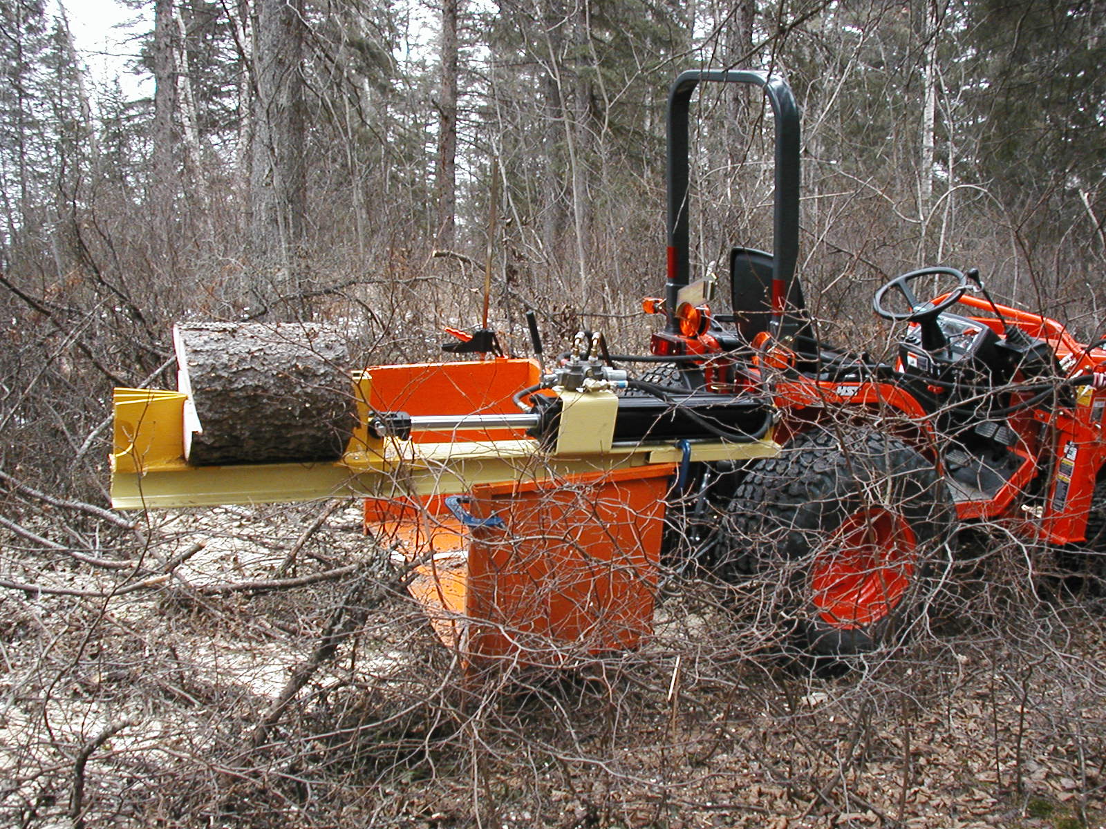

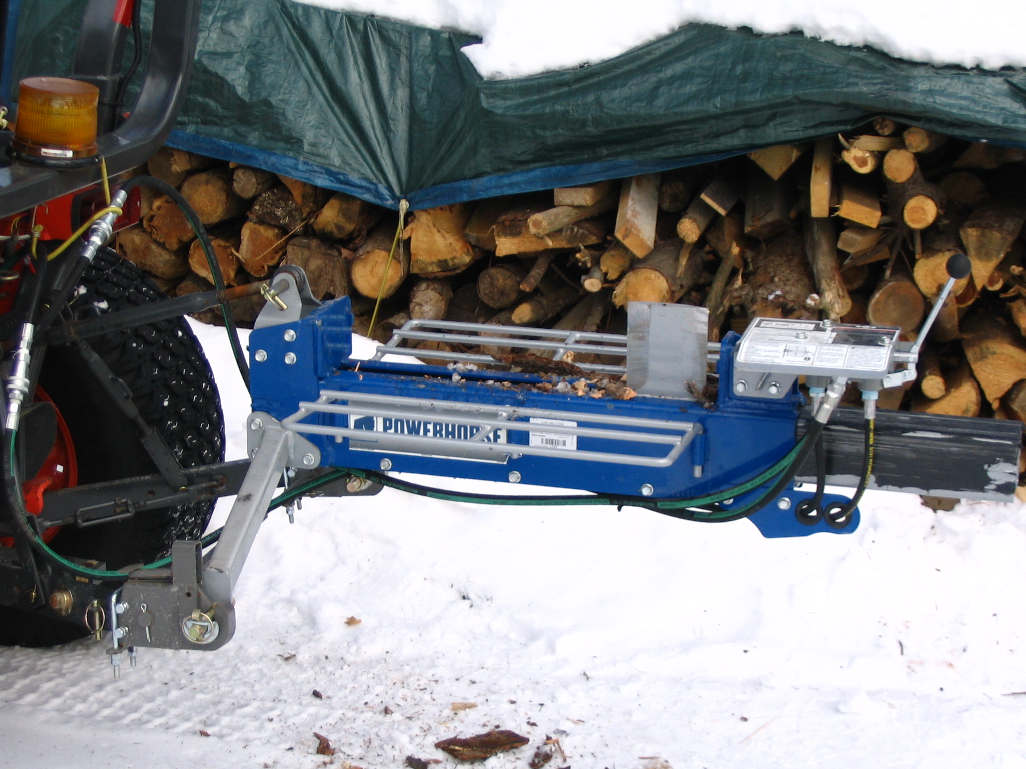

Bought the Powerhorse 3 point splitter from Northern tool, and although I was a bit skeptical on its performance, for the money it works great:D
Ran the tractor at only 1500 rpms and that was enough to keep me busy. With the dual sided splitting ram, there is very little down time.
Handled the knots fine, pushed right thru them..
The fluid out is in a poor position, becuase the hose runs right in the way of the ram, but pick up a 45 degree elbow, (see pic) and it was an easy/ cheap fix...
Limited to 18" but thats fine for my use. The cradle /table is great too, no need to bend over and pick up the other half.
Looking for a 3 point splitter? I'd give the powerhorse a try. And No, I don't sell them, even though this sounds like a ad endorsement.:)

Nice splitter! Are you running that off a rear remote or a power beyond circuit?

Nice looking, well-engineered splitter. I like the two-way splitting, especially for those of us with low-GPM systems...and that cradle's not bad either! If I hadn't picked up a RamSplitter off eBay last year for the starting price (less than I could build one for), the Powerhorse would likely be my choice. My stove takes 20" wood, so 18" splits are no problem...plus, shorter logs are lighter...:D

Looks pretty nice. I love the price and the two way action. My only concern would be that it can't function as a vertical splitter. On occasion I've had some mighty large oak rounds to split. I'd need the tractor to lift a 35" wide log onto the splitter. Its easier to roll it to my splitter and stand it on end, then I can just slice away while comfortably seated on another log.

I did my own Hydrualics. If you have a power beyond and/ or a backhoe/ and a 3 pt hitch its very easy / super easy, just a matter of extending the length of the lines...
Off a power beyond circuit until I install me rear remotes, then it will be off the rear remote float circuit...
If you lower the unit to the ground, I can roll a fairly large log on to the splitting table. maybe over a 5-6" lip and if you use a peavy to roll your logs then no problem
I looked at the ram splitter but the dual action of the powerhorse made more sense....as well as the cradle... then it was a no brainer..
