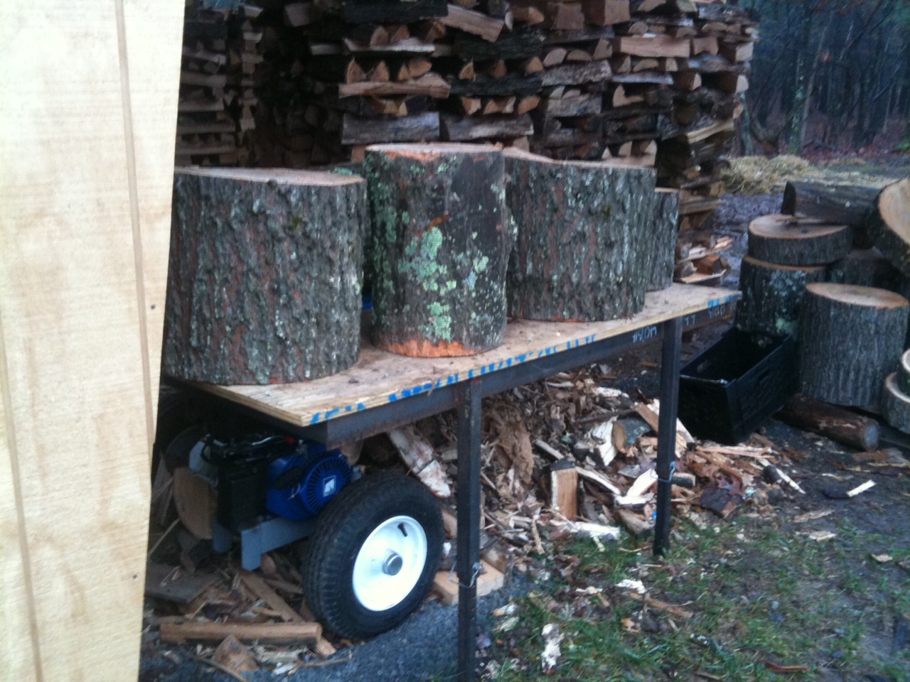

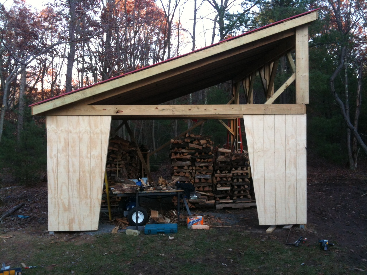

RadarTech said:
Been bouncing the idea of playing with the hydraulics and getting a standalone......
I decided on PowerHorse bi directional splitter but like you, I had the same quandary as to 3 point or stand alone.
So I ended up made a pros vs con list on each one to better help me decide.....
Have had the stand alone one for over 6o days now n have not regretted the decision once.
Final tipping of the scales for me was when I realized that if/when the China Town PowerHorse motor takes it's final crap, I can than always power it with my Kub's hydraulic system anyway.
Naturally your situation is different than mine but just thought my two cents might be worth a penny to you.
