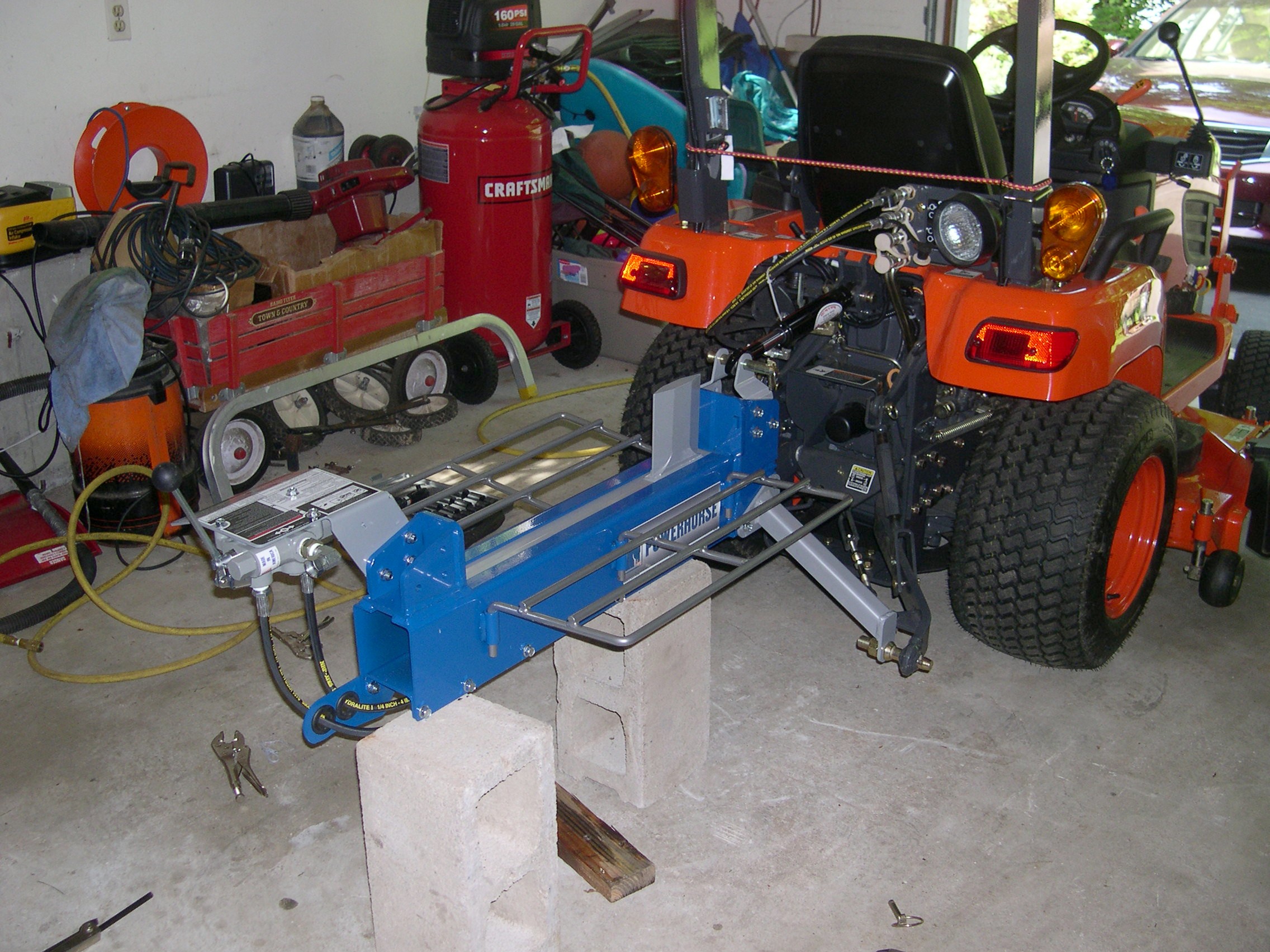

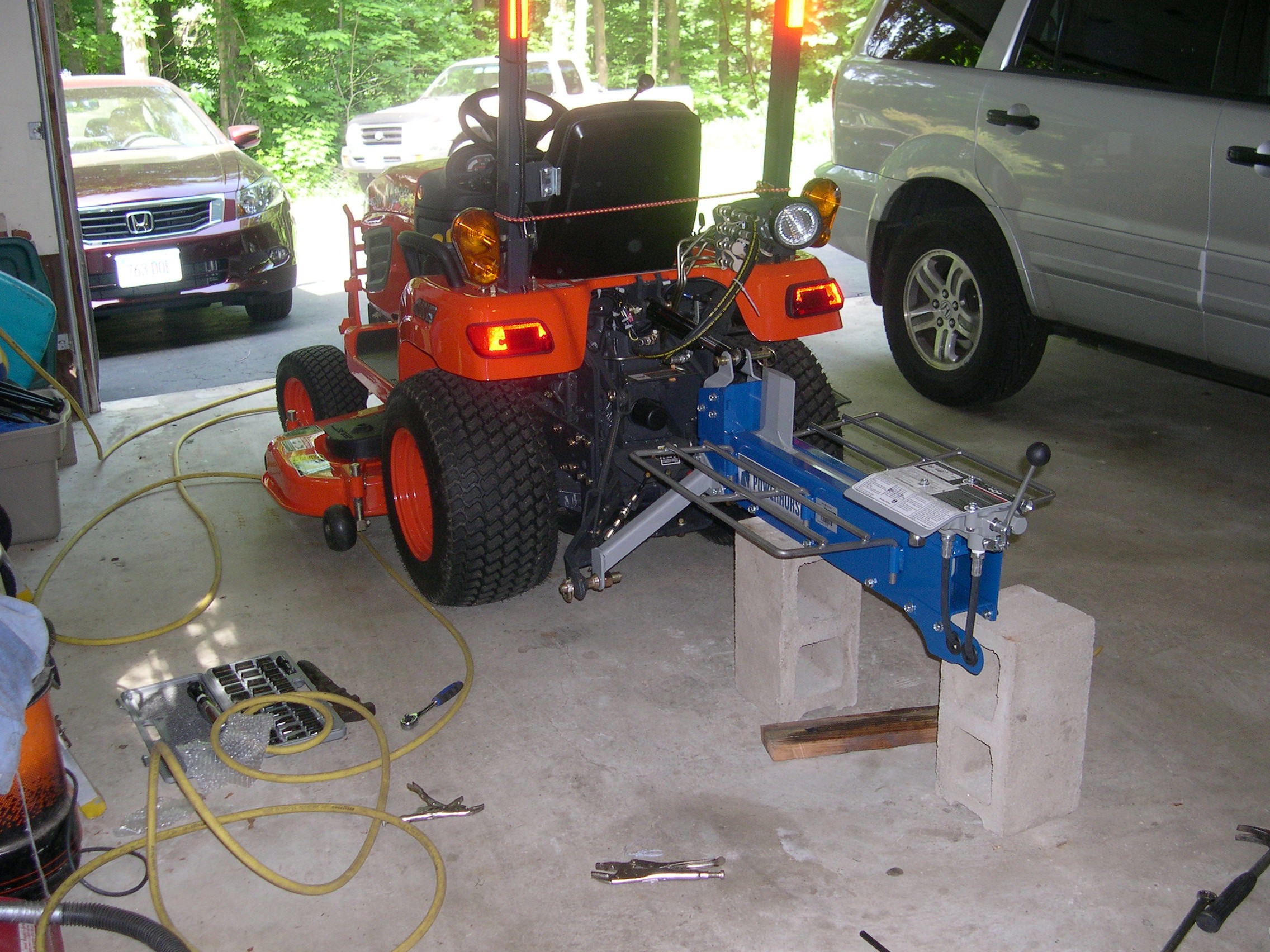

Had some time this weekend to put the splitter together and mount it on my BX so I could measure for hoses which I'll be ordering tomorrow. Everything went pretty well except getting the in and out port blanks off of the valve. They look to require a very large hex or allen wrench - bigger than any I have or even the local hardware store. Tried a half in socket drive but it wouldn't fit, it was close though. Finally figured out I could use the head of a proper size hex bolt and some vice grips to turn it.
What's also interesting is that while the instructions call for 1/2" hoses from the tractor to the valve, the hoses supplied going from the valve to the cylinder are 1/4", so I'm not sure why 1/2" would be needed for the valve supply / return. I will be getting 3/8" as Firefighter suggested.
They also instruct to orient that fitting Firerfighter got the 45* elbow for straight back vs down, which may help with clearance, but I'm going to get a 45* elbow just in case. Here's a few pic's.

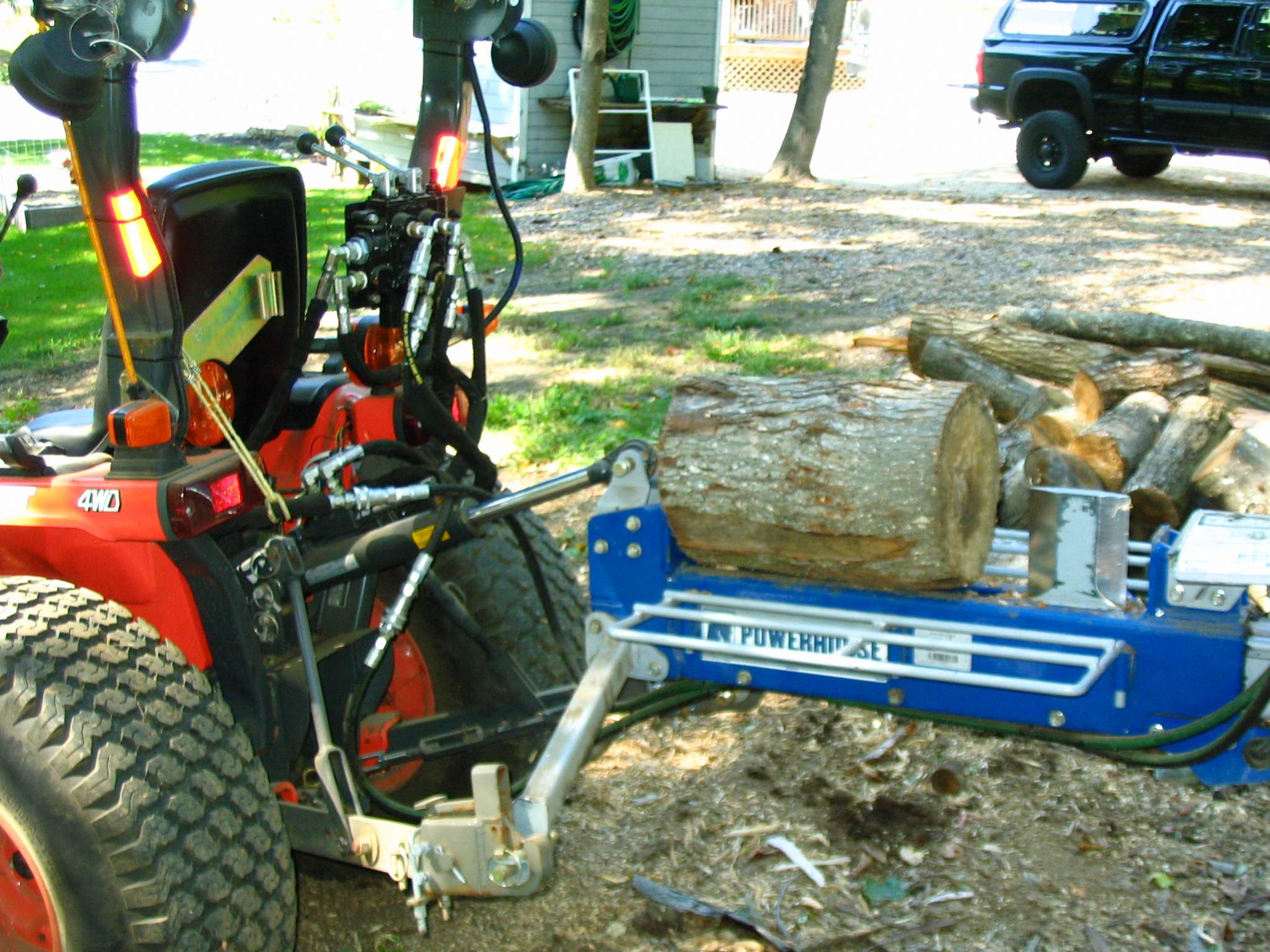

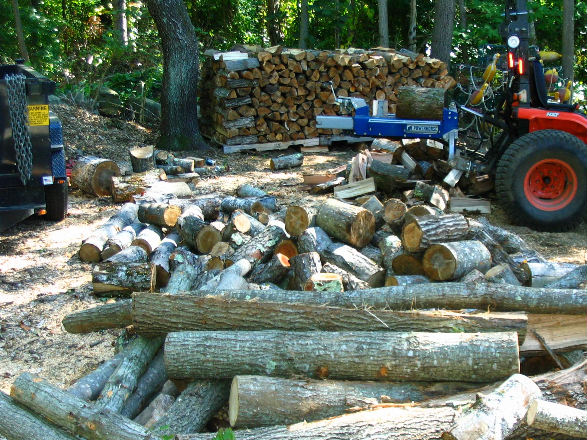

It took just about 4 hours of total splitting time to do this pile and that which is already stacked 2 logs deep in the backround...(stacking time not included)
I've got no complaints with this splitter. Since a 20" log can be tight in my stove th 18" is perfect.
Occasionally a large oak or maple 20" or so, can be difficult to split, but if you just take a slice off the side of the log it "breaks" the seal and then you can split down the middle...I only run at 1500 rpms, maybe bump it up for a stiff log, but thats it...

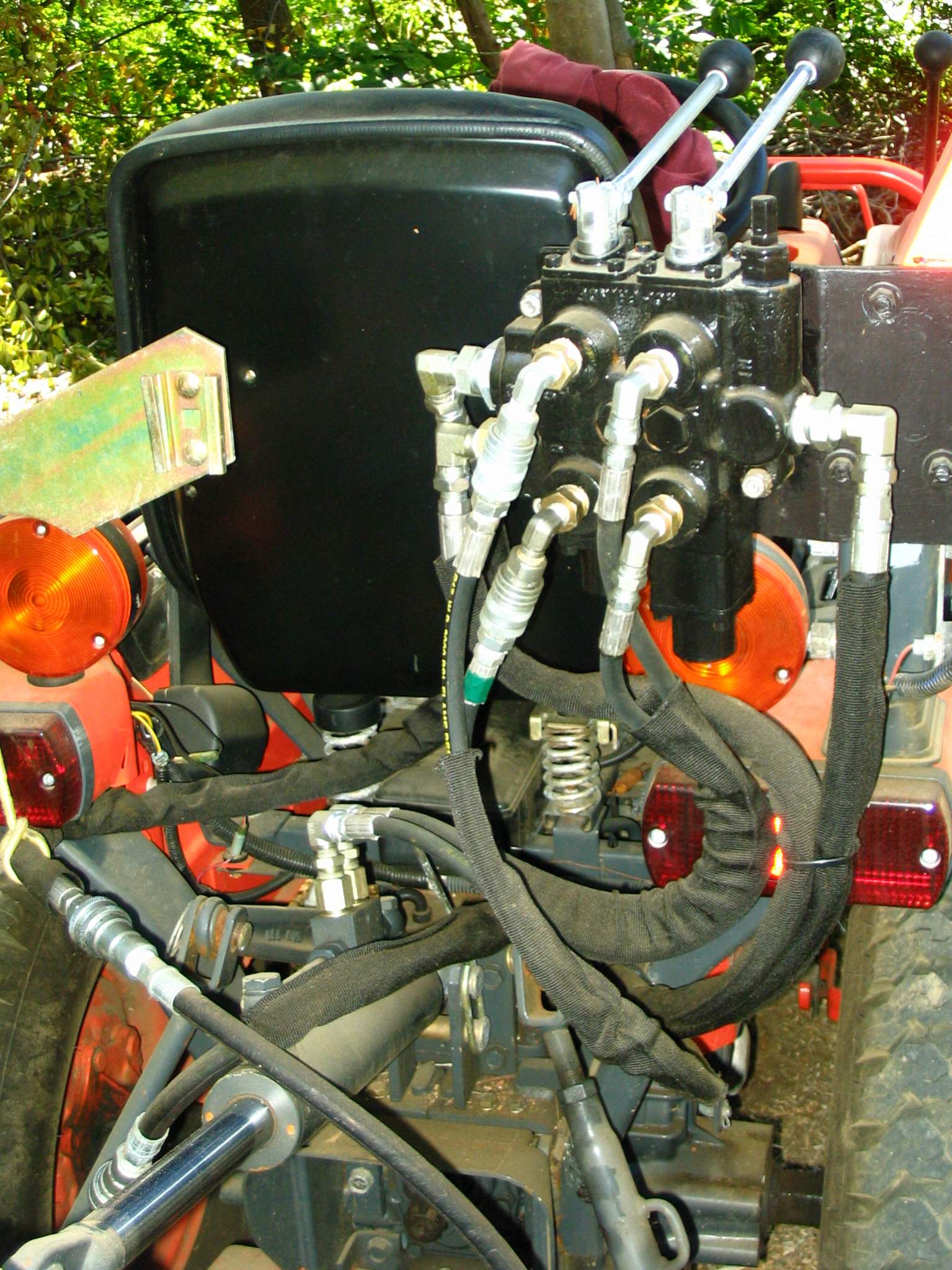

Here are some updated pics of the new hoses on the rear remotes..
