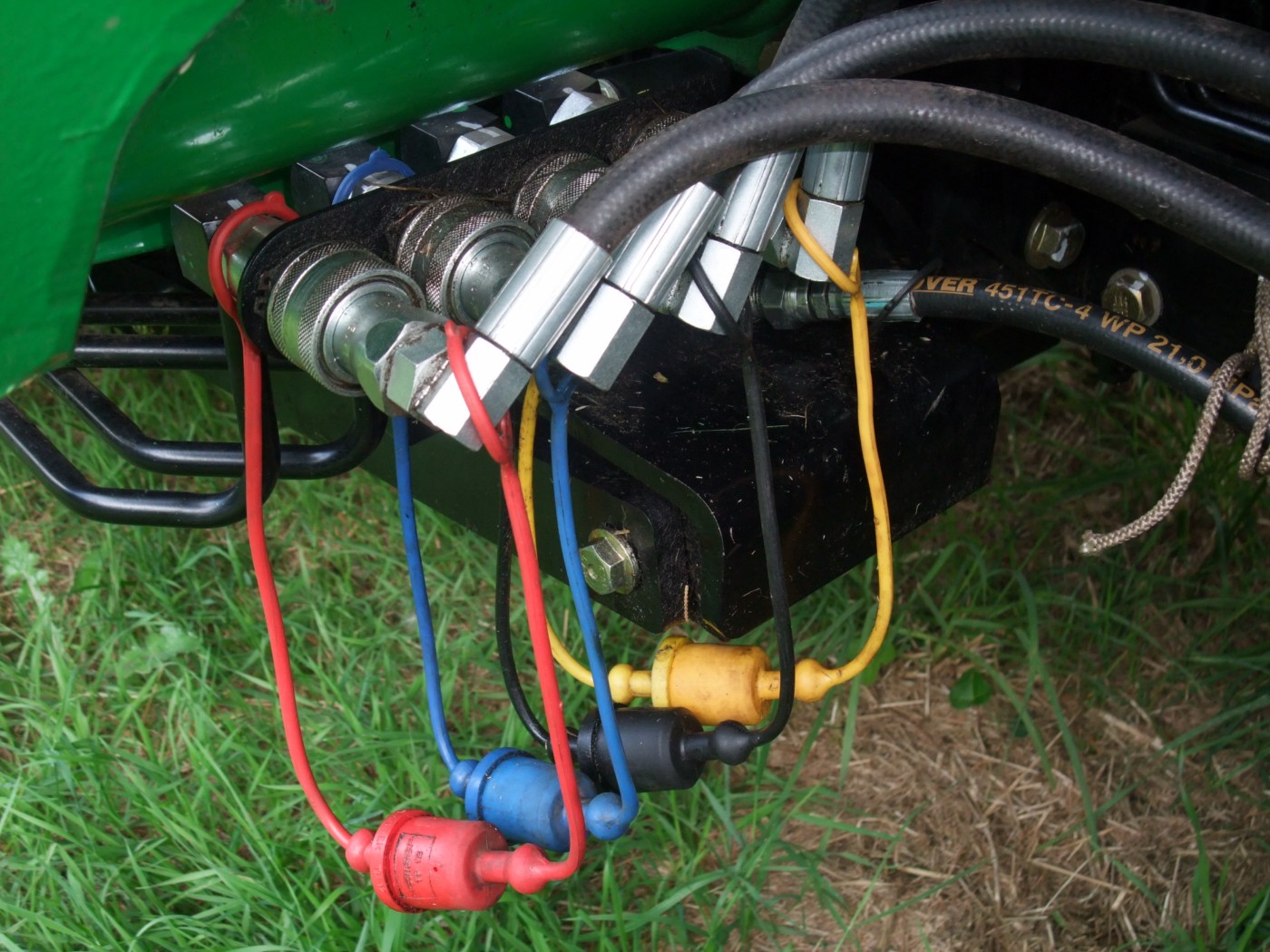

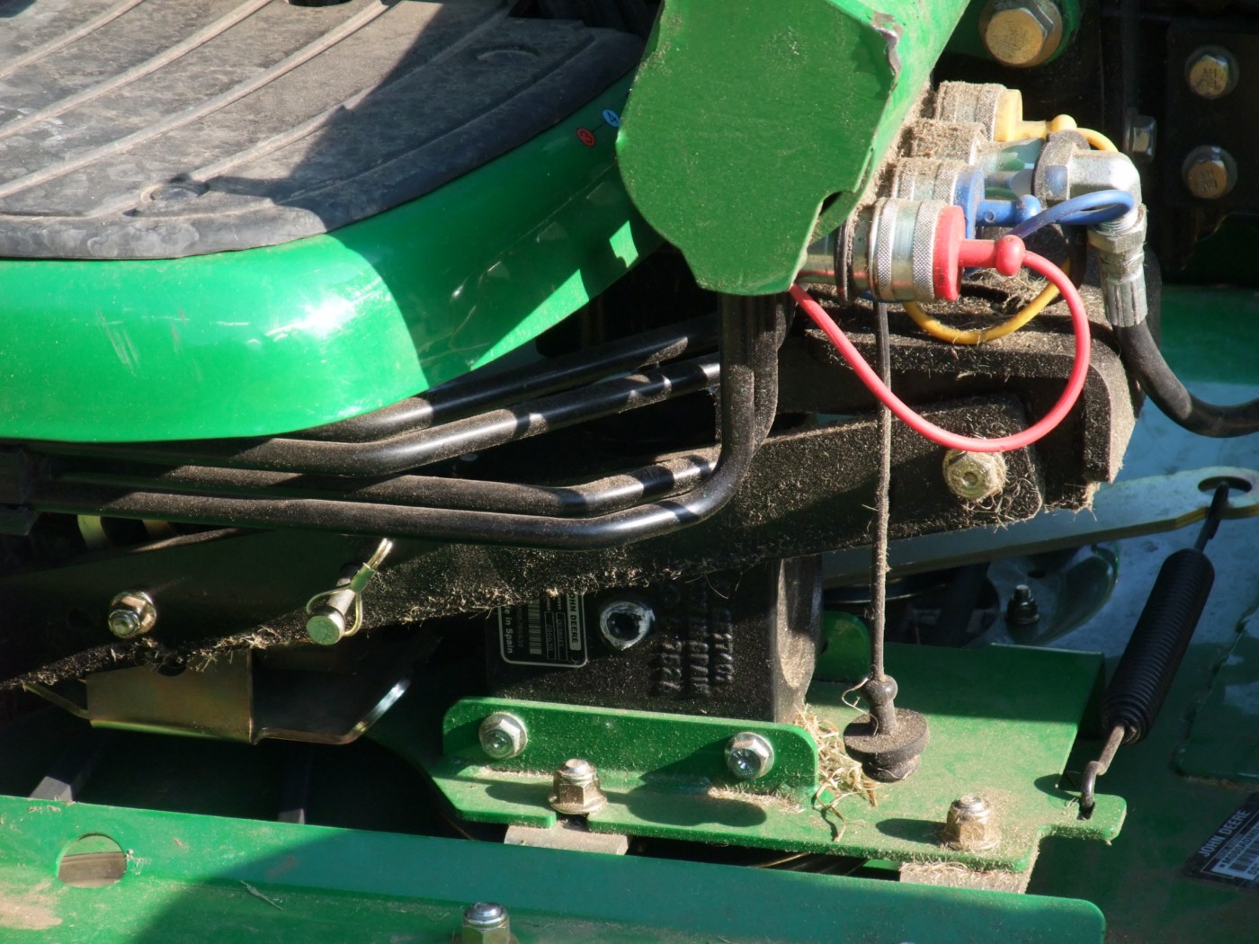

I suppose the hydraulic hose for the deck's single effect lift cylinder is connected to one of the front quick couplers otherwise used for the loader (pic 2) so that you can use the loader lever to raise and drop the deck. So why activate the rear SCV ?
