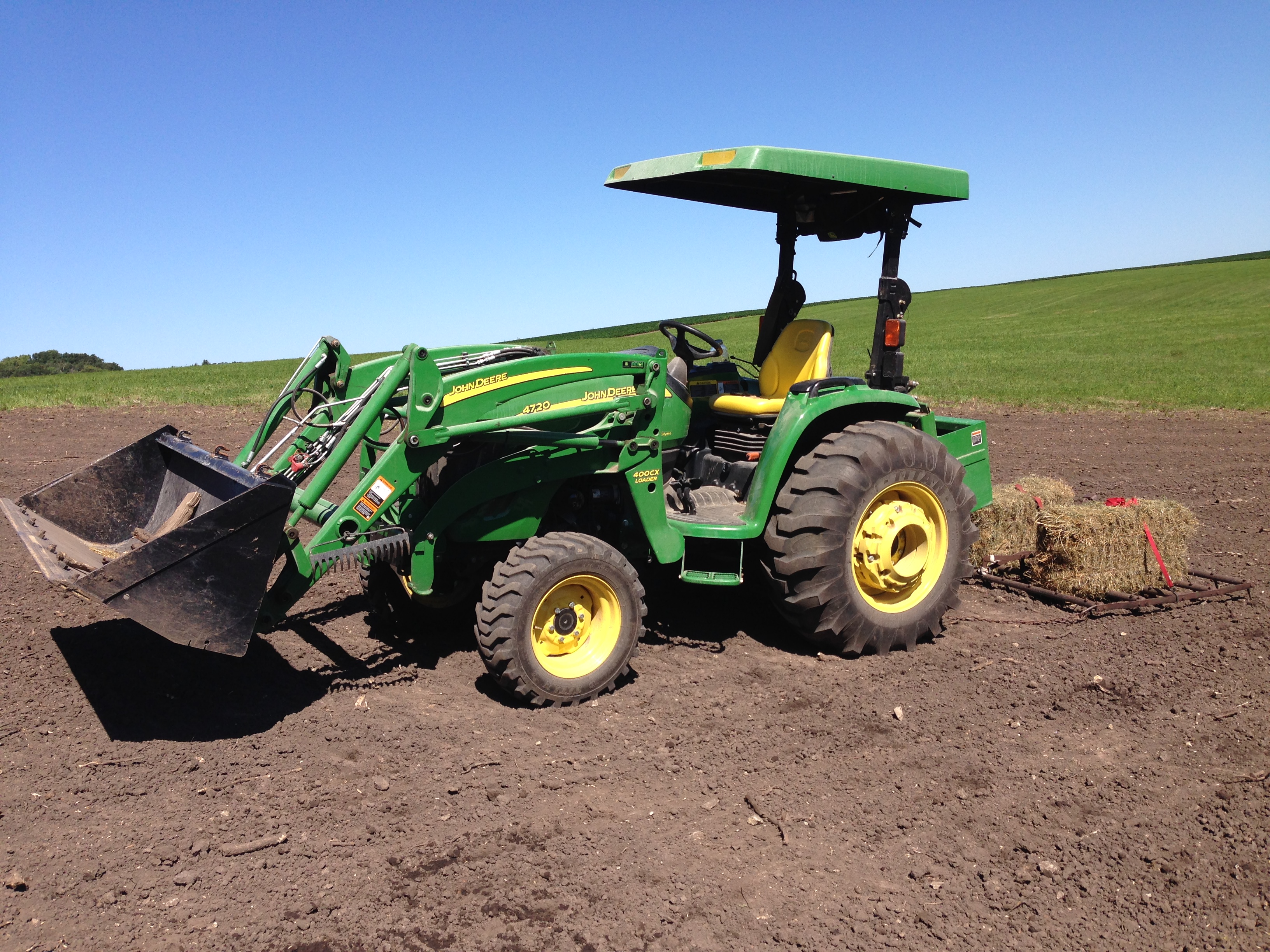

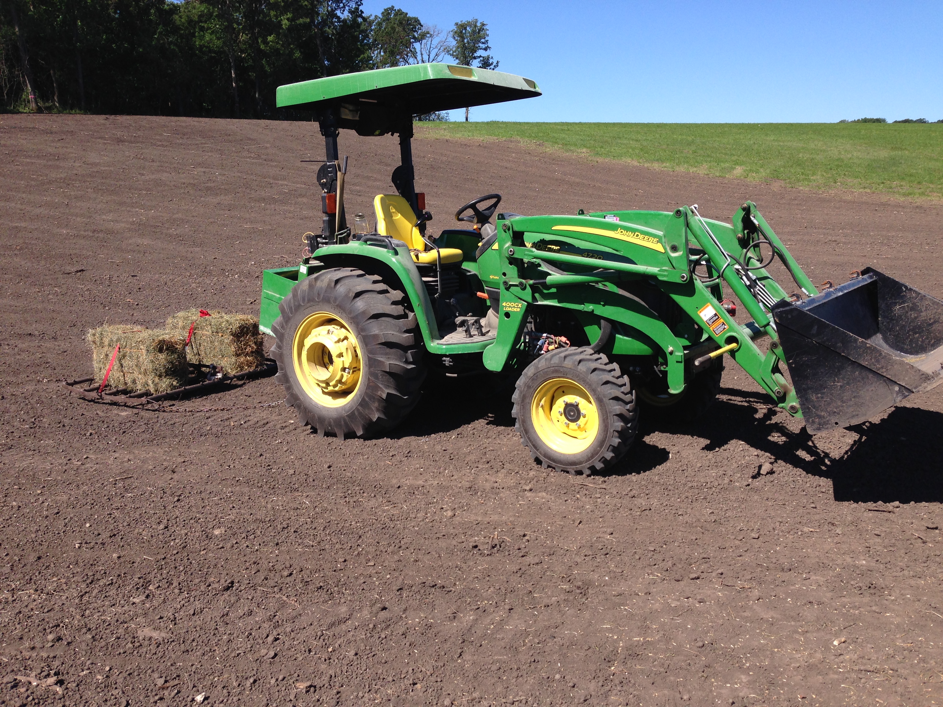

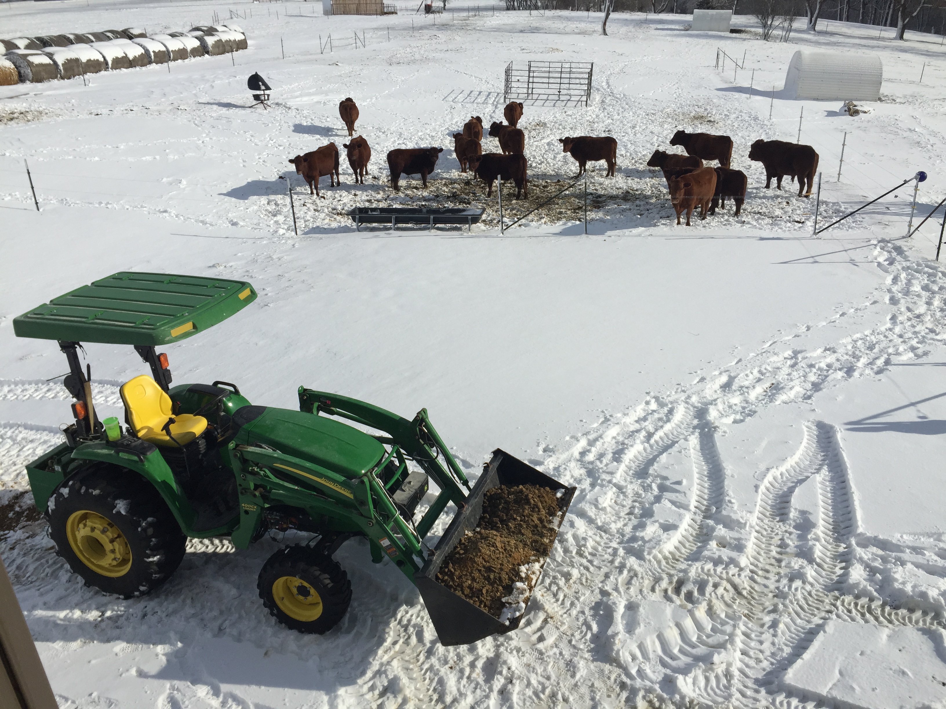

Thanks for the info. I think that'll work. Do you have any pics?
/ New 4066R with SSQA
I meant pictures of your tractor with this bucket on it
/ New 4066R with SSQA #9
You probably meant MY tractor, not HIS tractor:laughing:
/ New 4066R with SSQA #10

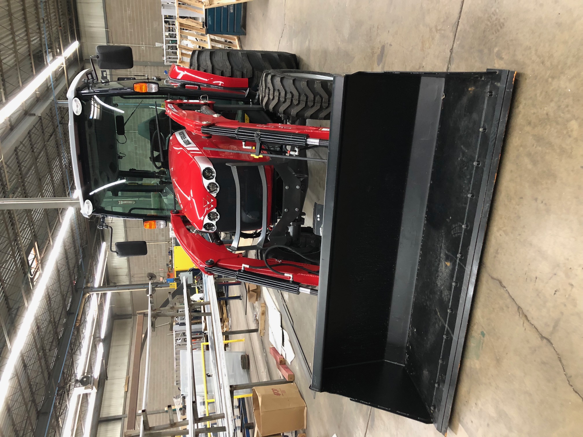

I did order my Massey with the HD bucket which is just a skid steer bucket. Even says "Type: SKID STEER" on the label
