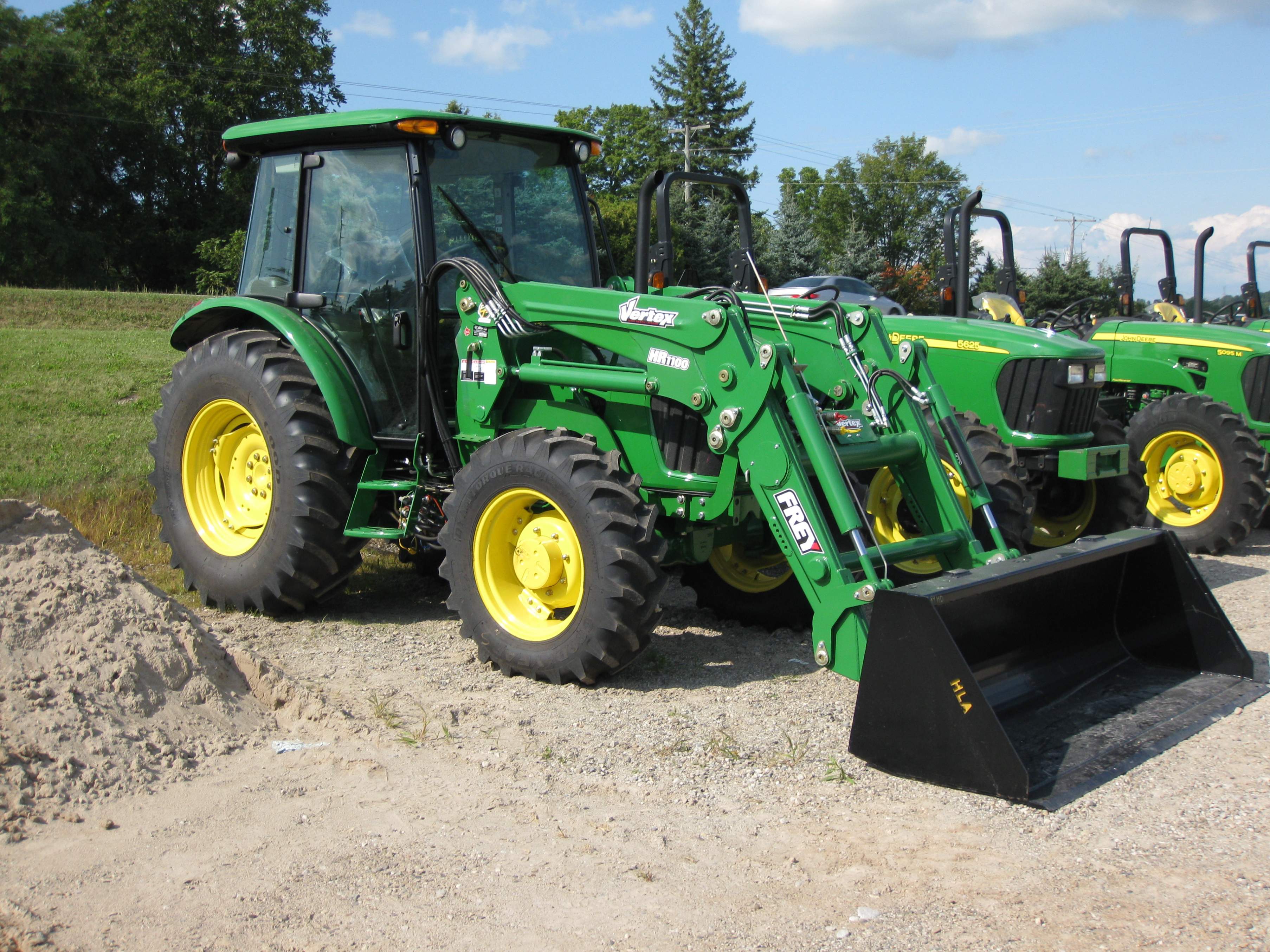

Island Farmer Could you explain why you didn't like the Goodyear/Titan Dyna Torque's that you originally had. [/QUOTE said:
Hey Island,
The reason I didn"t like the Dyna Torques in particular is because of those little "half" lugs they have. If I'm payin' the bucks for radials I want full beefy lugs like most ag radials have. Bigger lug = more life (hopefully). Plus the dealer had a low hour, less than 600 hrs.,mint 5X25 there and the Dyna Torques looked pretty hurtin'. I was not impressed.
Size wise they just looked wrong when I stood back and looked at it with the loader on. Didn't like that either.
Lastly, while playing with the loader in the dealer's sand pile they were diving like crazy, even at max pressure. I figured I'd pop one sooner than later so might as well up the load rating right then.

Is that Frey loader self leveling? The mechanisms look pretty interesting:thumbsup:

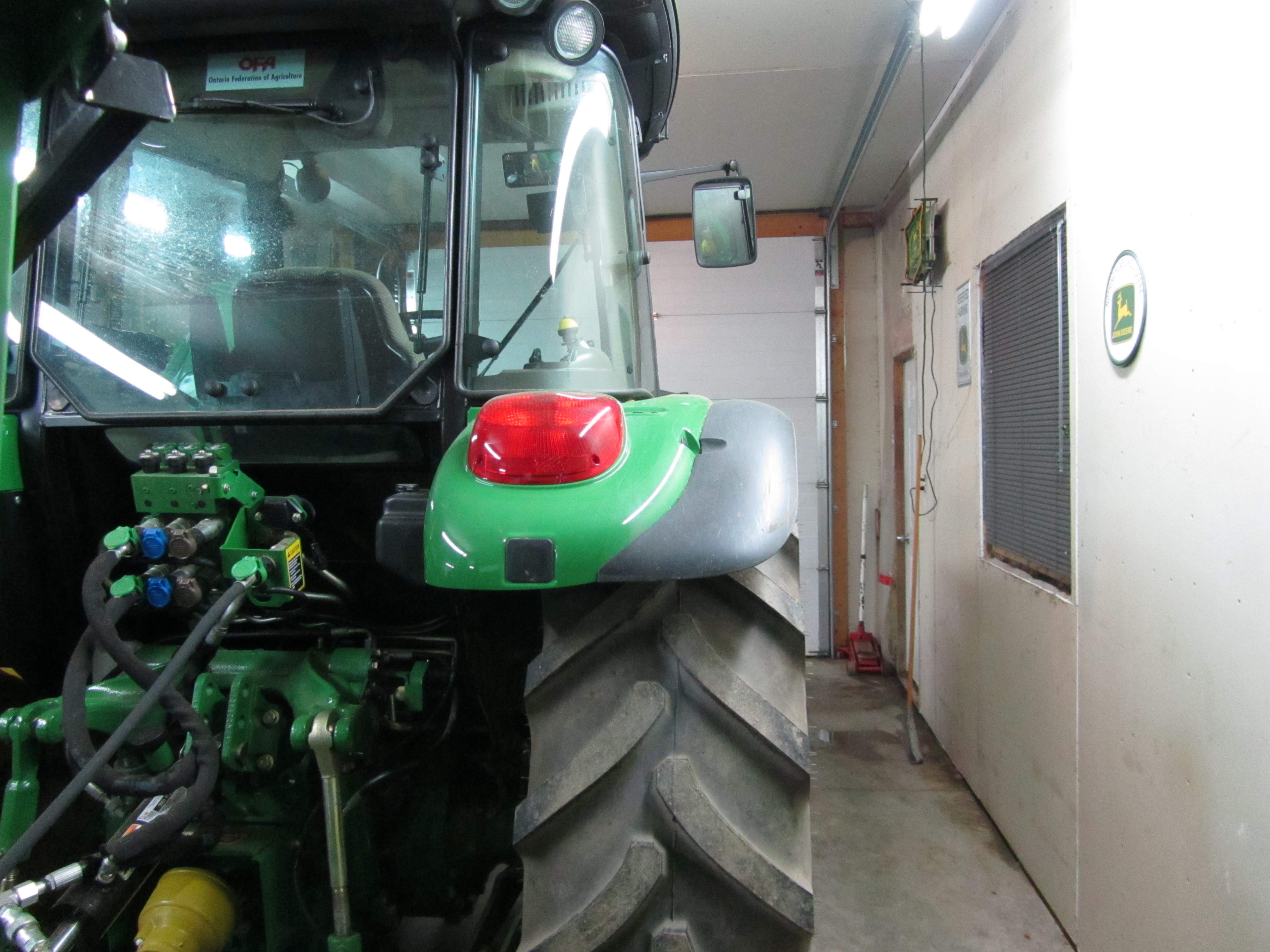

Tom (Caledon Hills),
Thanks for that information, it makes sense to me. Your Firestonse that came off the 6 series front and back are about 4" taller than the Goodyear radials; have you had any issues with them? You said that the rears are no problem under the fender, the closest point is a few inches from the step. What about the fronts, if they are turned all the way, do the tires rub on the frame?
Also, you said that you liked the new Multibibs, do you know anyone that is using them. One thing that I have read about the Mulitbibs is that you should not put a full load of 75% RimGuard in them. And, it might be preferable to just have wheel weights, any thoughts about this? What's your ballast, fluid or weights, or a combo?
Thanks for you advice,
Dana
I made the rears even with the rear fender extensions to keep the crap down,
then brought the fronts out even with the rears while planning to adjust the steering stops. I lucked out, even with the 14.9-24s cranked all the way it cleared the side frames by about an inch at the factory steering stop setting for 12.4-24s! No issues at all. It's been perfect.
I read my earlier post about the factory available Michelins. I messed up on the size of the rears. They are 16.9-34 and I'm pretty sure they are they're Agribibs. I saw the 13.6-24 and 16.9-34 Michelins on a 5095 a few months ago and it looked really good. I'm very partial to Michelin and Firestone ag radials and in my opinion you will not go wrong with either one.
If you and pclausen decide to go wider you will increase your turning radius from the increased ground contact and having to adjust your stops for frame clearance but you can widen your stance to offset this.
Mine is 84 inches outside front and rear and my loader bucket is 85 outside so this combo works really well.
Not a fan of liquid, I hate leaks. I realize sometimes you have to use it but it's not for me. Have 200 lb. of iron on each wheel and gonna add another 200 each. I ALWAYS have something hanging off the three point so I haven't had an issue yet.
If you guys do change your tire diameters, get your dealer to reprogram your chassis control unit with the correct circumference, address 111 I believe.
It's just a little thing but it keeps everything accurate.
Any other questions just let me know.
Regards,
Tom
Yep it's self levelling and it straightens out as you raise it so at max lift height you get considerably more vertical distance. It's also built very heavy duty.
Tom
