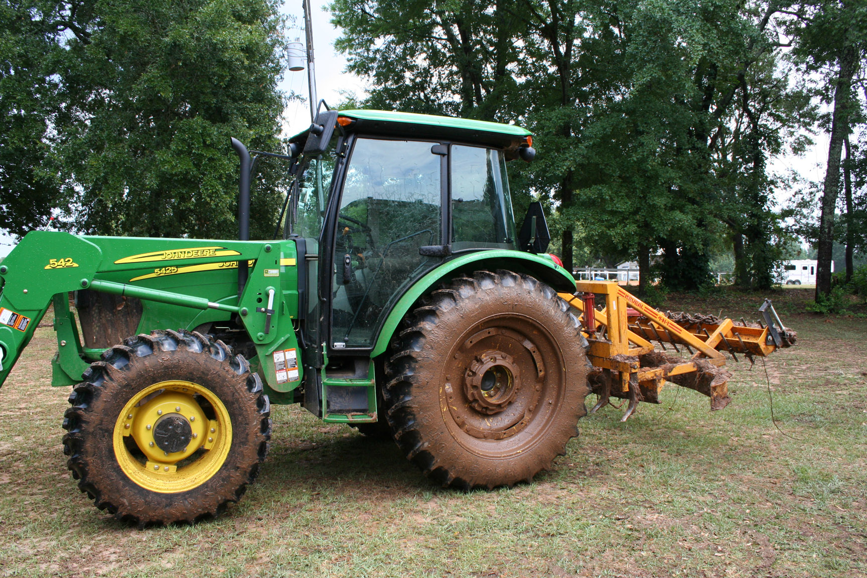

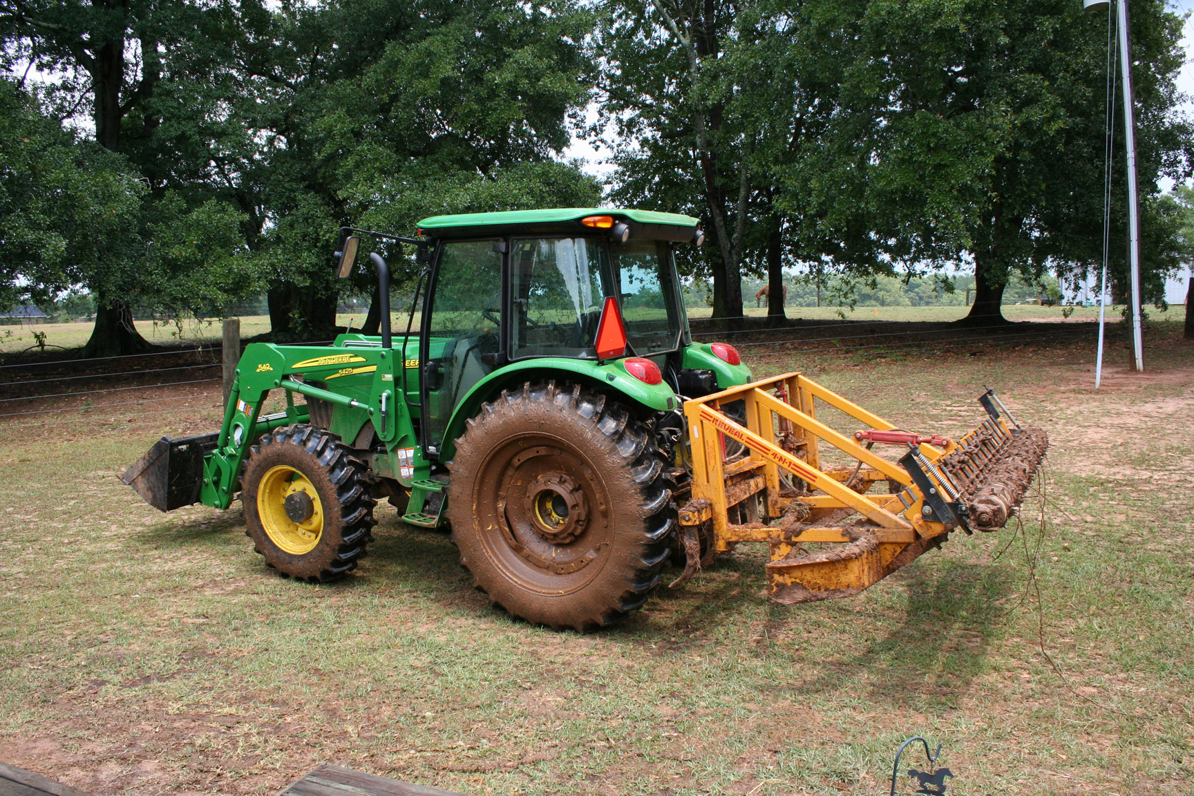

The 5425 certainly out works the Kubota M6800. I am surprised at how much more work it can do at a lower rpm. The M6800 never felt like a slouch, but compared to the 5425, it is. :D We got a thunderstorm today, and I was able to keep working. I love the cab!
Poor tractor got a little muddy.

   / New 5425 #63
Hey tjkadar, my 5425 had an issue with the lift pump or something in the fuel system that caused it to sputter at times. It happened right at the expiration of my warranty. My dealer was really cool about it. Somewhere on here I posted what he did. He put the 5525 fuel system on my 5425; essentially making it a 5525. Better yet, since it was then out of warranty, the tech even turned that pump up a bit. :)
I can now turn my 8' bush hog through areas that haven't been touched in several years with the tractor in the "economy" mode without it bogging down any. I have the skid steer bucket like what you have but in the 84" size. If I don't have the loaded set of wheels on it, I get really light in the back with a heaping bucket full. However, when clearing areas I really like having the much heavier bucket. Other than that, my tractor is pretty well exactly like yours. Well, I managed to tear both outside mirrors off... but that's my own fault. :eek:
Good luck with your tractor. I'm curious if you ever have to not use the "economy" mode when using your PTO. Since my 'upgrade', I only use "economy" when using the PTO. It really saves on fuel as well as noise.
   / New 5425 #64
Good to hear the 5425 is working out well, continued good luck with it. The JD engine is about 75 cu in. bigger than the Kubota, so it makes sense that it outworks it.
What transmission is in your 5425?
   / New 5425
#65
Dargo,
I've only used the economy mode PTO setting with my 8' hog. Worked like a champ! I forgot to take it out of economy mode, so for a couple days I was limited to 1,700 rpm. :D Once I took it out of economy mode and had full throttle, WOW, what a difference!
For those that don't know it, you are limited to around 1,700 rpm when the PTO is set to economy mode whether the PTO is engaged or not.
I read your post before I bought my tractor. I'm curious as to what it would take to bump my tractor to a 5525 once the warranty is over. :D I think that would be awesome.
An 84" bucket... I bet that looks huge on the tractor! :) I now have bucket envy.
Harold,
I have the 12F/12R PowerRvser. Transmission is a step above the Kubota's. It engages smoother, has a shorter throw between gears, and in general has a better feel to it.
