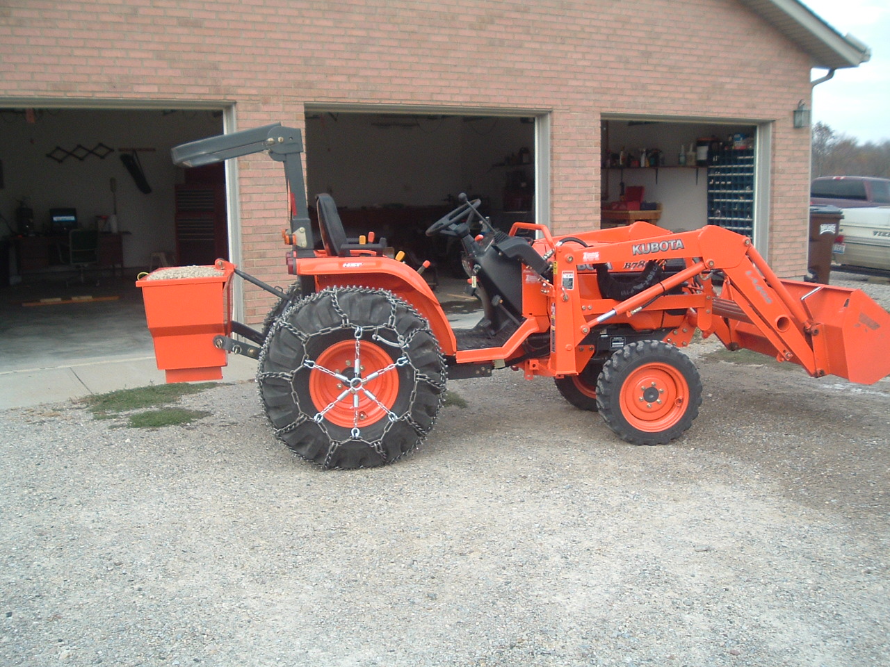

   / New Aquiline Talon tire chains! #40
Some like chains with a little slack in them. Some like them tight and tucked. I like them tight and tucked. Loose ends safety wired. These are Aquiline Talons with spring tensioners:
