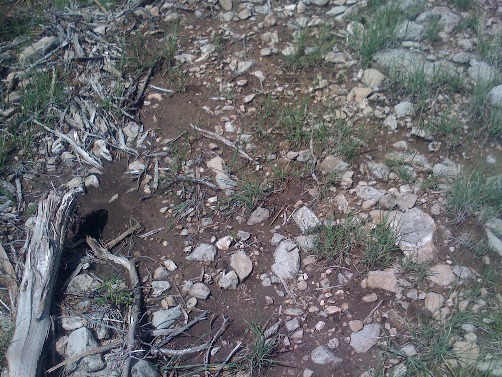

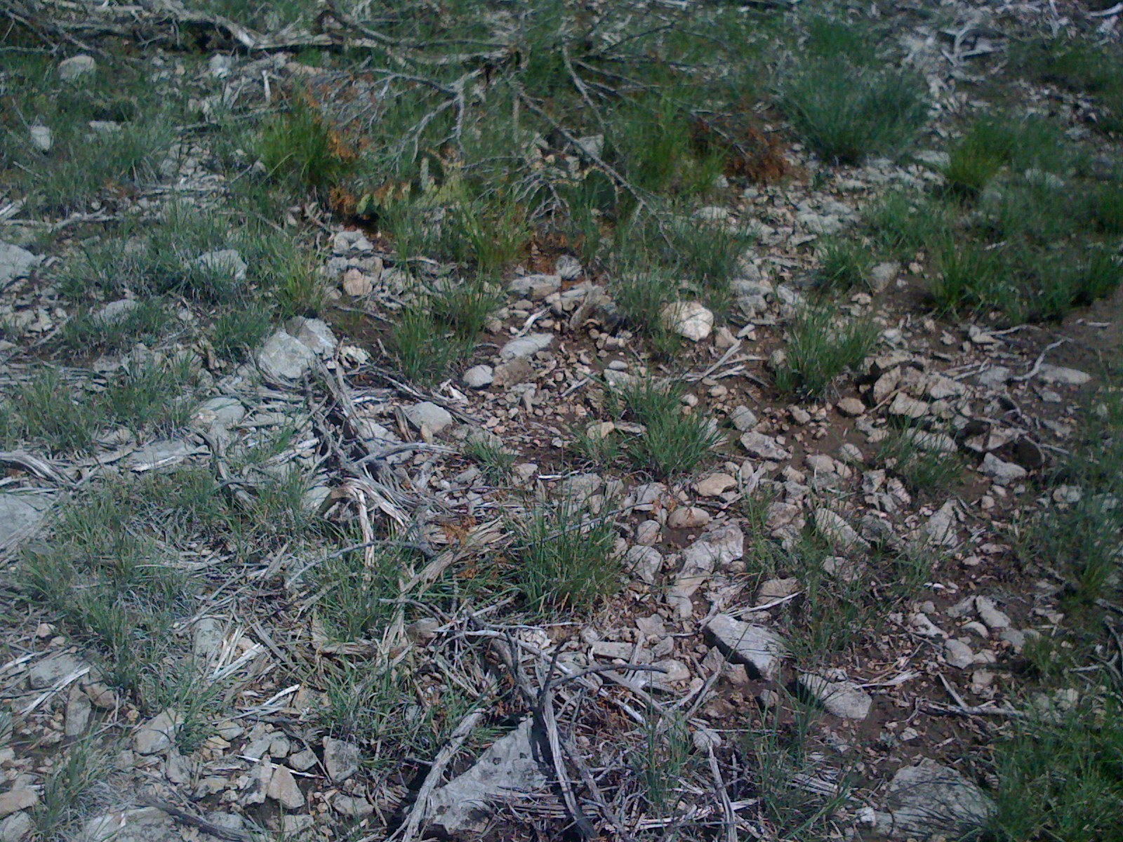

I know you guys do not like the carbide tools but how do you think those planier teeth will last up here in my neighborhood? I am afraid that they would not make it to lunch on Monday.

cbturf how well is your carbide tooling holding up in that environment? I was thinking about using the FAE's viper teeth on my FAE, but rocks and worse yet the scrap metal that lurks like land mines no matter how much you look for it make me reconsider.

300-500 hours depending on how many times I hit the ground.
I am paid by the acre and I must cover at least 5-6 acres per day to make what I want to. Excavators have their place but they will not be productive enough for my current contracts. I am thinning juniper trees and they are about 10 feet tall and 15 feet wide. You guys know that I have tried them all and for me the best machine combo will be one steel track crawler and one rubber tire machine.
   / New ASV PT-100 forestry package #49
I would think you would not want to make any more ground contact then you could help. The limestone around here is not to bad on carbide teeth but half buried car frame or engine heads are another matter. I try not to find that stuff with the carbide head if I can help it. The fail shredder is a little more economical and forgiving for scrap iron mining.A big rubber tire machine I would think would be the choice I try. Rocks like that are going to be hard on tires, track pin/bushing,teeth and ankles when you have walk back to the truck.
