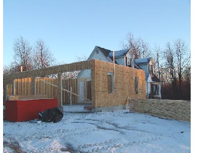

#21
Out of the snow!
/ New Attached Garage #22
Out of the snow?? Looks to me like it's parked in snow. /forums/images/graemlins/wink.gif Sure is a nice looking garage though.
/ New Attached Garage #24
Wow! It's amazing how fast that went up. Less than five minutes throught posts, and it's done!!
Seriously, that's REALLY nice. You DID you it right. Don't you have to pay a lot more in taxes since you made it connected to the house? Probably worth it though since you won't have to go out to get in. Thanks for the posts so far. John

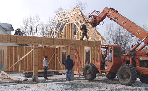

/ New Attached Garage #30
Nice Garage Chris,
I noticed the top of the trusses are "clipped", yet the roof line extends all the way up, why? and how? If you don't mind expanding our (my) knowledge base...
TIA
Dart
#31
The trusses have another section to make the roof line added after the fact.
Chris

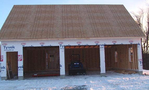

Roof on and doors installed.

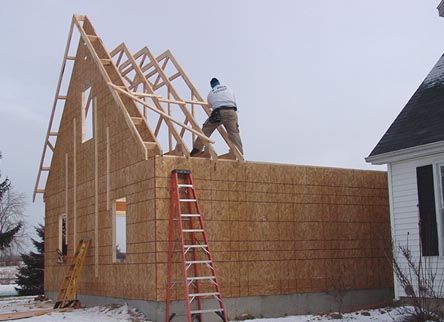

Pic of the room upstairs.
/ New Attached Garage #34
Chris that is one fine looking garage!
Makes me want another one /forums/images/graemlins/grin.gif

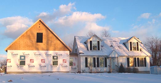

Finally got the garage enclosed,sheetrocked and heated.
Pic of the inside and overhead heater.

The siding is going up.
