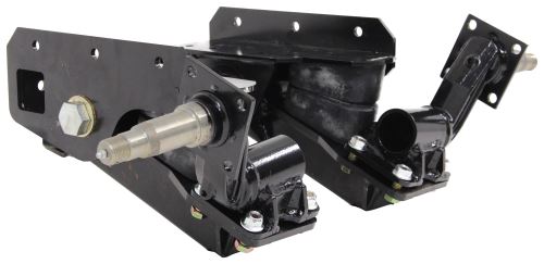

   / New axle #13
they are expensive but solves your "custom" axle issues
Timbren Axle-Less Trailer Suspension System - 4" Drop Spindle Only - 3,500 lbs Timbren Trailer Axles ASR3500S04
