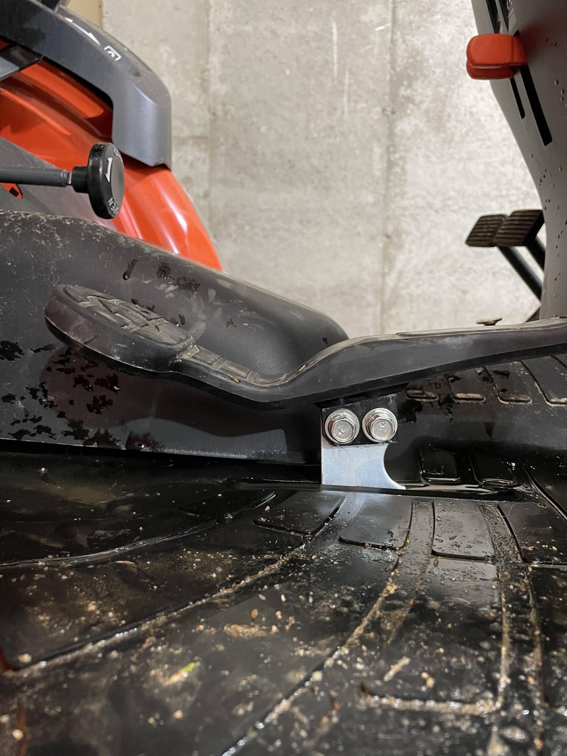

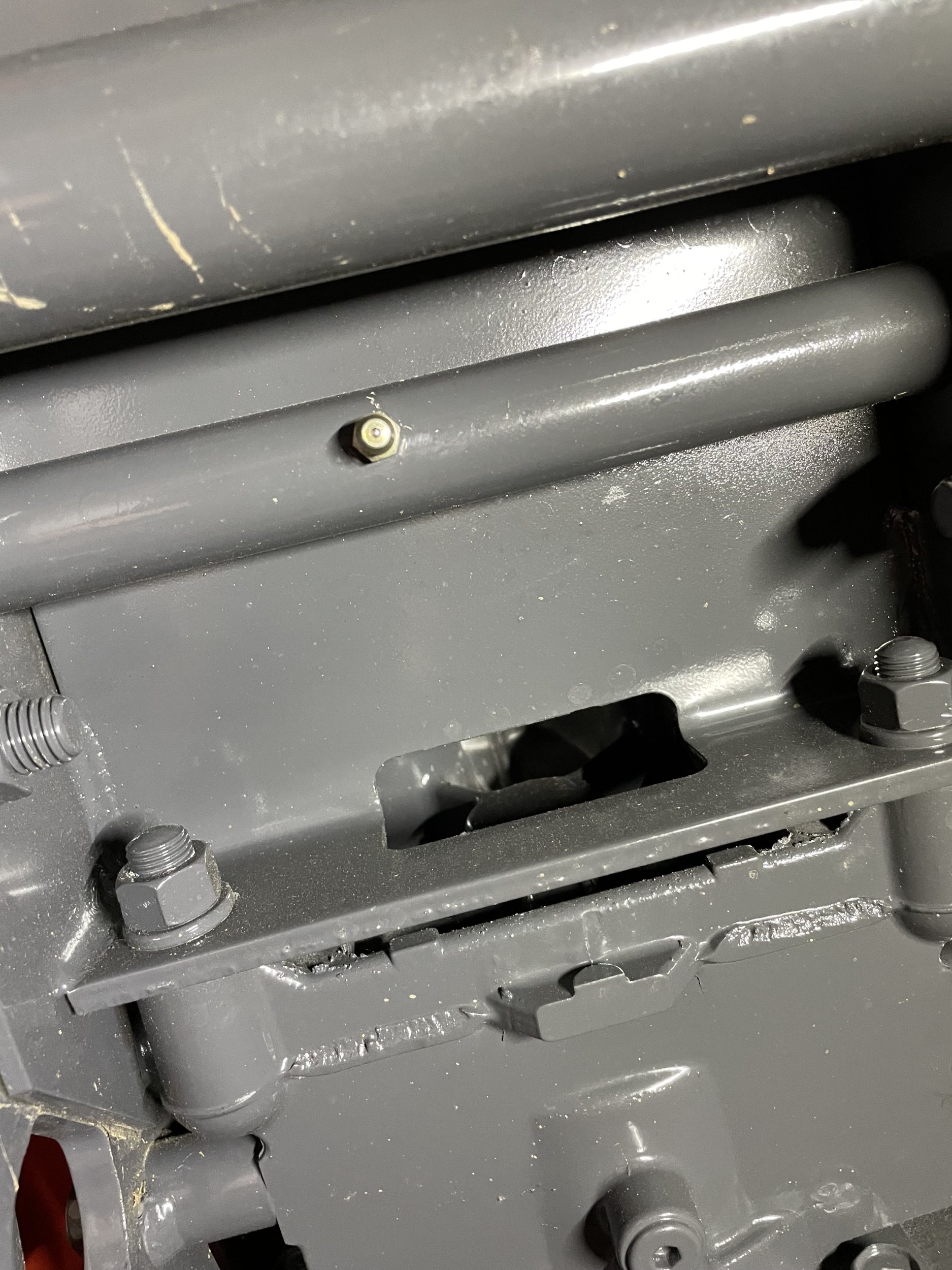

Folks,
Thanks for all the suggestions. This week I will be greasing all the fittings and looking at how to lubricate the treadle linkage. Also just acquired a larger torgue wrench so I will be checking all the lugs and nuts...
   / New B2601 HSD - Trteadle is very hard to push #15
I added a grease fitting and bent the back of the pedal up a half inch or so. Day and night difference.
