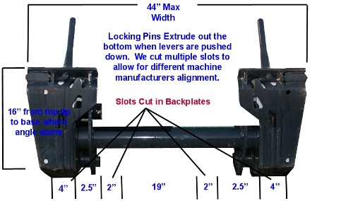

I suspect you'll have that QA well before everything for the B3350 comes in, so be sure to take plenty of pictures when you get it! :) I'm still rather curious how different it is dimensionally to a standard SSQA. It would be nice to know how easy or how hard it is to modify standard SSQA compatible attachment to make them fit.
The good news is that I sold my B2620 today, so there's no looking back now at this point! I'm committed to buying the B3350 no matter what! :)
The salesman said a couple of weeks or so before it comes in. Hopefully he's right. I've got a Virnig rock bucket on order too - that is setup for " real " SSQA - so one of my first orders of business is going to be adapting that rock bucket to work on the Kubota QA.
Somewhere I've got the specs saved for the SSQA stuff - I was planning on carefully measuring the Kubota QA and comparing it to the real SSQA to see where the differences are. I hoping it's something simple and they only changed one dimension. I guess I'll know soon enough. I plan on taking a bunch of pics and posting it all - so I'll let everybody know how it goes.
   / New B3350 #123
to my eyes, it looked the same height and was more narrow.
If that is the case, I could see how it might be possible to modify the QA adapter to fit both Kubota and SSQA attachments (with the addition of wings.) Of course, this would depend on if the pins align.

When I measure across the bottom end of the loader arms on the LA504 on my tractor - I come up with (approximately) 31.5 inches
I have the Kubota pin-on style QA on the loader, if I measure across that (outside edge to outside edge) - I get approximately 32.5 inches.
Looking at the image of the dimensions on an SSQA (from this page: Will it Fit My Machine)
It basically goes like this for the dimensions on the SSQA: 44 inch max overall width.
Then the spacing for the lockdown holes is: | - 4" -| 2.5" |-2"-| ...........19" .............|-2"-| 2.5" |- 4" -| (totals up to 36")
Kubota LA504 FEL arms position (approx): ........| -- |.........................................................| -- |
There are slots at the 4" interval and the 2" interval. The standard lockdown position is at the 4" spot - the 2" spot is for older Case skidsteers if I understand correctly.
So the problem is that basically the LA504 loader arms - come down right in the middle (sort of off to one side actually) - on where the slot is for the lockdown
pin on the SSQA. Looking at the pics from the B50 series brochure:
http://www.toplinetrailers.com/documents/B2650B3350.PDF
It's sort of hard to tell where the lockdown pins are physically located - but it sort of looks like they're actually located right in front of the loader arms. Which means the Kubota might have lined up their lockdown pins - on the standard location. Hard to tell from the pictures. This is all just speculation - hopefully the parts come in soon and I will know exactly what's going on here.

Thanks - just looked at that. It's hard to tell - because the video is shot from the side , but it does look as though the lock-down pins on the QA - are pretty much in line with the FEL arms . That is what Kubota would have to do - to get the lockdown pins to lineup with the spec'ed position of the slots
along the lower edge.
I edited my response #124 - my attempt at using text to illustrate the line-up between the LA504 loader arms and the SSQA lockdown slots - was not successful on the first try. Hopefully this is better.

Thanks for showing that. They didn't really zoom in on the loader QA that much - but right near the end they did get a halfway decent shot in passing of the lockdown pins on the QA - and they appear to be "outside" the loader arm. What that means is that it is possible that the lockdown pins at least - fall within the range to engage in the "standard" SSQA location (the 4" slots I detailed in post #124 ).
One of the responses earlier in this thread from Messicks indicated that the QA was non-standard. I guess we'll just have to wait and see what is non standard about it.

I'm hoping it turns out that it's just width issue. I think you could easily build a set of expansion wings on the outer edges without too much trouble. This would make it really easy to adapter standard SSQA attachments.
