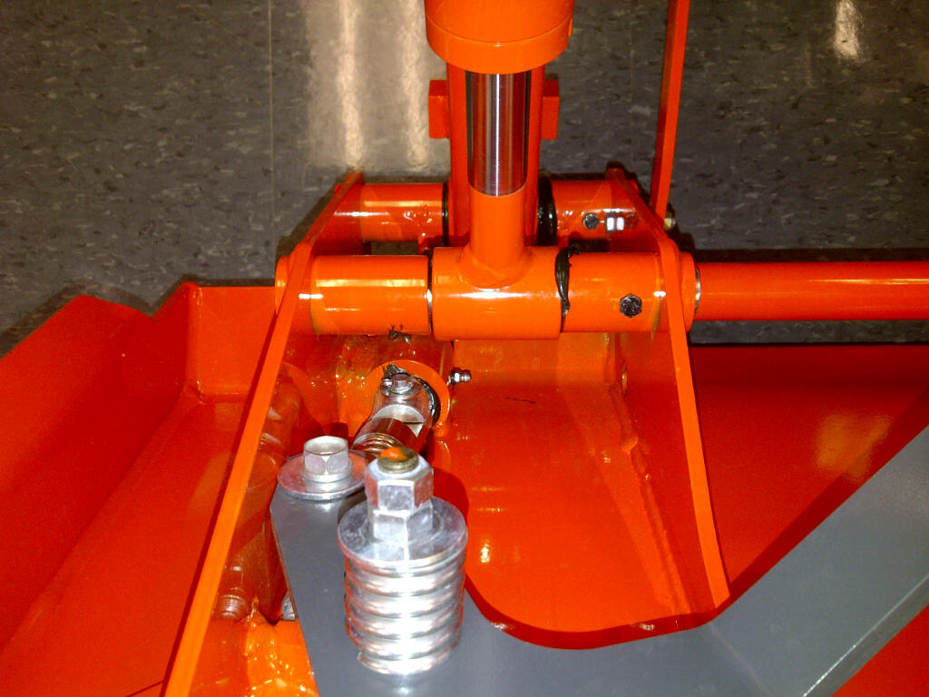

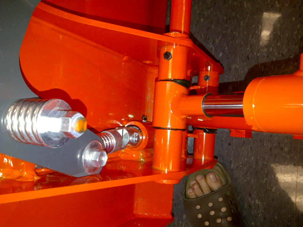

For the users who wanted to confirm the position of the pins in relation to the loader arms, see attached pictures. Also, the width of the QA pad is 44.5" and ~16" high. It was difficult to measure the height because of the curve at the bottom and the recessed notch at the top.

Thanks a bunch for taking the time to measure Kubota's new quick attach plate! So unless I'm misinterpreting the standard SSQA specs that were posted, this pretty much answers the compatibility question.

I figured as much once I saw the measurements provided by eb542. It just seemed really odd to me that Kubota would introduce a non-standard SSQA adapter when it could easily be made to fit that loader. Anyway, glad you got everything.
