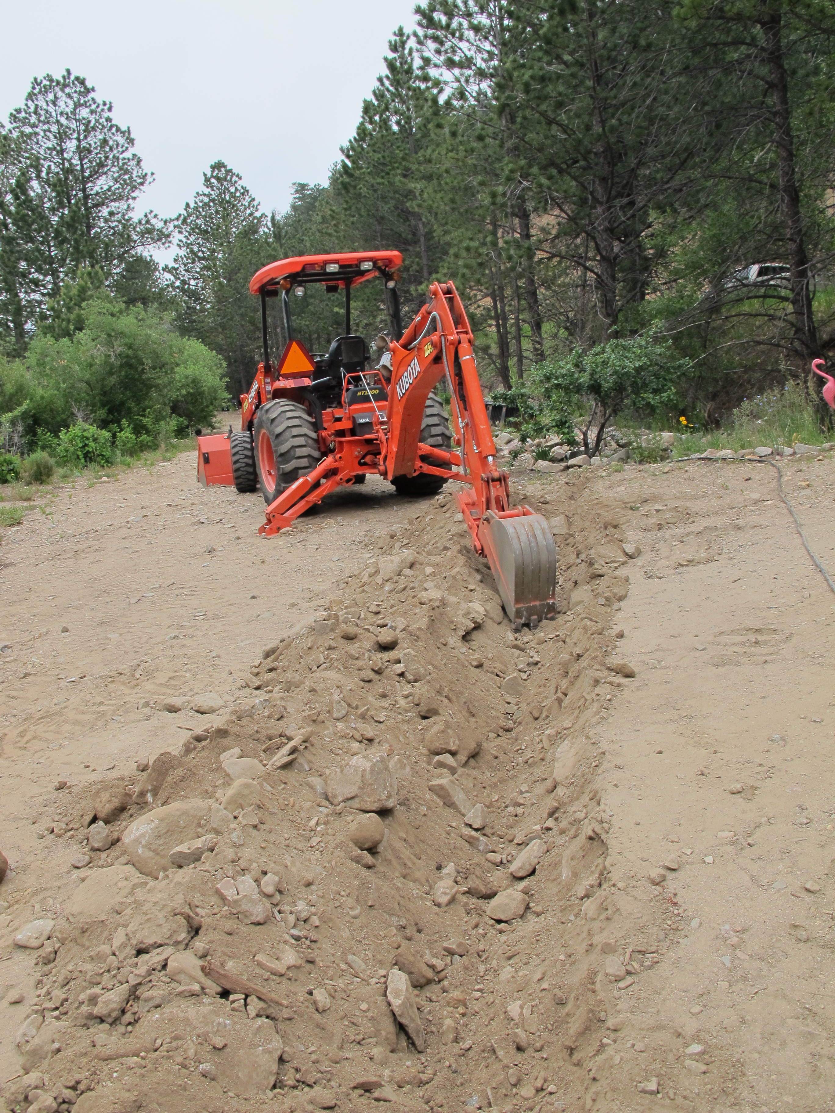

My question is about digging a trench. I need to dig one between two buildings for a footing. I can see how you'd start the trench from each building toward the center, but at some point, you'd be straddling the trench with no way to get out of there, right? Is there some technique for this that I might be missing? What's the right way to do this? Thanks!
Backhoes do have a learning curve. Sometimes it is possible to solve the trench straddling problem by simply not straddling the trench in the first place - just do all the work from one side.
Although backhoes are most efficient when using a single lever motion to bring the bucket in a straight line toward the lower boom pivot, they aren't required to be efficient all the time. By gently moving both levers simultaneously it is possible to dig in a variety of motions. One can dig arcs, or even dig a straight line from a position off that line.

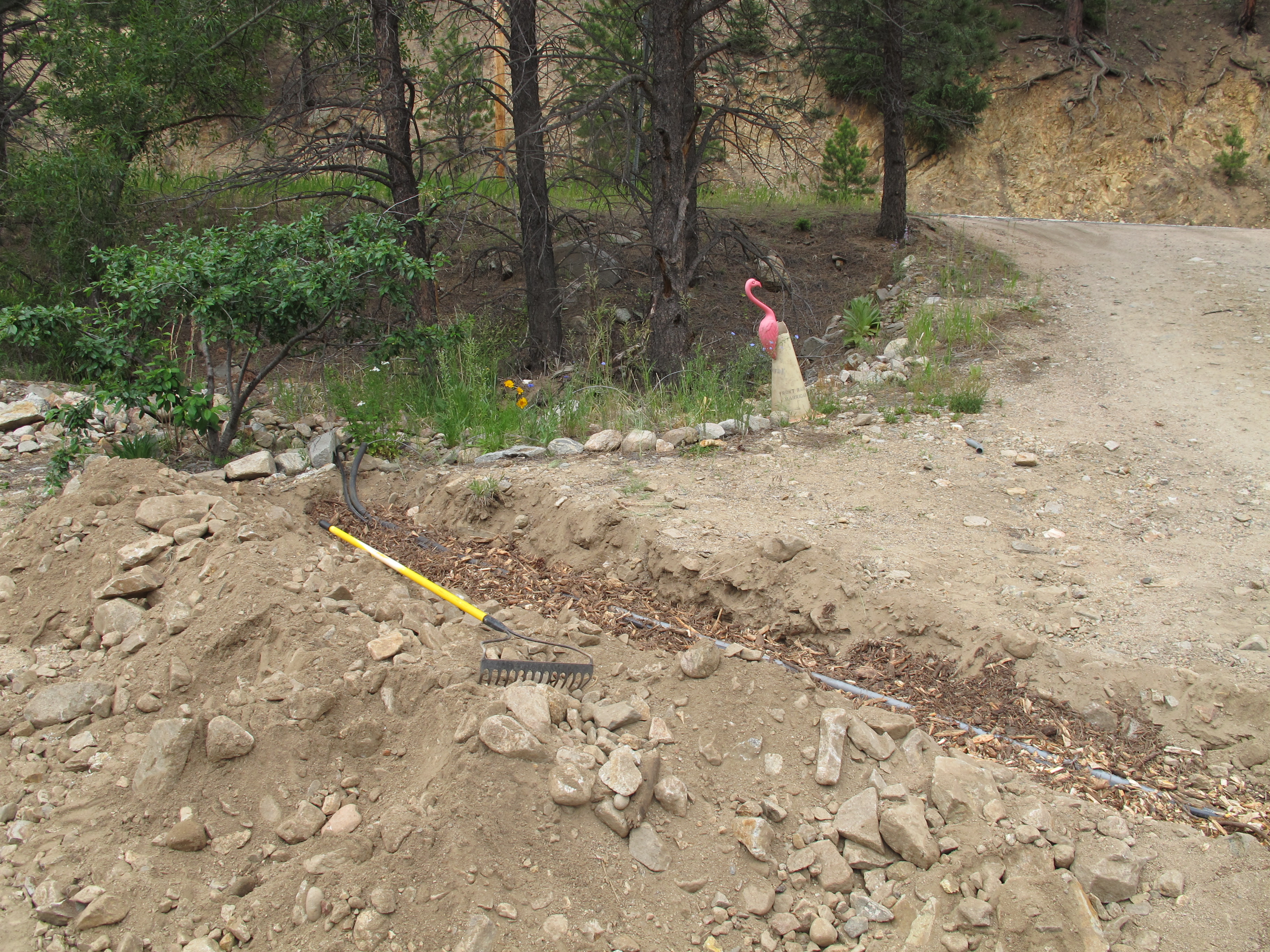

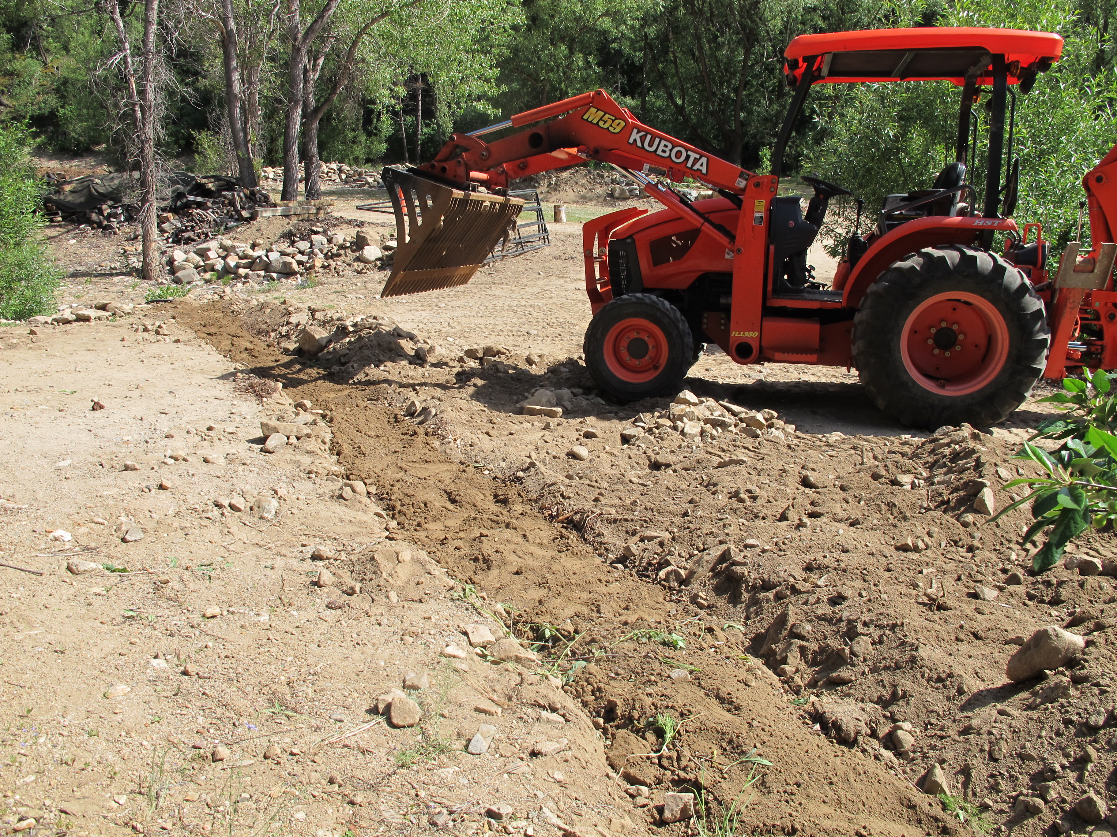

Here are some photos of a ditch we dug yesterday. It was completed entirely without ever crossing the trench. Although this one is fairly shallow, another trench we dug last week was much deeper. Same backhoe, same bucket, and same technique.
Enjoy, rScotty
