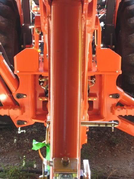

After much deliberation and deep thought trying to decide between a woods bh-80x and the bh-75, i decided to go with the kubota. many reason swayed me in this direction but mostly fit, dealer relationship, and price. on friday, the dealer dropped off the tractor with the new hoe attached. this was a very exciting and i was like a kid on christmas. so after the driver left i decided to try my hand at digging a simple hole, no roots, no rocks, no stumps, just a hole. i am not new to bh's but this was the first time with a brand new one so i wanted to be cautious. i backed up to a spot and extended the hoe all the way out and on the 3rd bucket curl i noticed hydraulic fluid shooting out from the bucket cylinder fitting (where it attaches to the boom). huh?? so I stop everthing and go have a look. from what i could tell the fitting was loose, figured the installer forgot to tighten properly, no big deal, i start wrenching it tight and realize the nut is scored pretty badly. hmm.. so i started looking closer and realized the dipper bracket was hitting the fitting when i extended the dipper all the way out.. on the left hand side there was over 1/2" of clearance but the right side was rubbing. there is a bracket that holds the fittings, so i figured they must have not centered it correctly so in an attempt to align it i loosened the bolts and moved it over as far as i could. the dipper bracket now clears the fitting but by less than 2mm.. then i start looking the unit over and realized when retracted the dipper is not perfectly in line with the boom. it seems to be slightly skewed to the left. the left hand ear on the pivot pin is bent out a bit more than the right hand ear and it appears this is the source. now i am not sure this has anything to do with the fitting issue but this doesn't look right. so i call the dealer to explain the situation and they are sending someone out in the AM to pick it up and bring it back to the shop.
Here are some pics to show what i mean.
Dipper hitting the right hand hose fitting:
clearance on left hand hose fitting:
Damage to fitting:
Dipper skewed left compared to boom - picture taken dead center behind tractor:
left pivot ear looks bent out a bit, i think this is the cause of the "skew"
so my question is has anyone else experienced this "problem"? Do you see it as a real problem or am i being paranoid? i know the hose fitting is messed up and obviously needs to be replaced but what about the dipper?? i am just wondering if the dealer is going to tell me this is within the normal thresholds a proper "fit".

Looks like the wrong hoses. They should have a shorter steel sleeve or have one that curves in a bit and travels towards the middle. Maybe they have them reversed and the other end of the hose should be on that side? Hard to say, but they will fix it. Either way it's no big deal, but I know it's no fun when a new machine is not working right.

That thing does look bent. I would say it got damaged in shipment somewhere.

Bigballer:
It looks like Kubota has put a shim or shims on the pin that
holds the dipper to the main boom. Is it on only one side?
That could cause the skew. My BT751 has shims like that.

the mounting plate for the hose fittings was replaced with one that holds the lines closer together, this gives it the correct amount of clearance. dealer said it was a bad part. hoses replaced as well.
they say the alignment of the hoe looks fine (sitting level on their shop floor). i am not sure about this, i did look at the alignment before they picked it up yesterday and it didn't look as skewed as the pics i posted show so we'll see, i'll have to get it out on level pavement and see for myself. maybe i am overreacting here or expecting too much but it seems like it should line up perfectly.

I looked at mine this morning and it is straight, it also has shims on both sides of the dipper boom although it does come real close to the fittings but it does not hit them, there is not much clearance on either side of them.
I would say the hoe was not set up and tested correctly by whoever was suppose to.

so far so good. they replaced the bracket (maybe it's a change on the newer hoes) and the alignment/clearance looks good. i do agree about the assembly. the owner of the dealership called me to follow up and i gave him honest feedback about the service post sale. i felt like he listened and appreciated the feedback and he was apologetic for the errors..
to further test the fix, i dug up 6 alder stumps after work and it seems to be working fine, no problems but i still don't have a level spot to check the alignment.. from where it was sitting when i got home it looked OK.
i am considering this case closed at this time.
