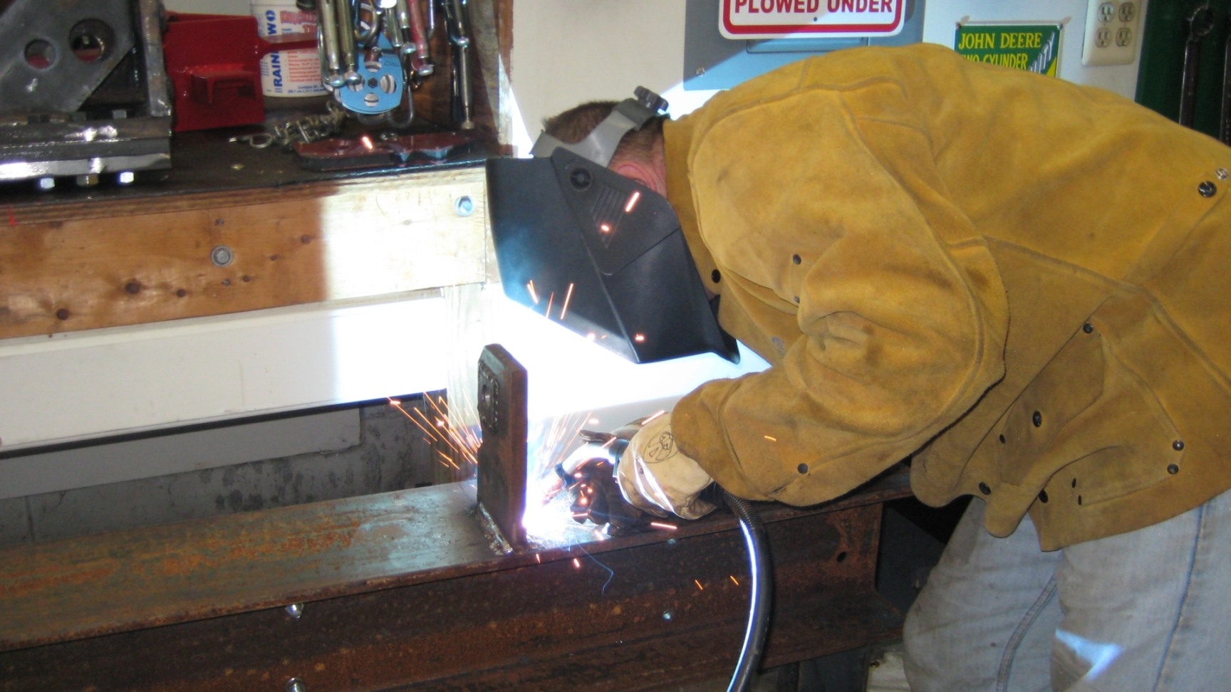

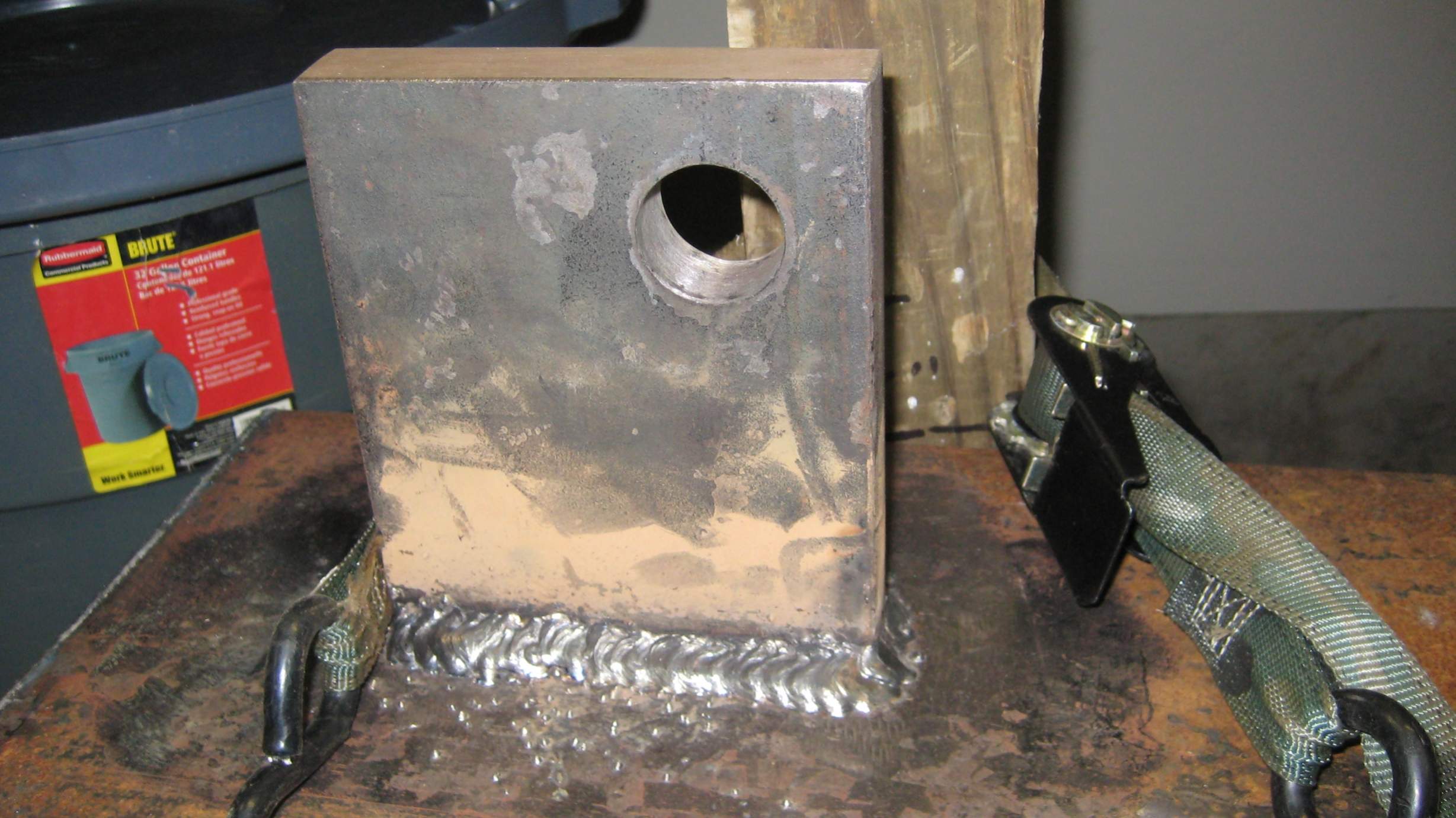

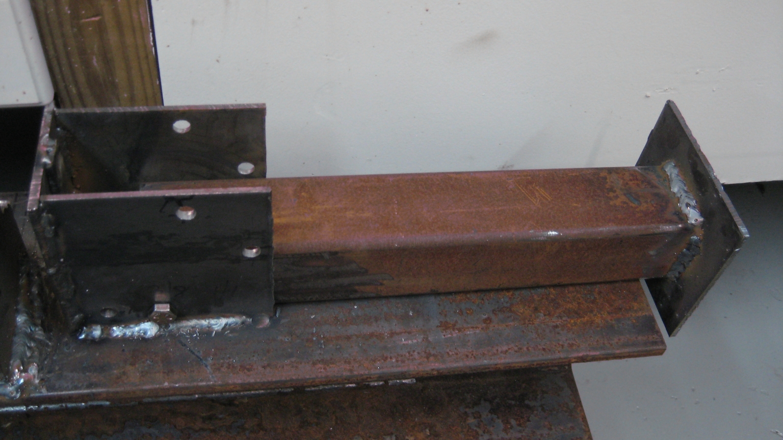

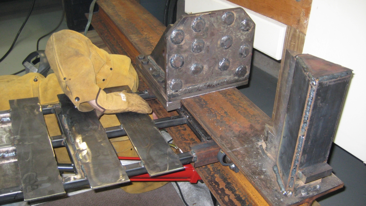

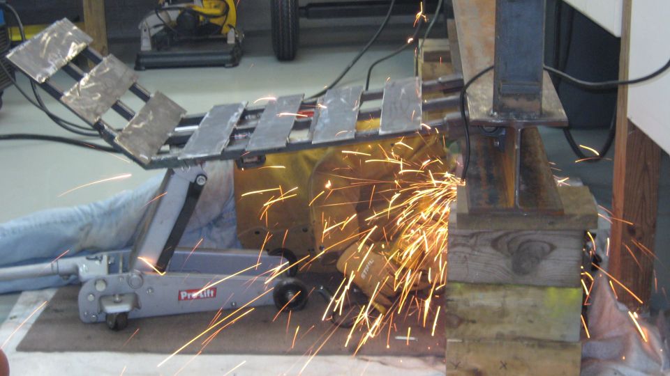

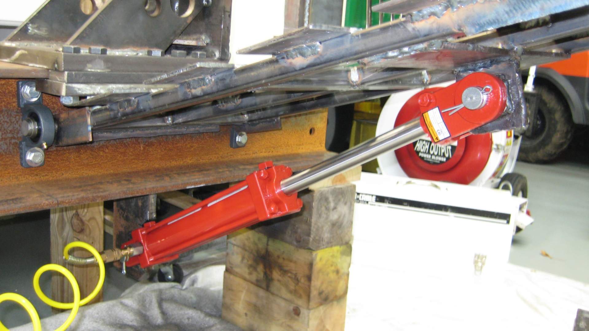

Ok, finally starting on the Big Ash Log and Limb Splitter. (BALLS)
Using some W8x40 beam. Got the log lift built and tested (with air). Wedge and blocks put in. I cheated on the push plate though... Bought a kit version of the plate from them. It is a monster!
Using a 5x24 Prince for the ram, 2x10 on the lift, and 2x4 for the wedge. Tomorrow I hope to mount the 25 gallon hydraulic tank.
I've got some good ideas for this from the rayco and Timberwolf splitters.
I'll post more pictures next time I make some progress!
Wayne

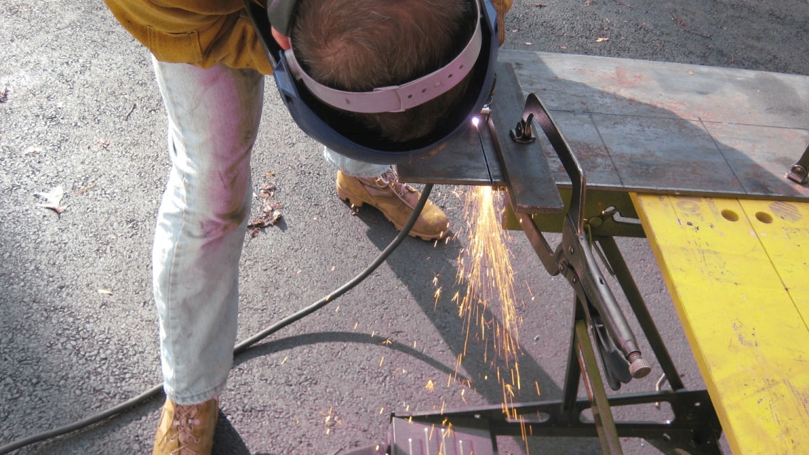

Kenny: The plumbing looks straightforward, just need to find a way to keep it all neat! The hardest part now is moving the beam around since I'd rather weld looking down, so I need to be able to rotate it. And every time I do more, it gets heavier!
Wayne

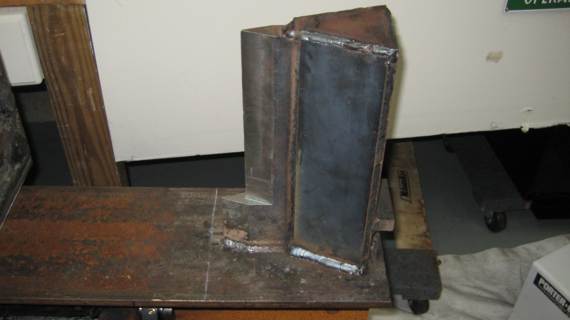

looks huge! can you explain the reasoning of the splitter wedge ? I see its sharpened until last 1 inch at bottom of beam. it sticks out and it sharpened there. I never seen this before.
   / new BALLS
Radioman: Good question. The vertical wedge is designed to have a slip on four way wedge to fit over the top. If you look at the Timberwolf TW-5, it will be the same wedge they use.
A picture of the TW-5 is here Timberwolf Wood Processing Equipment
Did not get much done today, the dog wanted to go out. At least the fold down leg that is on the wedge end is done. The splitter is upside down in this picture of course!
Wayne

Nice job Wayne. Does the wedge move up or down hydraulicly? It looks like it will be able to split rocks if you wanted.
Bill
   / new BALLS
The wedge that slips over the stationary wedge will move up and down. I copied the TW-5 and used a 2"x4" cylinder. Not quite how effective it will be, just seemed like a good idea at the time. For the slip over portion I bought a pre-built part from Timberwolf, pics later.

...The hardest part now is moving the beam around since I'd rather weld looking down...
I hear you. I've tipped trailers on their side before with my tractor loader to get the weld in the right position. I'll sometimes tack stuff together with the project in the correct orientation. When the project is assembled, I'll proceed to finish weld all the seams that are in the right place. Then I'll flip the project again welding all the seems that have now moved into the right place. Five more flips and it's back to the right orientation and ready for prep and paint.
