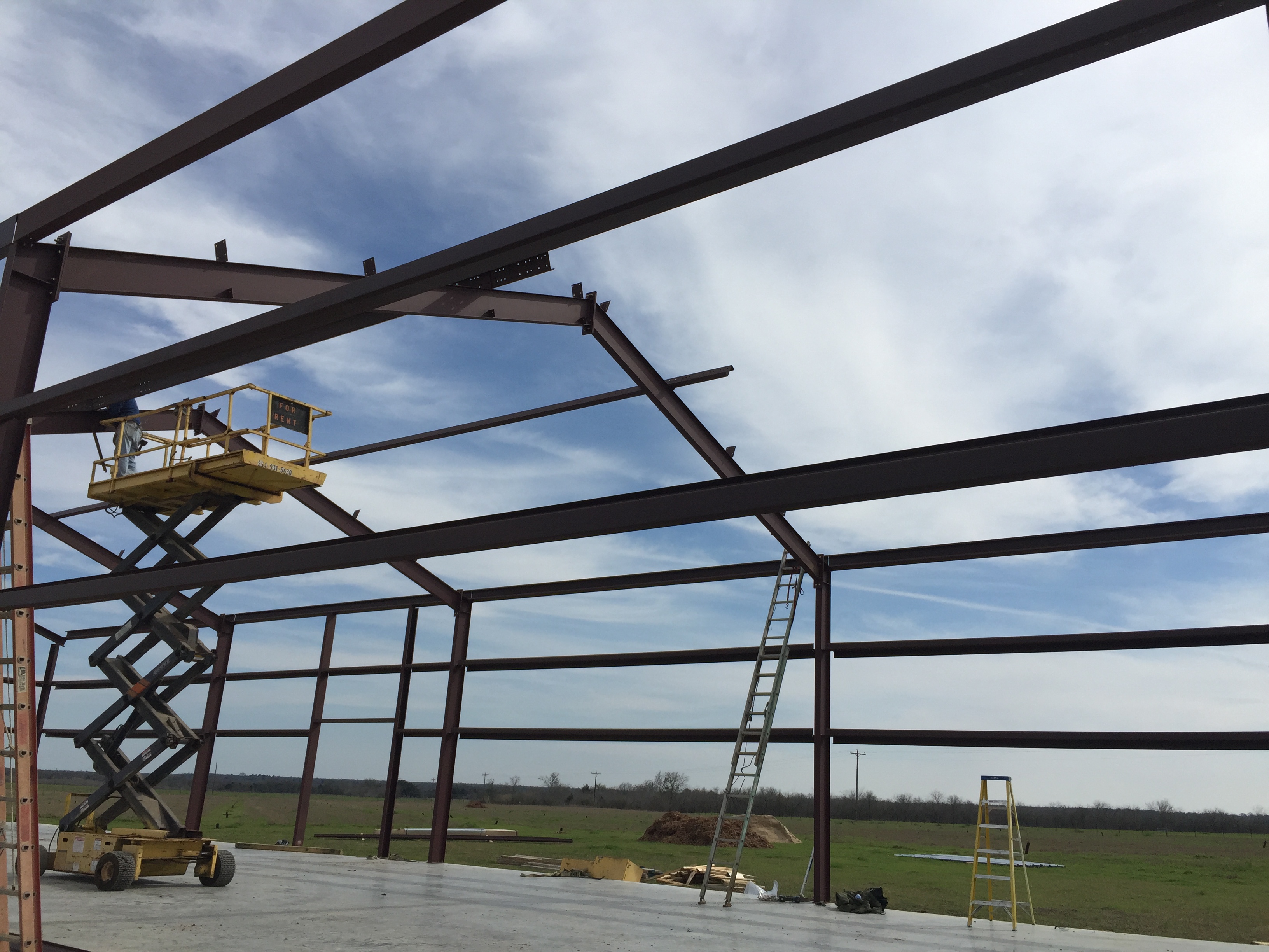

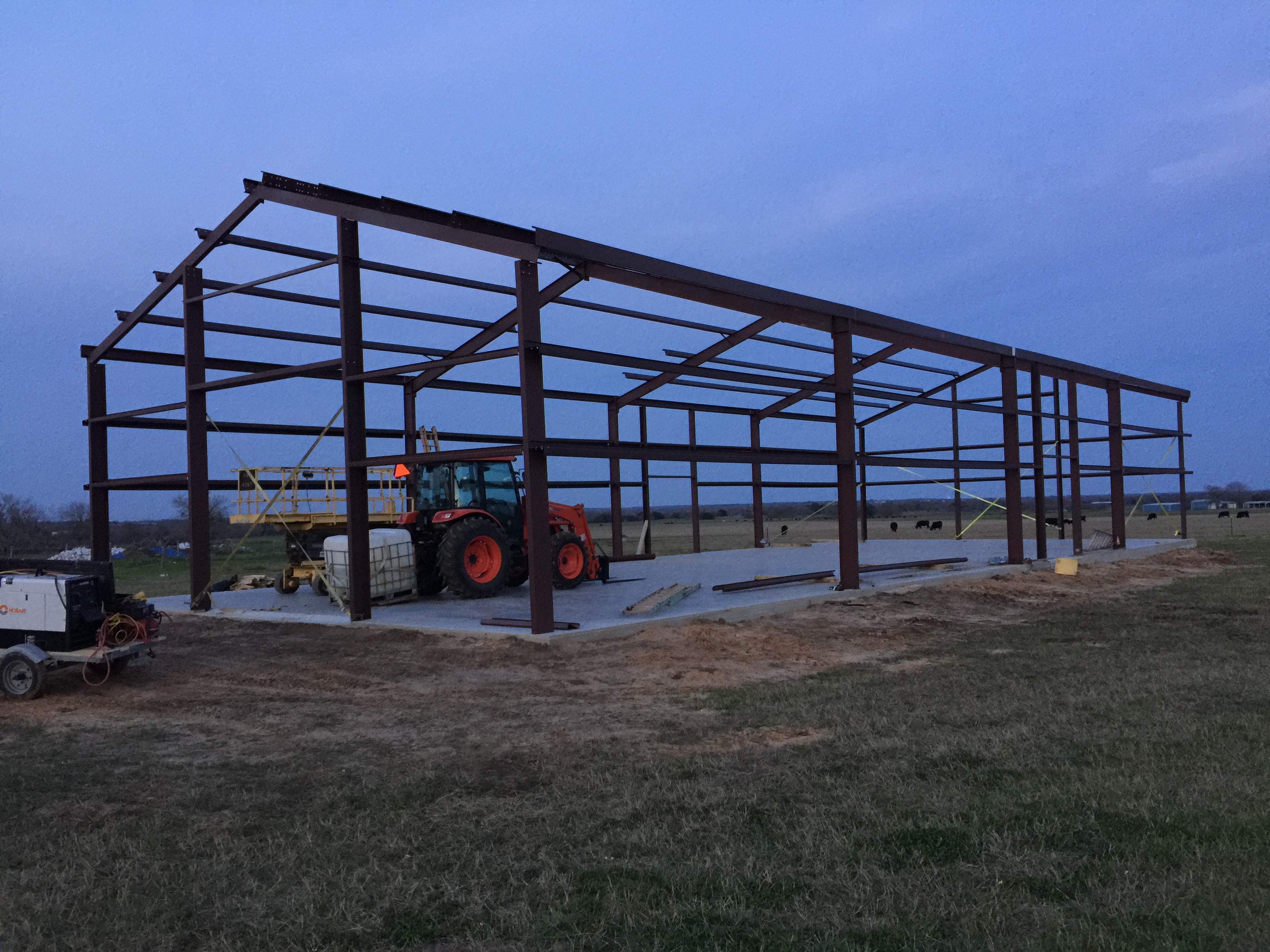

We got more done last Saturday (it was misting and windy on Sunday so I did other chores) - used the scissor lift to raise the main trusses. We bolted them together on the ground and then used the tractor to put them on the lift and then up, up, and away. It went a lot smoother than I had hoped. Spent the afternoon putting up roof purlins and braces and only have seven to go. Still have to square a few places up, but overall it is pretty good. I hope to start hanging sheet metal next Sunday.
