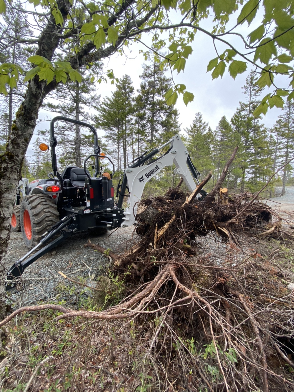

The backhoe worked admirably in picking up some of these root balls that were at the limit of weight, but can’t take credit for digging them out. They are left over from the contractor knocking down trees to put in my 700’ driveway.
I had cut up the trees and chipped the limbs earlier this year, but had been waiting on the tractor to remove the stumps/root balls before they killed all the moss and ferns this spring. Backhoe was able to drag them close and then lift them up onto to driveway for lifting with the pallet forks.

So a stump that was actually dug out by the backhoe, I was worried that this tractor might not do what I needed, but it is a beast!
