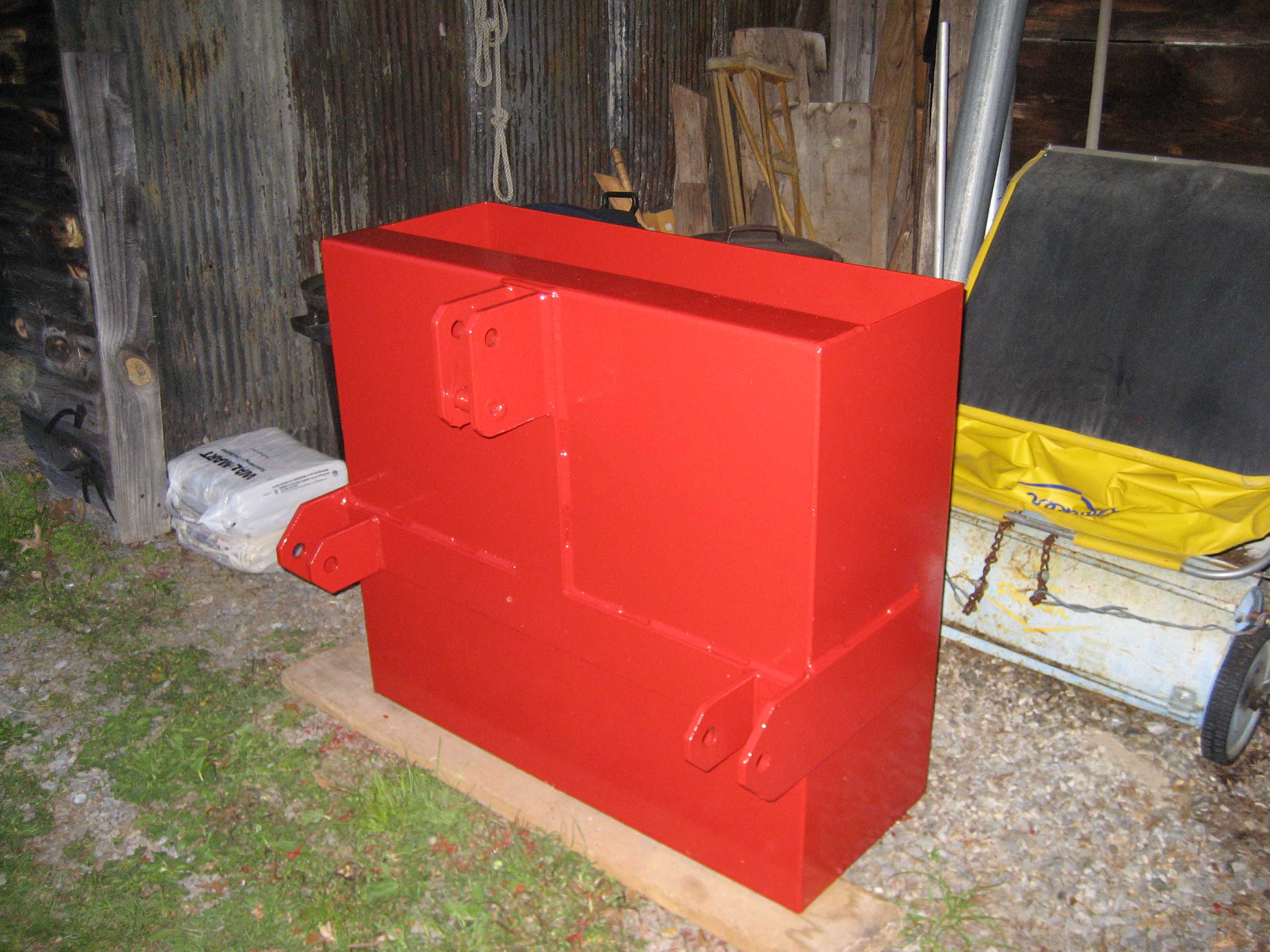

I'm glad to hear it shifting better for you, isn't it amazing how much that loader can lift I swear it will lift more than they say, that's why I suggested getting a ballast box. I was lucky I found mine at a John Deere dealer category two just sitting in a pile of mud I asked the dealer how much he told me to take it off his hands for $250 dollars I found out later they list out for about $1000 I got a really good deal just a little rusty so I got home sandblasted it and painted it red I know I should've painted it blue but I figured it would be easy to see at night, so maybe if you look around you might get lucky especially in this bad economy. I was just curious did you add any remote valves I had two installed one regular and one dent remote I wish I just put the third one on but I thought I had enough. Take care and have fun and let us know how those tires work out.

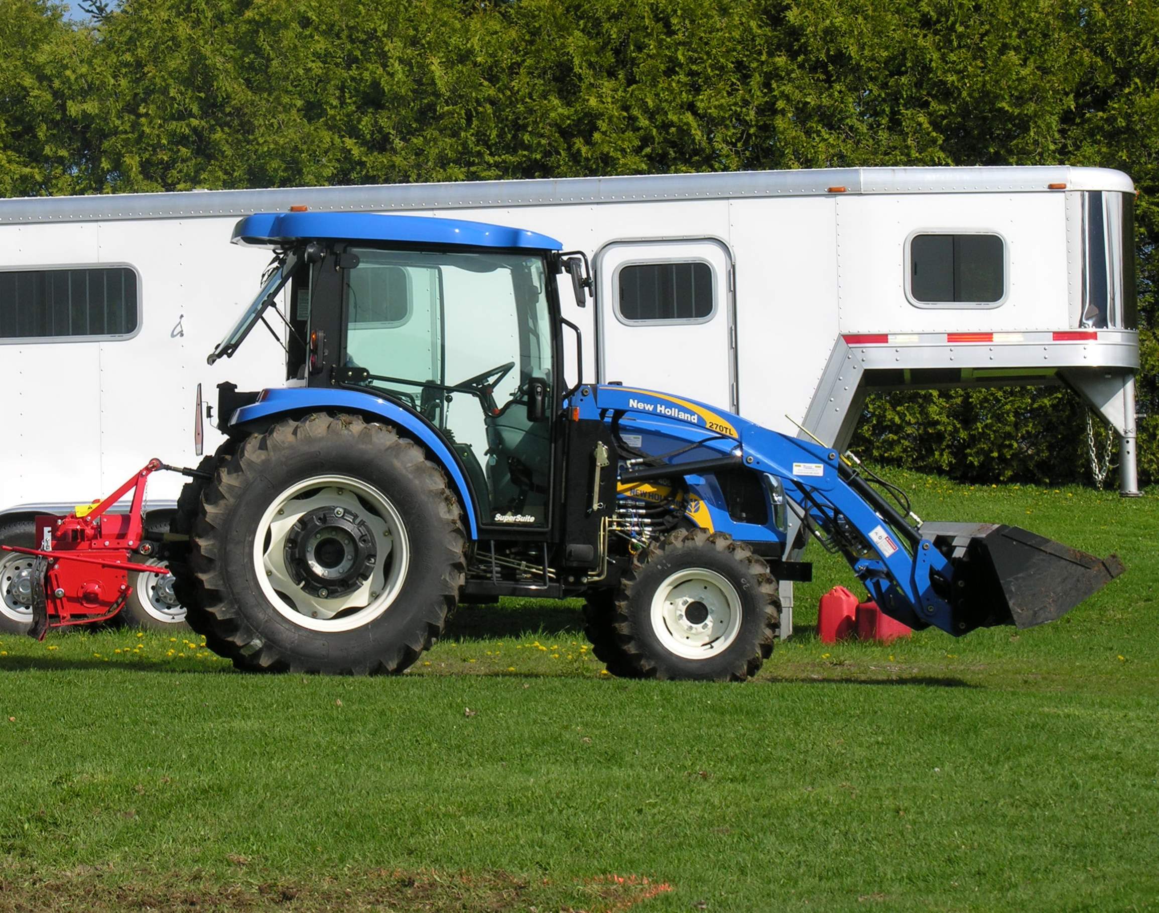

Boomer 4060 is new name for TC60. I think they just raised the boost on the turbo a wee bit to get the extra 5 hp from the same engine.
Weight box next on the list if calcium in tires does not help a bit. Maybe with filled R4's the extra volume will help offset the loader. The ag tires on it however are great for traction but feel softer under load than the R4s felt on my TC 45.
