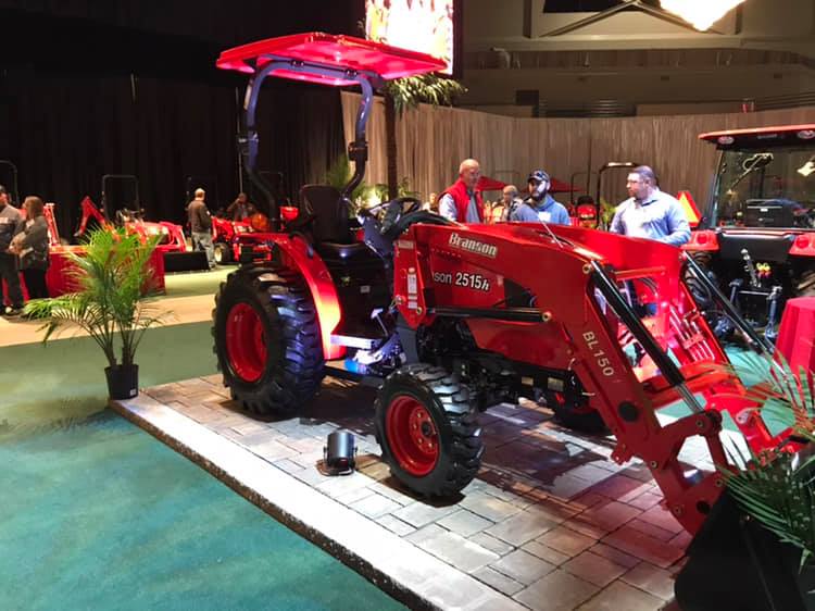

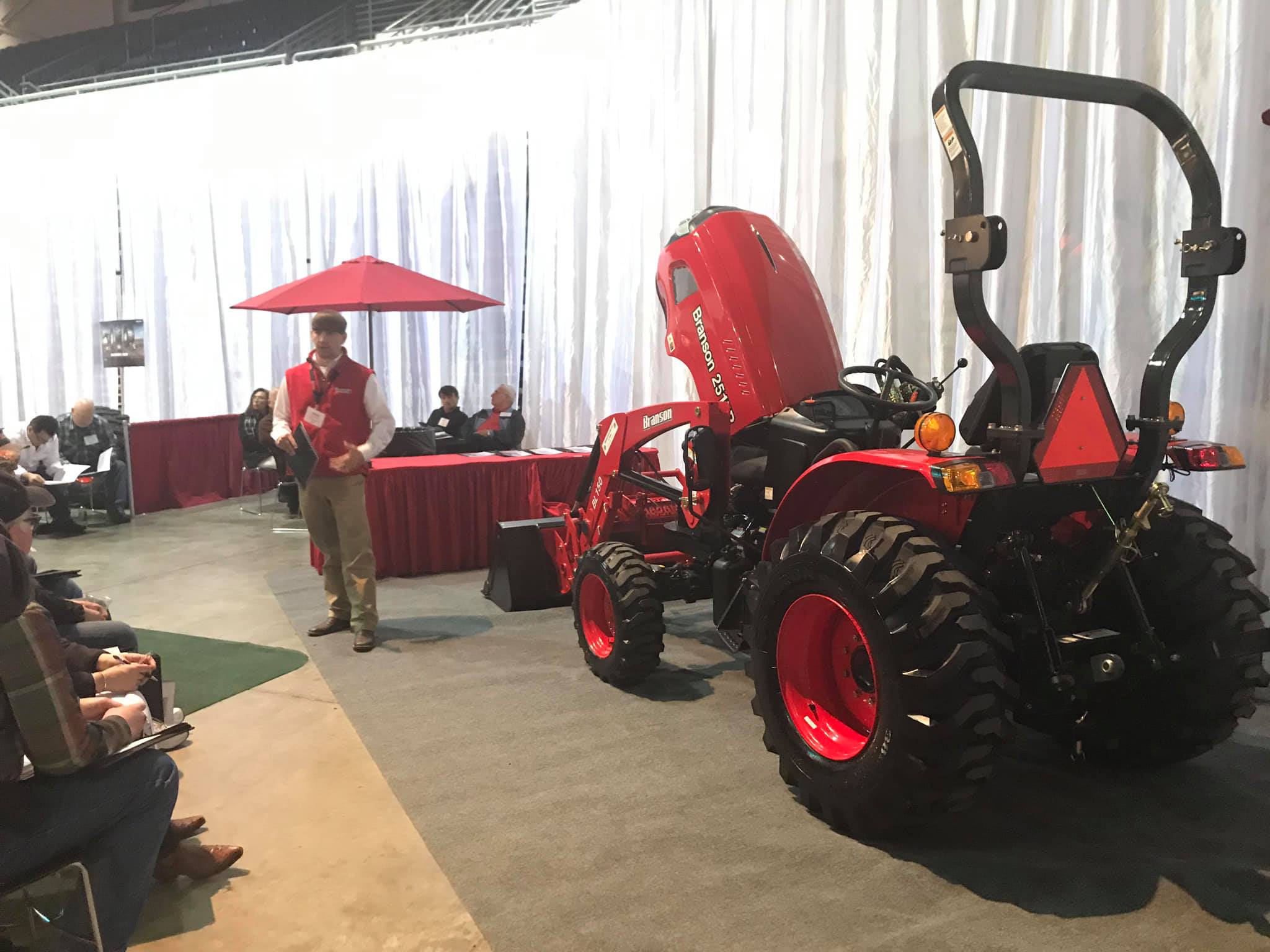

For those wondering if Branson would still build tractors after being bought by Tym. The answer is Yes. They are still building tractors and going strong!

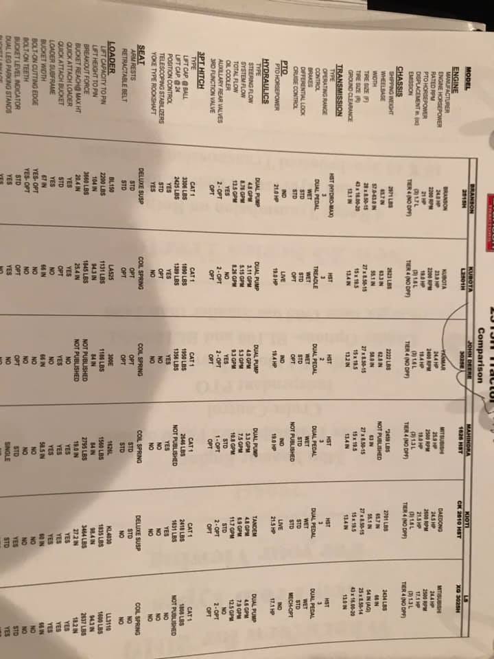

Here is the newly launched tractor. It's a Branson 2515 both shuttle and hydro. They call it a large frame compact tractor since it has the frame of the 15 series with a de-rated engine. But since it's a 24hp @2200 rpms, it won't have all the DPF shenanigans.
Being a large frame and no DPF, should be a really good seller.
Here is some pictures and the comparison chart, which is a bit hard to see.
View attachment 587498View attachment 587499View attachment 587500
Would you give us the name-www address of a dealer down there? I looked around on Google quacking duck and found nothing on the model. May not be for the US market because of emission requirements. Best I could see the chart, making 25 hp at 2200 rpm, 1.7L where my 2400 makes 24 at 1.1L at 2600 is liken to my Fords running low rpms for reducing wear and high cubes for better torque for when the going gets rough.

This tractor is actually only for the US market. I've got this info from Facebook.
The fact that it doesn't have DPF is because it's under 26HP. Which is the HP limit for the DPF requirements.
The dealer I've got this info is: Anderson Tractor Sales
They had some sort of launch meeting for this tractor.

Looks like it was the Branson Tractors' 2019 National Dealer Meeting where they shared a lot of new stuff. Including cabs for the 05 and 15 series.
