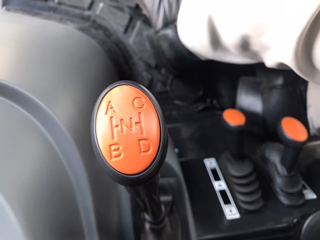

Yes it does have two PTO speeds. You can see it in this picture only a little blurry. Sorry.

Thats good to hear, I for one use the 540E as much or more then the 540.

Same here. Tilling and mowing at much lower engine RPM is awesome. Way less noise and much better fuel economy. There is a noticeable difference in fuel consumption on running at 1800 engine RPM versus anywhere above 2000 RPM.
Just for the kicks, I was tilling the orchards one of these days and decided to run 540E at 2500 engine RPM which puts the PTO at 750. I sure can till way faster but the gearboxes on the tiller were getting a bit too hot for my liking.
