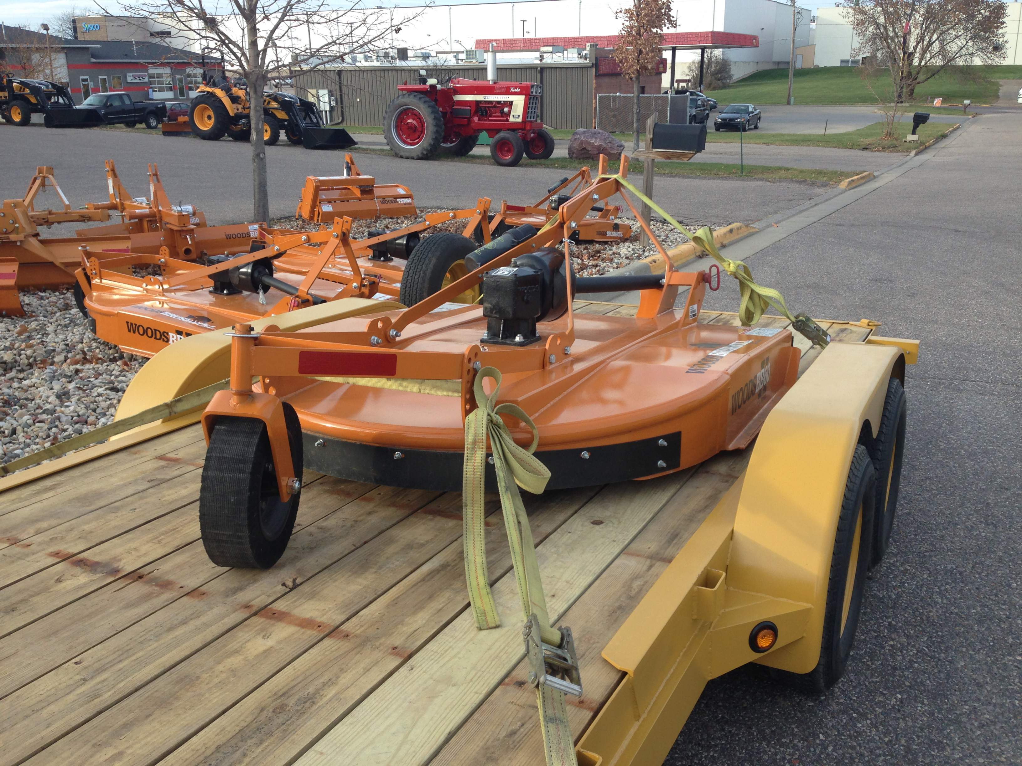

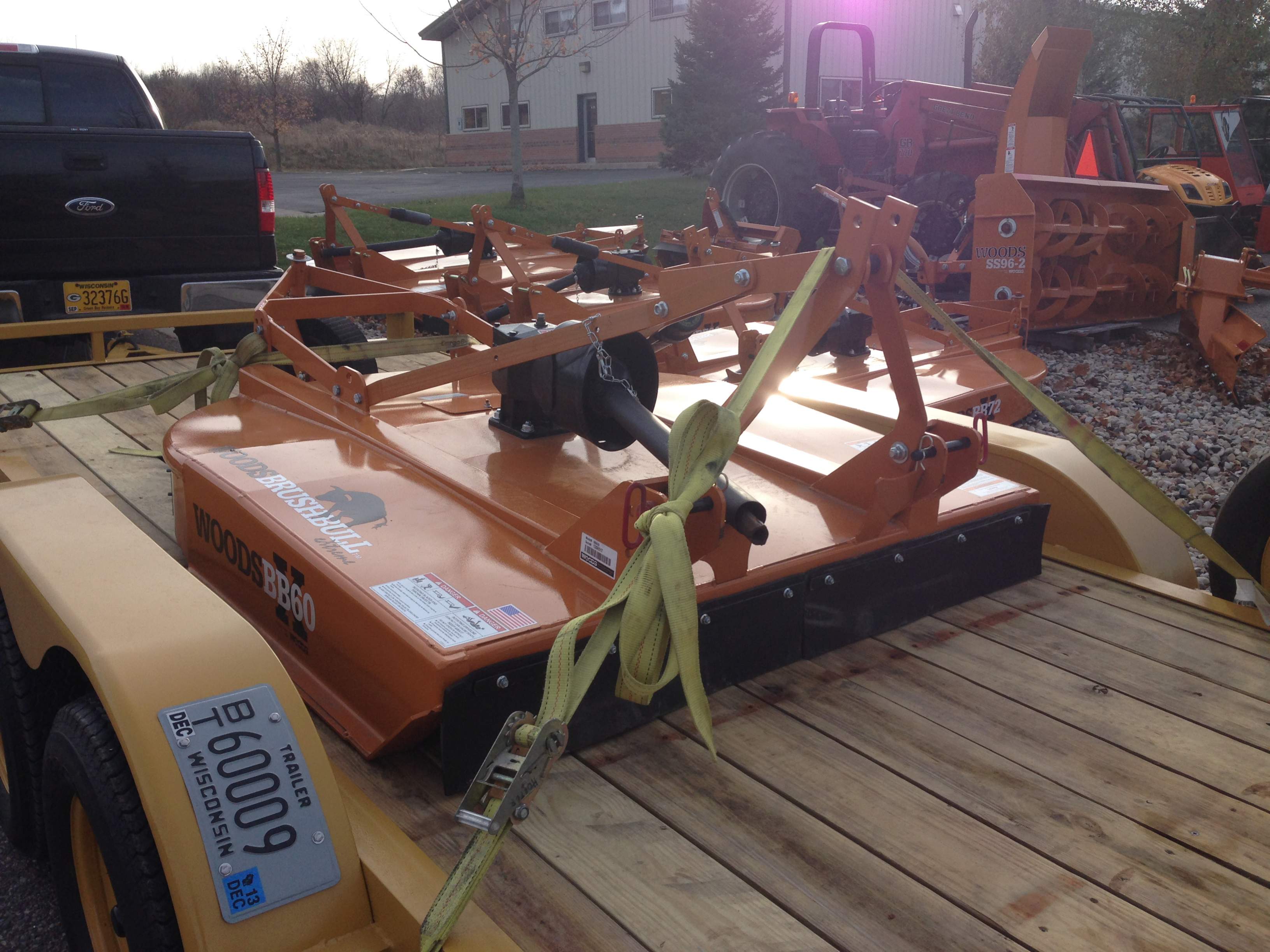

IMG_0439.jpgIMG_0438.jpgJust picked up a new Woods Brush Bull 60. I won't be using it anymore this year since the snow is ready to fly but I couldn't pass up the deal since the dealer was looking to get rid of 2013 inventory.
I won't miss my old light duty Howse flying apart all the time.

Looks like they changed the hitch mount to clevis style - very nice.
/ New Brush Bull #3
Very nice looking cutter, I am still bush hogging and actually do some in the winter when it's not too wet.
/ New Brush Bull #4
That cutter should last a lifetime. Nice.
One thing I love about the Woods Brush Bull is the large access panel in the top for changing blades. That would really make blade changes easier.
