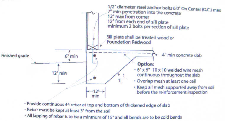

A while back I posted a few pics of a 24'x34' monolithic slab prep and pour that might be helpful. Also, a cross section diagram of the slab design. They are early on (pg. 1 or 2) in this thread:

Although my uninsulated slab works great for weekend use, if I were expecting to heat and use it daily during wintertime, I think insulating under ther slab and piping for radiant heat makes a lot of sense.

A concrete slab sure would make the rest of the construction easier (firm, fixed, level starting point), would eliminate the under-floor critter issue, and could be softened with sleepers and underlayment (she has a quilting machine that she stands at for hours at a time).
But a concrete slab would mean I would have to dig a four-foot deep trench for footers all the way around the perimiter, re-bar the edges, etc. etc. All of which is beyond my diy capability. Wouldn't the footers-foundation-slab could cost more than the rest of the building?

Are you required to dig full footers by local code? Code in my town says a building less than 1000sf can be built on a floating monolithic slab, i.e., no footers below the frost line. This construction technique is fully approved in upstate NY and I'm guessing we have more frost heave than you in WV, so I'd be surprised if you didn't have this option as well. It was significantly cheaper in both labor and material cost than digging and pouring full depth footers. I use a propane wall heater and ceiling fan in my garage/shop, works fine. Link is to the slab cross section I referenced earlier.
attachment.php
