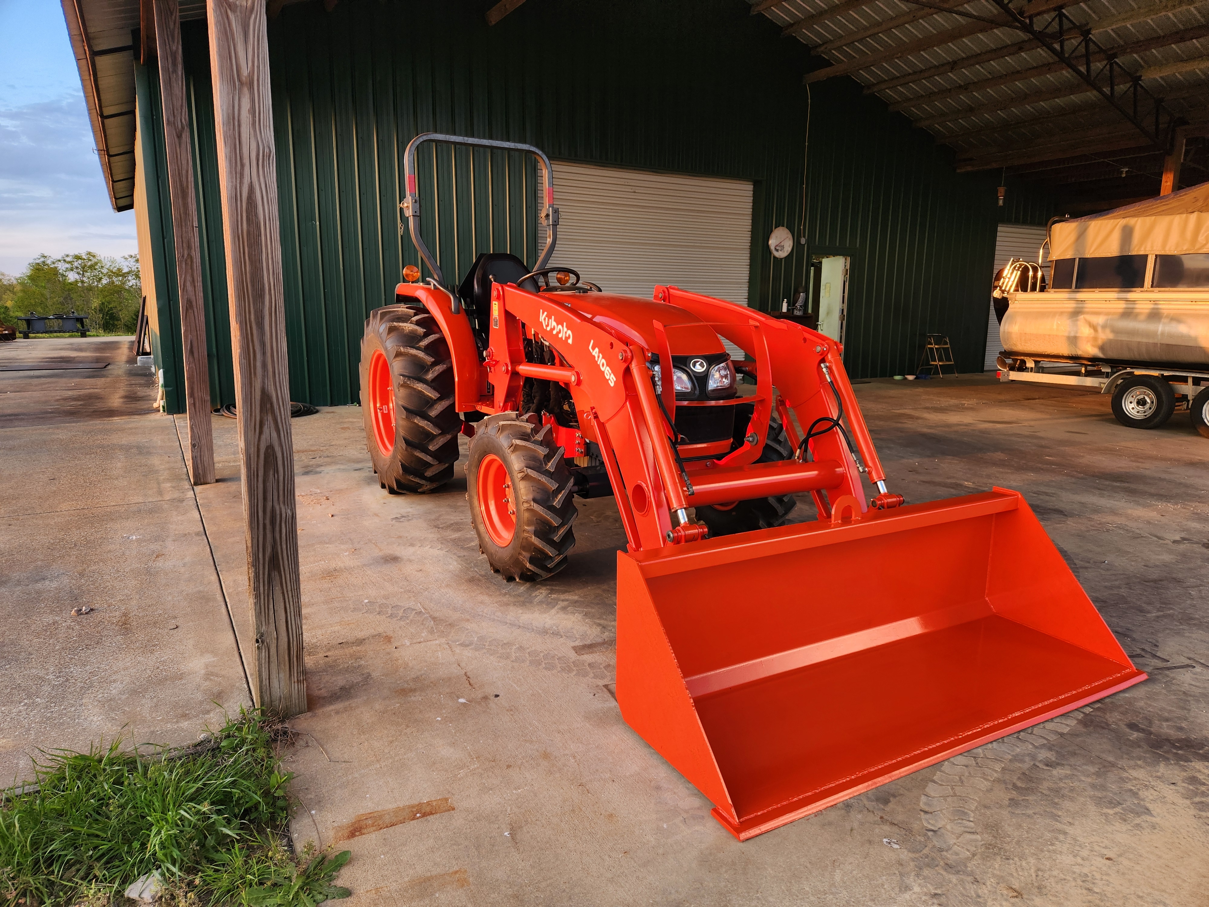

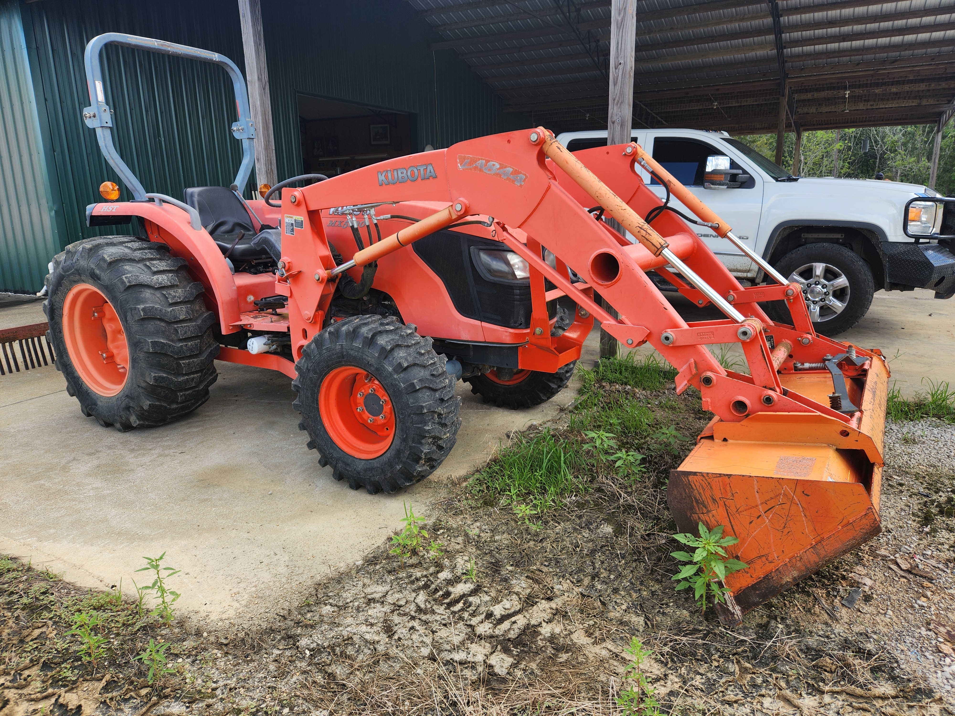

I have 3 Kubota MX5100 4x4 for sale. 50hp. Will operate a 6' bushhog. Low hour, no emissions, no computer. 1 hydrostatic Transmission. 2 with standard transmission. All 3 are Shuttle Shift, quick connect loader and bucket. Uses bobcat quick connect equipment. Located in Waynesboro Tennessee. I can deliver.
John 904-813-4740
